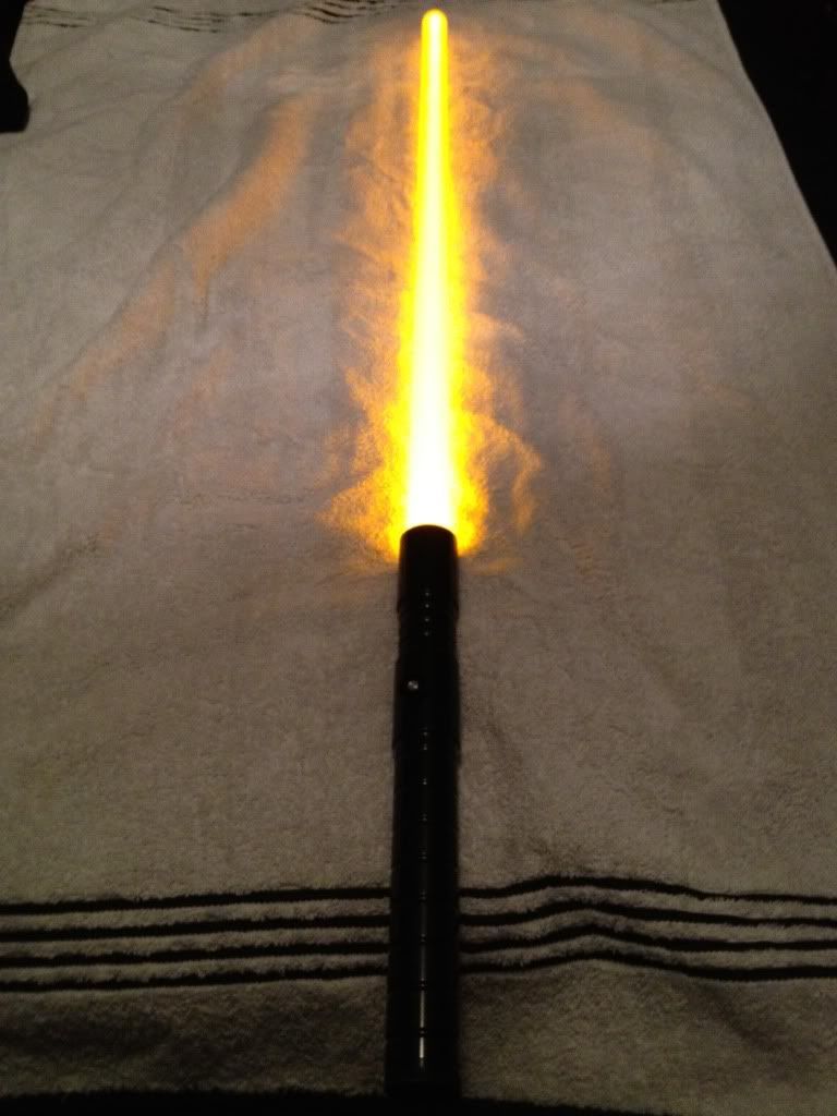

I just gave a general feel between my MR Vader and my Dominix V2 LE with a 36" midgrade blade in , the Dominix is lighter than the MR, not by alot but it is noticably lighter. The Midgrades will serve you well i think , but the heavygrades would hold up better to loads of dueling. If you get heavygrade go with ultra edge.The regular heavy grade dulls the led color a bit and has a core look, while the ultra edge brings the color to the edges of the blade.
Dominix V2 Fire Orange  with 32" heavy grade ultra edge
Dominix V2 Fire Orange with 36" regular heavy grade
