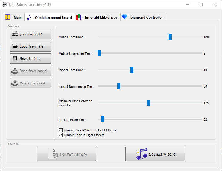

Does this work on Windows 10? Also does this work if my Saber doesn't have diamond or emerald?
You can still use it (and will need it) to upload new sound fonts and change sound fonts if you have Premium Sound on your saber (single bank on Obsidian V3 or 7 banks on V4) even if you don't have an Emerald or Diamond board. You'll still have a mini USB port on the Obsidian sound board to connect your computer to for this software.
Below is a screenshot of the software with the Obsidian sound board tab selected:
