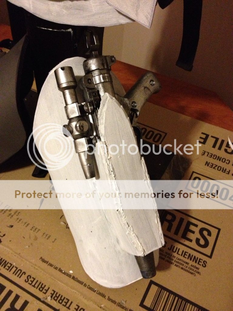

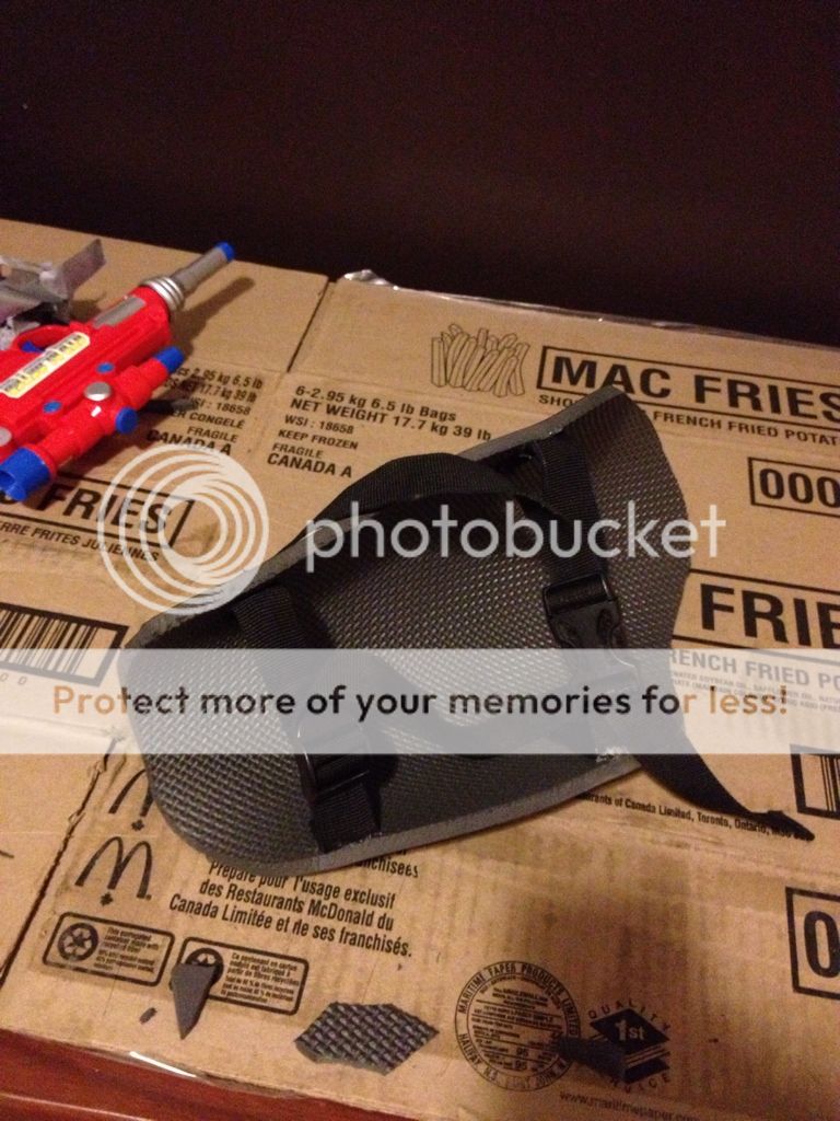

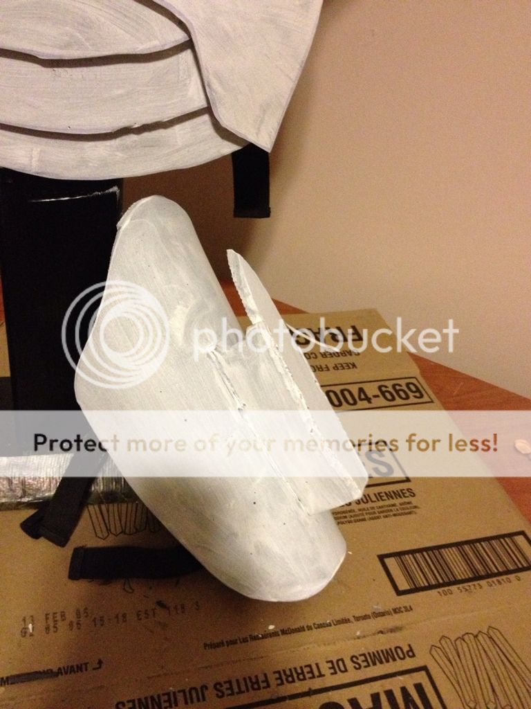

« Reply #6 on: September 25, 2012, 12:49:18 AM »
End of day update:
Finished molding the thigh plates and attached the gun holster to the left leg. Left leg is primed.
