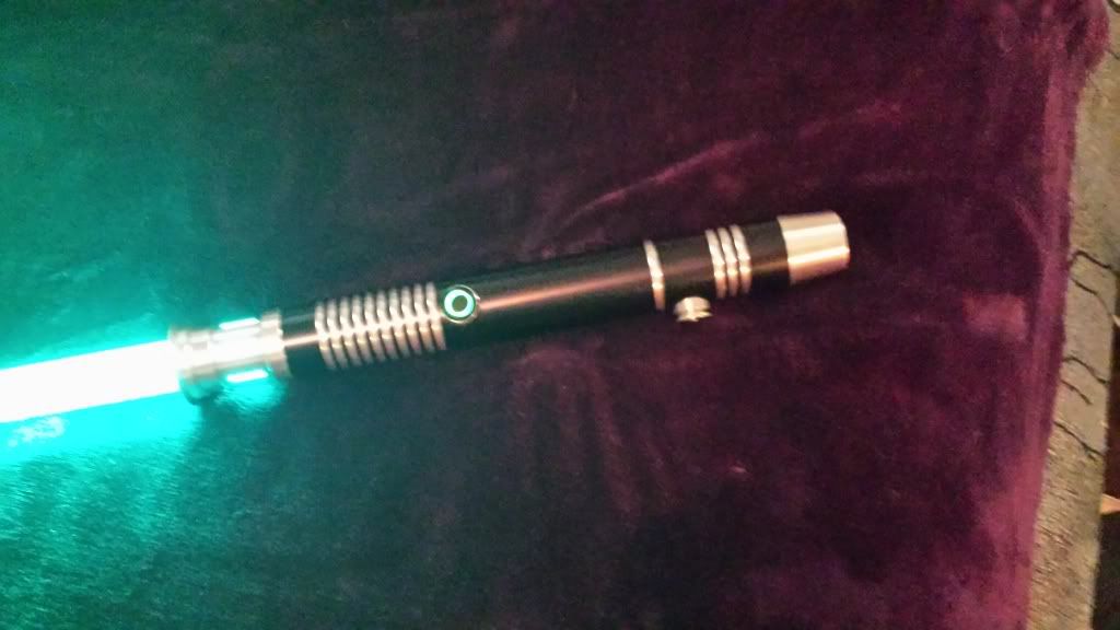

« on: October 01, 2013, 09:20:37 PM »
I took the Obsidian out of this saber for my custom Dark Obi_Wan. I decided to make this saber a stunt. This led has a min fwd voltage of 5.45 so a 4 AAA pack is too close at 6 volts. I went with Li-Ion. The list of electronics I used.
- Lux V Cyan Bin 3 led
- black anodized green illuminated AV latching switch
- 700ma Buck Puck (optimum for this led)
- 220 ohm 1/4 watt resistor for the AV Switch
- 2ea. 14500 Trust Fire LI-ION cells
- 2 AA batt pack
This saber is Very bright!
dark side points please

Thanks all. This hilt has its permanent MLS and Buck Puck in it. I will be adding sound later. It looks great and as with all Overlords, it handles well!

And thanks for the detailed parts list. This sort of information really helps people like myself who are still learning about electronics.
Point of a great build and great information.
