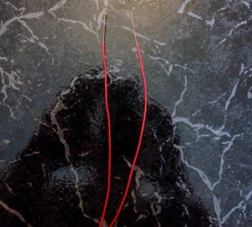

Start by using the wire tool to strip off about an inch of the wire:
Set the 2 wires side by side - not across from each other:

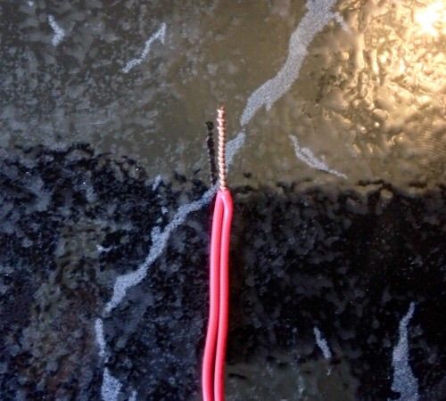

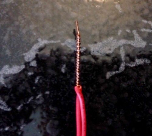

Twist the pair together as tightly as possible:
Snip off the top of the twisted pair, leaving the tightest area of the wire twist. Take off just enough so it can be easily wrapped with the tape:

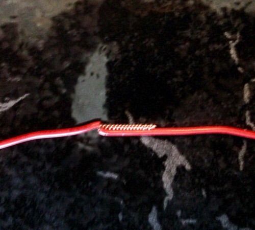

Now - pull the wires across from each other, leaving the exposed twist parallel to one of the 2 wires exactly as you see in the picture; this the key to it's strength.

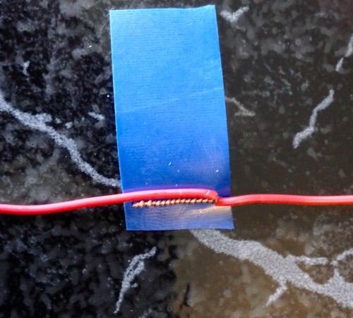

Tape the exposed twist to the wires as tightly as possible:

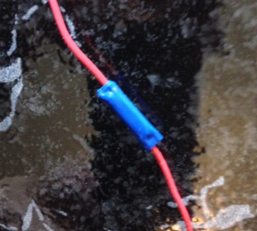

Use the wire tool to crimp both ends of the tape to create a tight seal around the exposed area:
And . . .
It's that easy!
