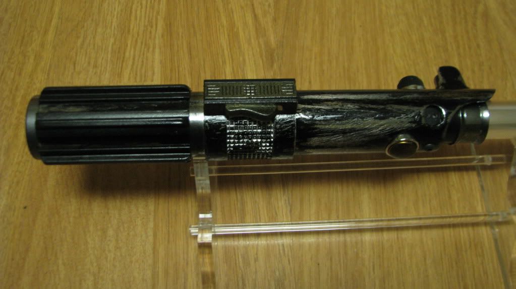

For Aluminum based hilts:
Spray paint it with black paint
Use sandpaper and scratch off until you get the desired effect
Spray a few coats of epoxy clear coat on it. or regualr clear coat. If you have an empty hilt, you can bake it in an old toaster oven and cure the clear coat even better (2 hrs at 250 degrees works great)
Here's an MR Ani I did into a Mustafar Ani (Mustafar series was created by Lord Dottore Matto (LDM)/GENERAL GRIEVOUS of FX-Sabers. This was an homage to his famous series

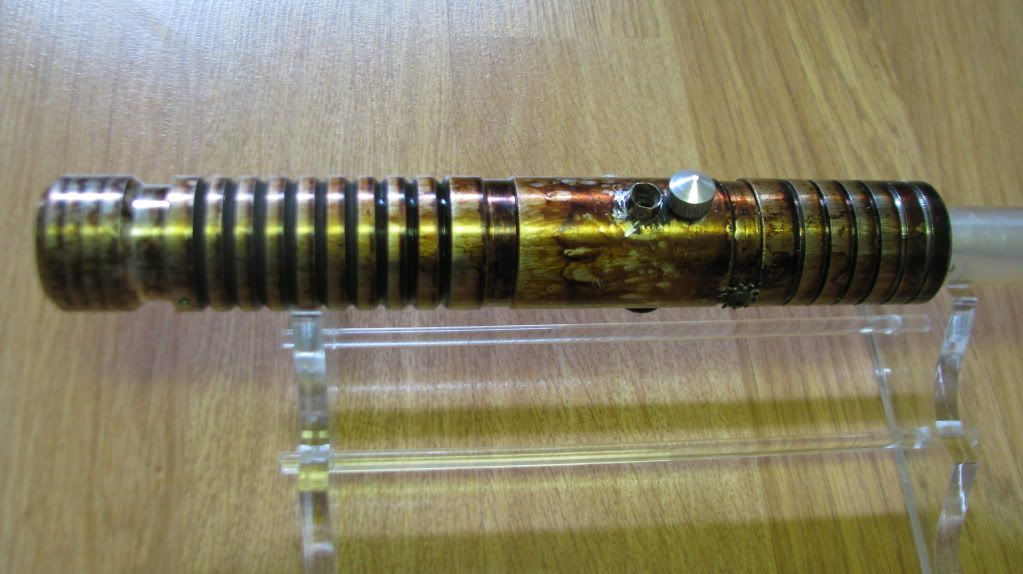

Olive Oil method: (NOT MY METHOD...I don't get any credit for this)
Scratch up the hilt
Rub a coat or two of olive oil on all over the parts you want to weather
Bake a 550 degrees for 3 hours
Take it out and toss it in cold water to "shock" it
Spray with clear coat and bake it at 250 degrees for 2 hours
Here is one I did recently
LINK
