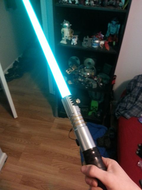

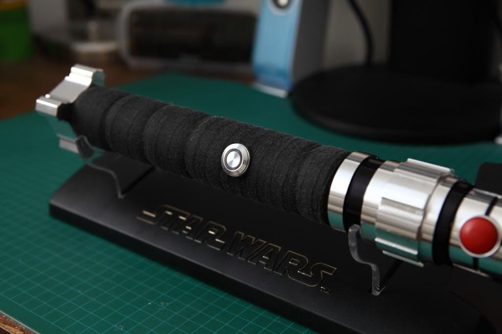

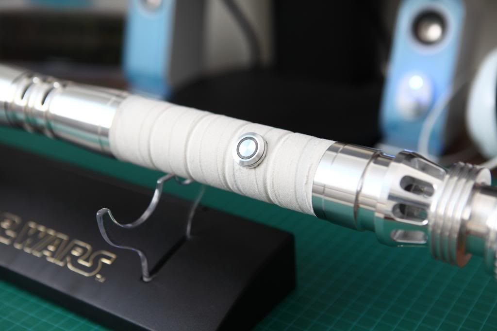

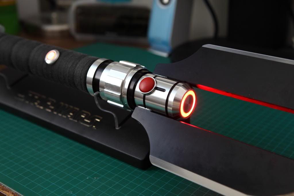

I'm not at home right now, otherwise you'd get a close up of the emitter, but a transistor heat sink from radio shack, a thumb screw, and a brass decorative washer adds some pizzazz to an aeon v2 emitter. The bottom of the hilt is just tennis racket grip tape, nothing that hasn't been mentioned a million times before.
« Last Edit: February 11, 2014, 05:54:53 AM by GilNarmor » Logged
