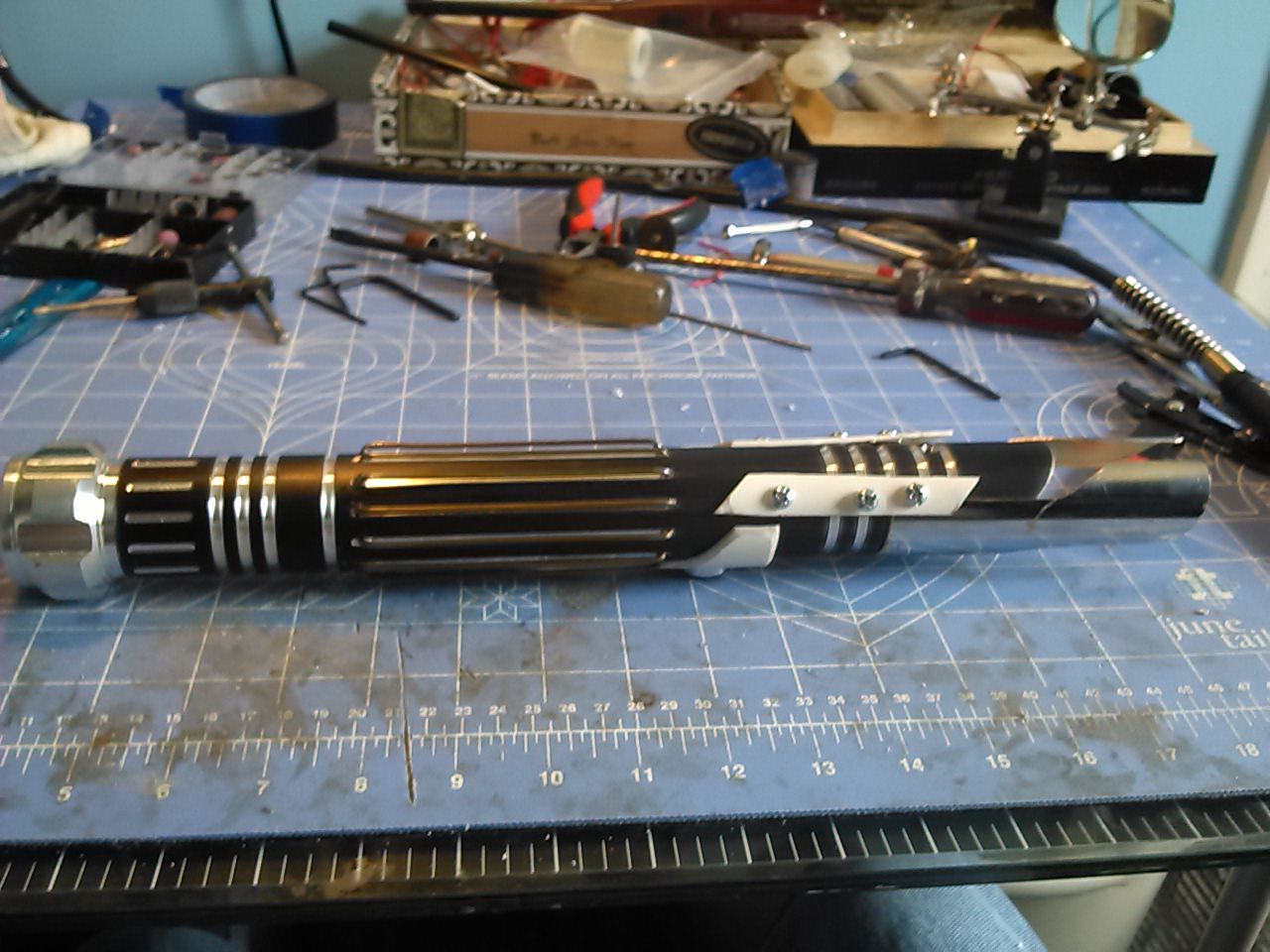

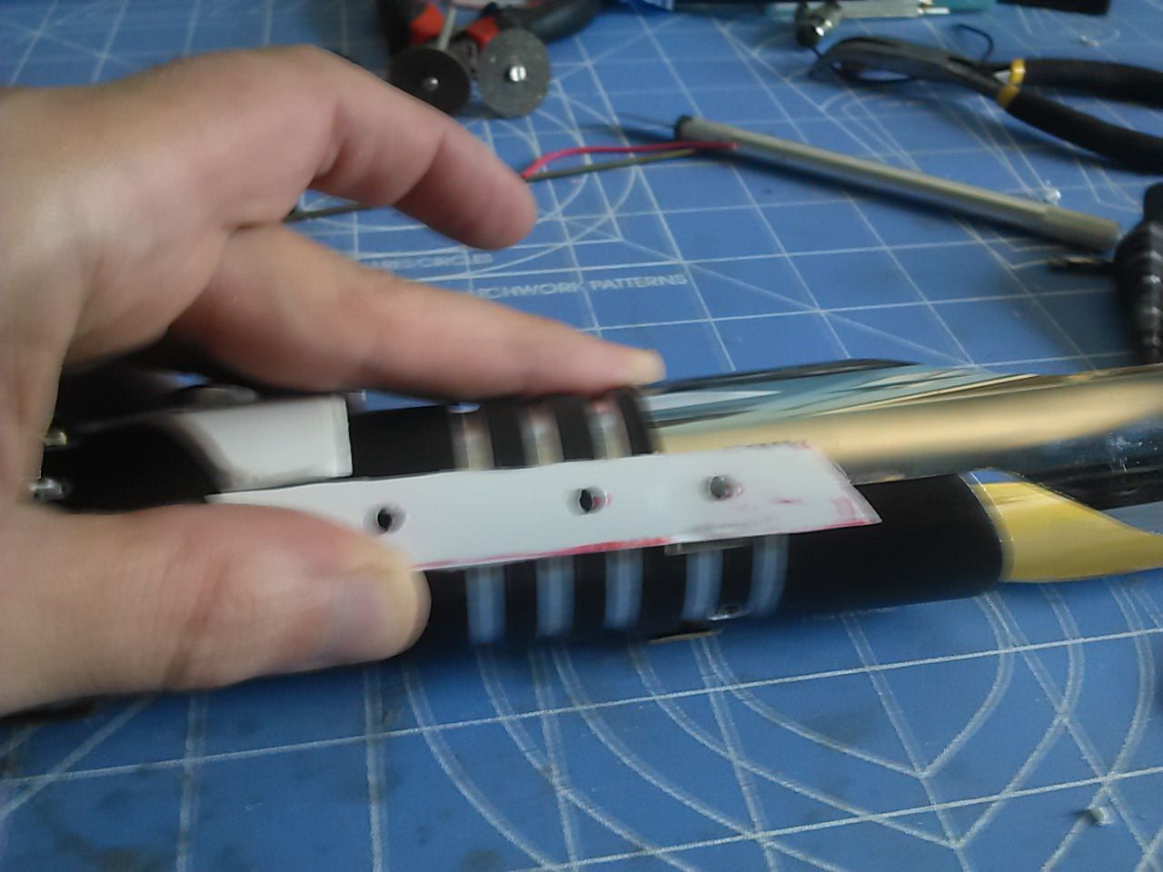

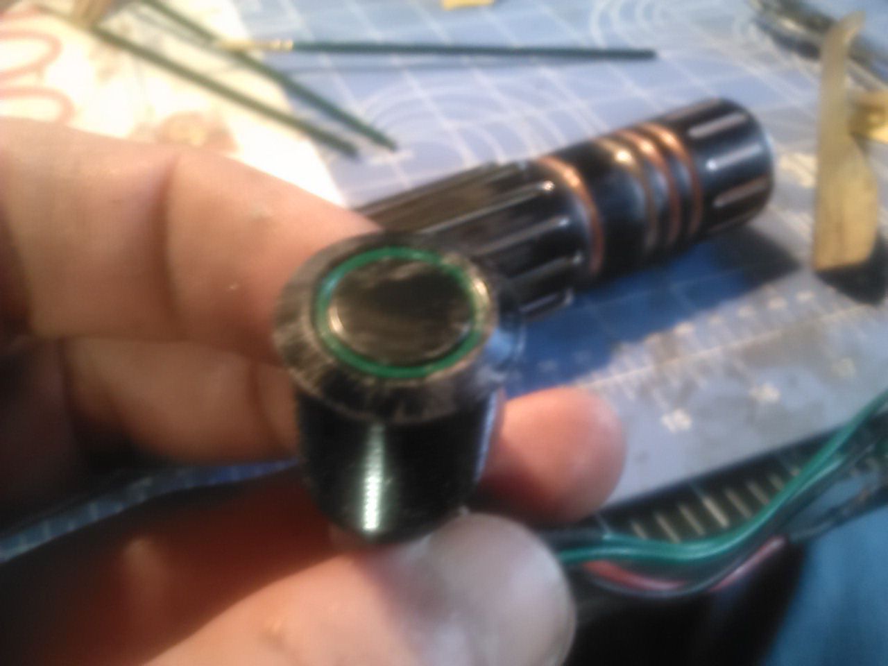

Ok here we go I've got a few peices done well sorta.
This is a pvc switch plate I fitted with the av latching switch.
I haven't decided what direction to place the shroud

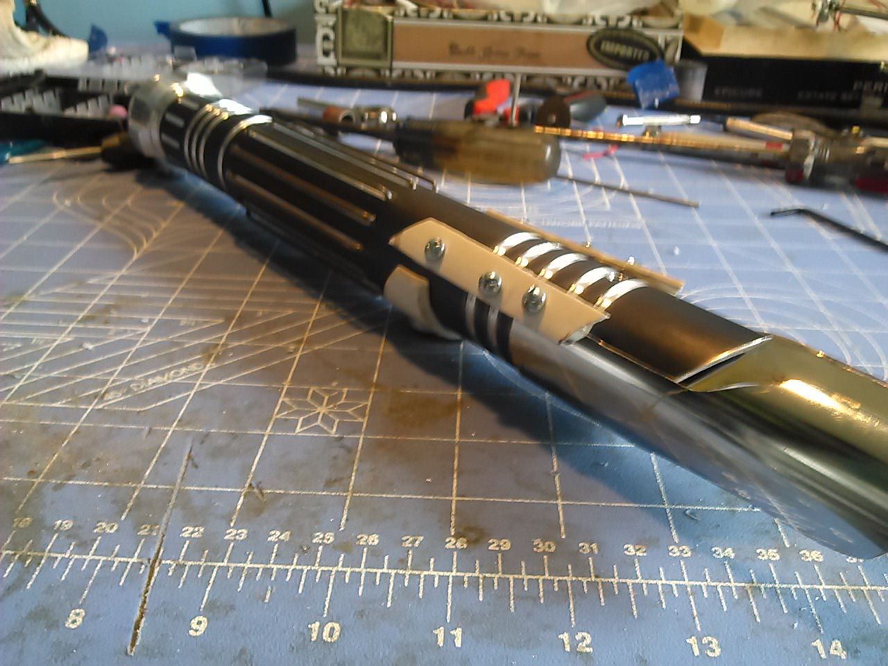

A little more done on The Infiltrator the drilling and tapping of all the holes. Then test fitting of all the parts. So far so good, although I'm gona have to trim down some of the shroud just to even it up a little .
I haven't decided on what color to paint the pvc parts yet and I'm gona try to find some brass 1/8" button head screws.

Well I finished the shroud and I think I'm sattisfided.
I left it kinda rough cuz I want this thing to look like its been threw hell and back

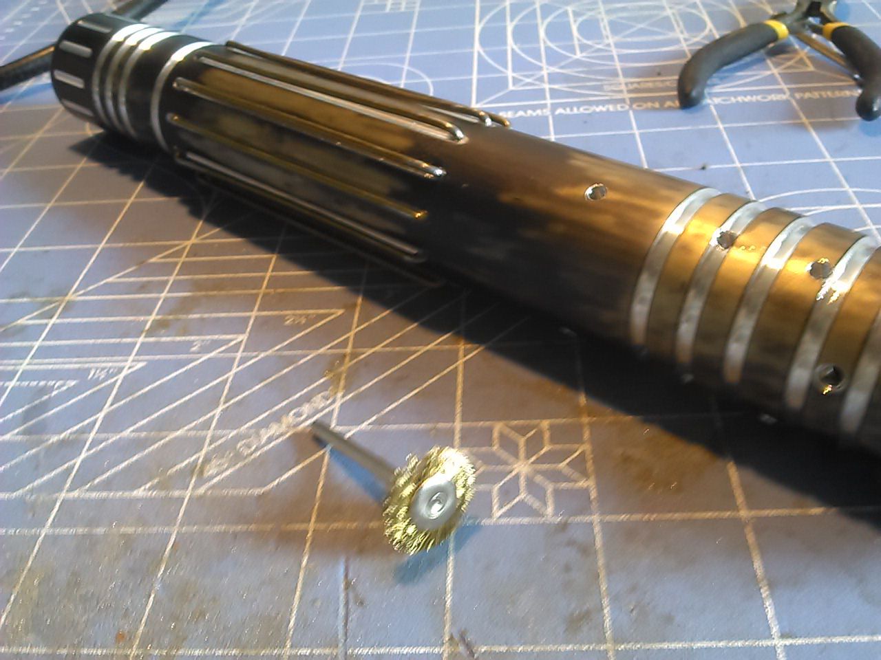

Speaking of witch I found an interesting way to do some uniuqe weathering. Using a brass wire wheel on my dremel instead of taking off the anodizing it  added the brass powder to the hilt.
And I think I'm gona go with a bronze for my acent pvc peices.

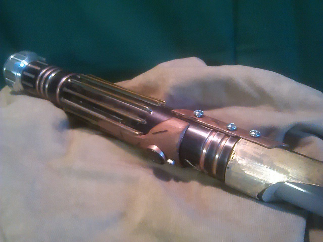

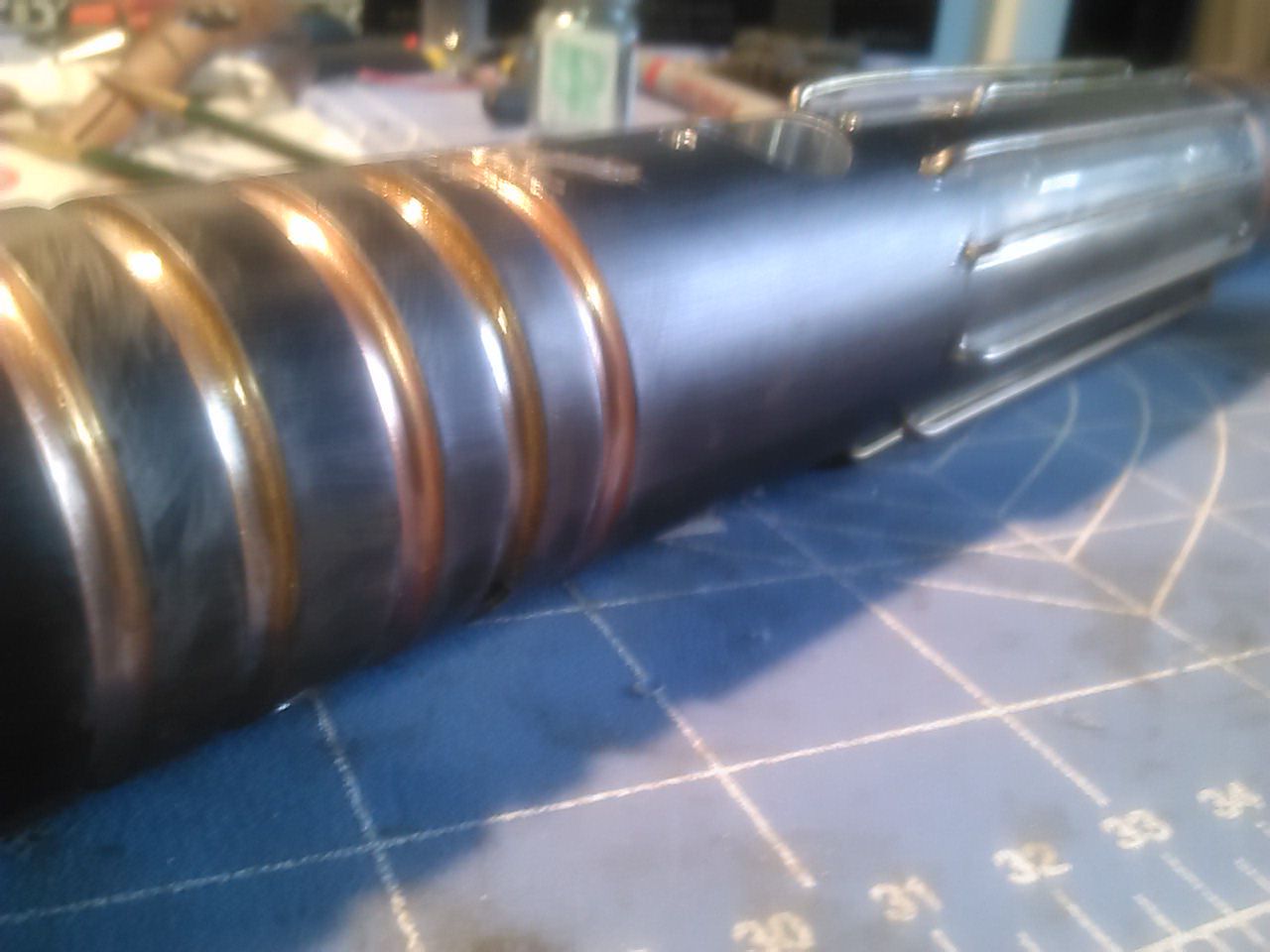

« Reply #28 on: May 24, 2014, 12:11:10 AM »
After 4 coats of base color and wet sanding in between each then another 4 layers aging and weathering the acent peices are ready for the clear coat. Here they are. The pics don't do justice to how they actually look.
[/URL[URL=http://s875.photobucket.com/user/christophermcleroy82/media/IMG_20140523_195118_zpsce07ca97.jpg.html]
Yes I even dry brushed the switch and bezel.

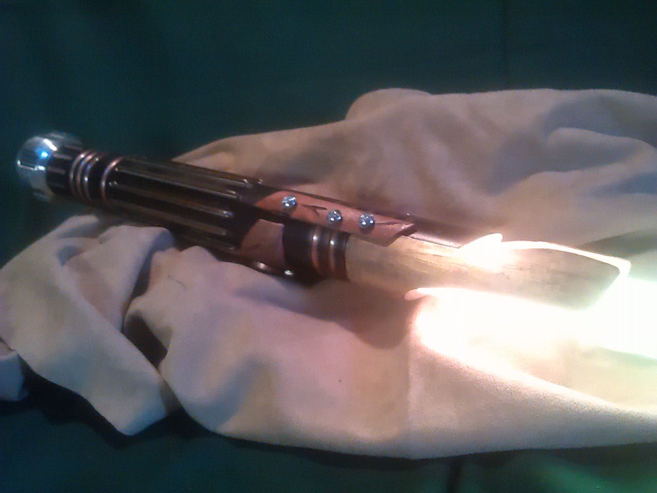

« Reply #29 on: May 29, 2014, 04:37:34 PM »
Here she is 98% complete I still need to track down some brass button head screws and order a anther pomel
