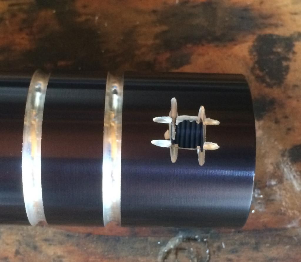

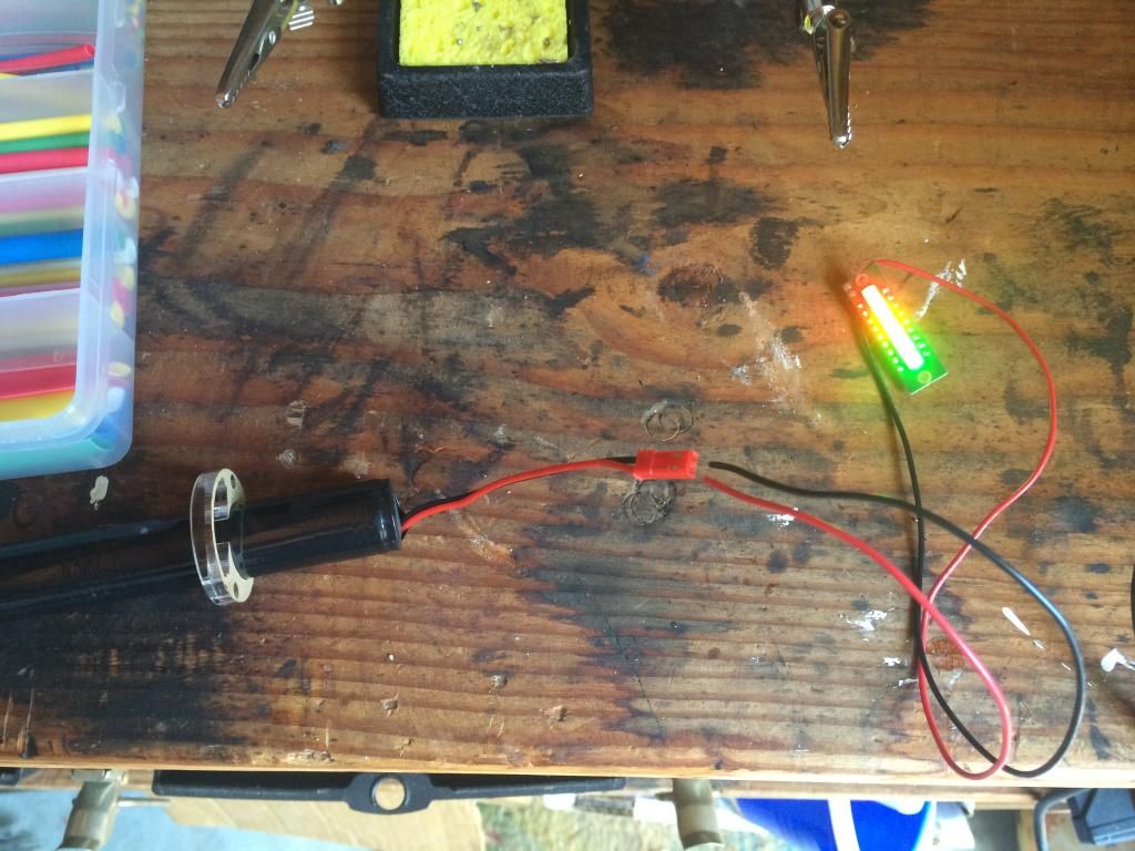

« Reply #22 on: June 08, 2014, 10:23:44 PM »
Ok - first pics of some early soldering prep work.  I'm gonna be waiting for my saber hilt for a while (which I am buying), but everything else inside is going to be UltraSabers.
First pic is a test wire of the Power Level Indicator (PLI) . . . like I said in earlier post TCSS has a new model now and considerably easier to wire up . . . doesn't require any custom resistors . . . they must be using a dynamic resistor inside now . . . only thing I had to do was bridge some pads on the right side to configure it for a 7.4V battery pack -- and then wire in the Pos / Neg on the left side.
Then I toyed around with my grab bag Dominix hilt that I use to experiment on before doing anything to a hilt I want to build out . . . tried cutting a square hole with a round bit for an access to the emerald driver micro USB . . . as you can see it ended up with a clichéd outcome . . . not happy with that -- so I think I will simply drill a clean hole with my drill press large enough to accommodate a micro USB cable.  I can use a dremmel to square it out if I need to with a cutting bit.
The full idea is to create a small rectangular panel that will slide up and down on one or two screws (which can be tighted down to prevent accidental slippage to cover the access port.  this way I will never need to unscrew the pommel and fiddle with trying to get the electronics to drop out - and then worry about stuffing back in.  I am either going to go with a cut out from a chrome sink tube . . . OR . . . go with this copper tubing.  It's 1.5 '' diameter so it should match the curve of the hilt . . . I will dremmel out a section just large enough to cover the access hole . . . and then I think I might try acid etching a design into the outer section . . . maybe some circuitry design (see photos below)  Does this sound workable?  Anybody else have any experience with what I'm thinking?
