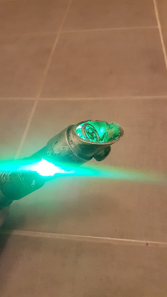

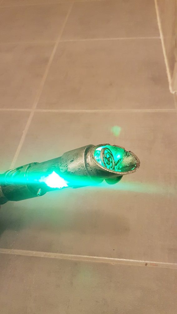

Finished my plug
Finished my CT wheel

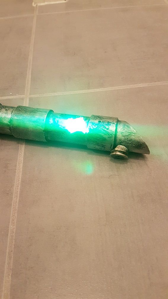

Then I got bored watching the 80th coat on my Catalyst dry. So I did a test wire to make sure it was all good and make sure my blade plug worked alright.
Still need to wire it up properly when my connectors arrive, and install the switch. The switch will probably be a weekend job because I'll need two people as it's so darned fiddly. But for now here's a couple of shots of it lit up.

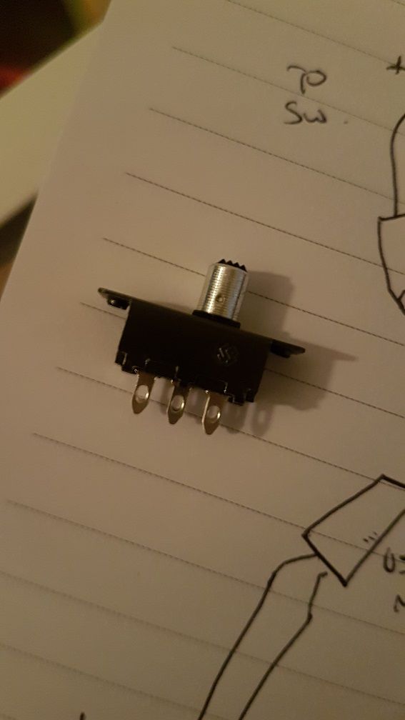

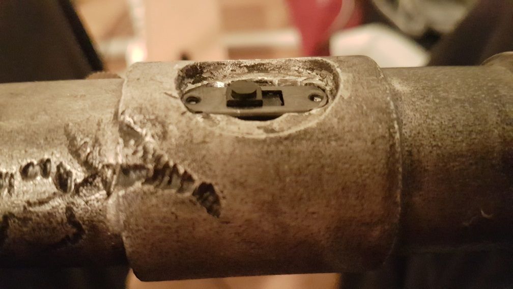

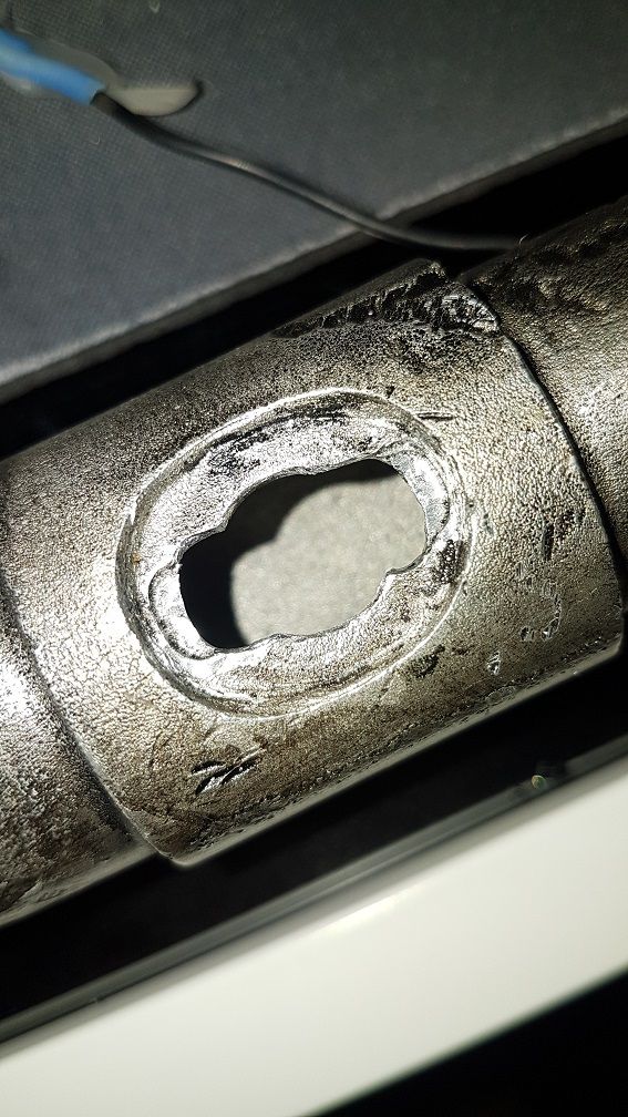

So I broke out the dremel again and notched out the switch hole so I could slide the switch in from the top instead of having to try and glue it from inside like the AV switches. Then I notched a ledge out so the switch would sit flush with the inner material in the switch hole (the part US normally drill out to make it a 16mm hole for the AV switches) This gave it a nice firm surface to press into as well which felt much better for a sliding switch than just glued to the inside of the hilt with nothing but glue and air under it.
You can see the switch here unmodified

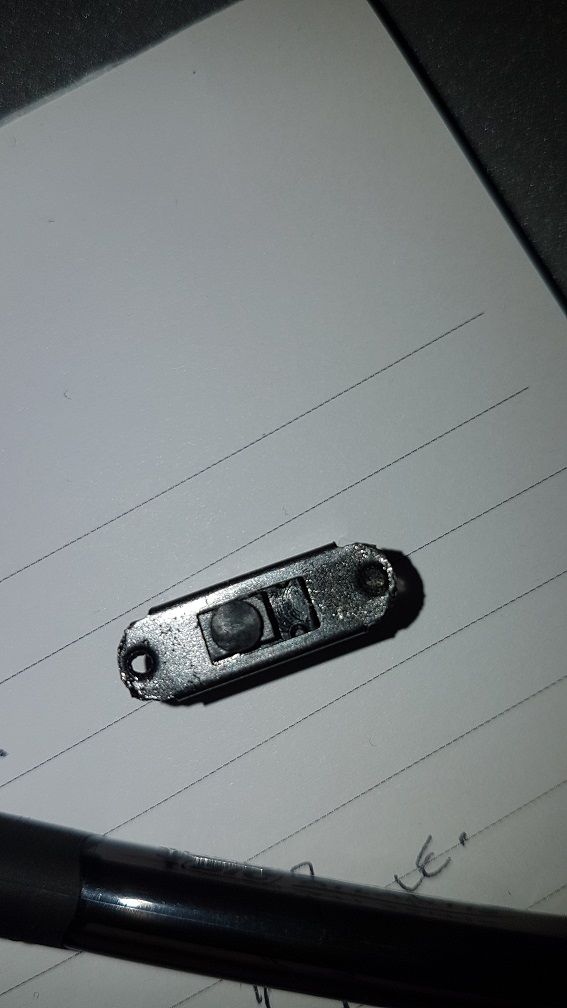

and you may notice I cut the stalk down (that was so the cover was sitting on the hilt instead of in the sky), and reshaped the mounting ears so it would fit in the channel that I cut out in the switch hole

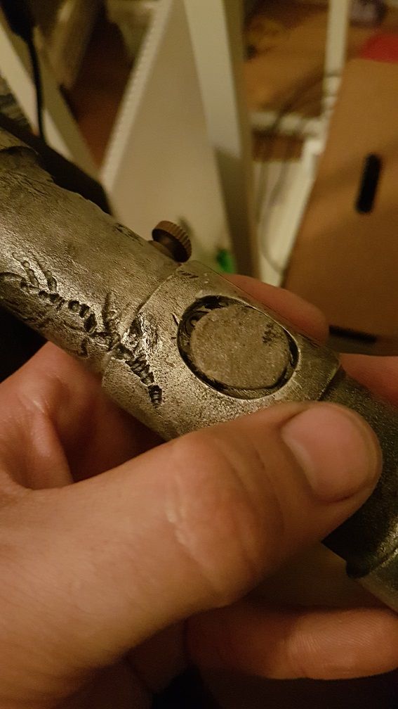

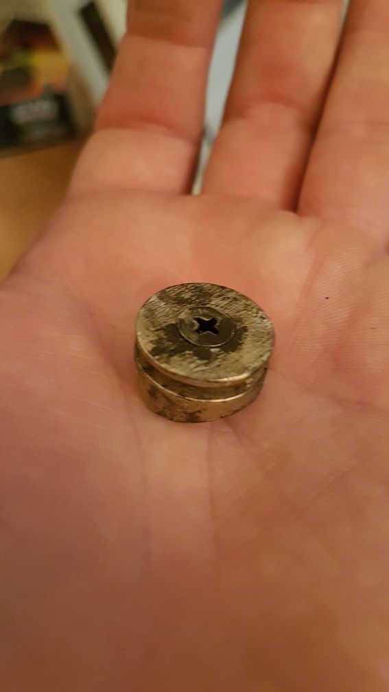

Then I attached my switch cover/plate/whatever you want to call it to the top of the stalk
Ahhh, I see now Smiley, very cool!  Very cool idea with the switch, that's gonna be really nice!  Really unique, will probably have a really smooth operation too if you know what I mean.  That will feel good to activate.
Coming along awesome!

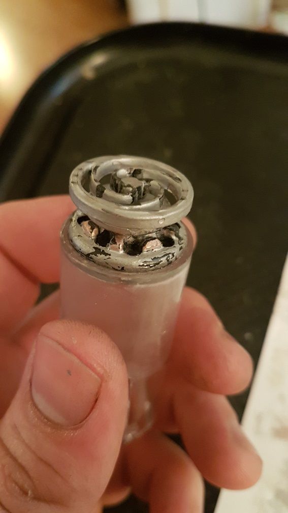

Unique was the key to this build. I wanted to reuse as little of the original look as possible, hence my carnage and relocation on the covertech wheel and brass thumb screw.

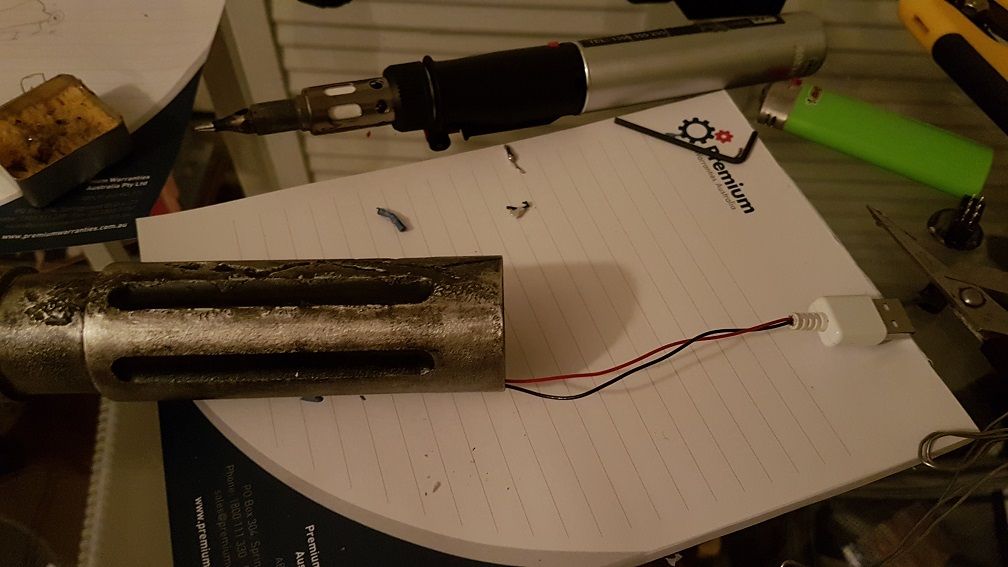

It's a USB power pack that fits inside the hilt almost perfectly. It's a bit on the snug side, but will be worth it. The same guy at work who had the idea of the clear wire also said it would have been cool if it could just sit on display and have the crystal lit, without having to change the batteries all the time. When I saw this I realized it would be perfect to power the saber because with this next picture, you'll see why I can't use the standard battery pack any more.
This is just a test fit for length. I cut down a usb cable, removed the data wires and will wire the pos and neg wires up to one side of my switch and my led respectively.
The usb plug will go into the power pack to power the led when the saber is out and about. And when it is on display, the pommel will be removed, power pack taken out, and the saber will be on a stand that I am going to make that will pretty much just be a female usb connecter mounted in something that the saber can sit on without falling over.

Dude, that crystal shining through the side is awesome.  Though, everything about this project is.  I really like how you mounted that switch, great idea.  Smiley
I love how it looks like it's powered by Kryptonite  Cool
