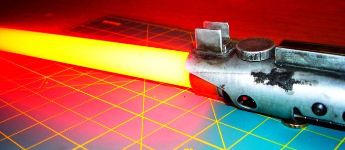

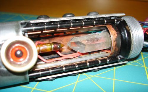

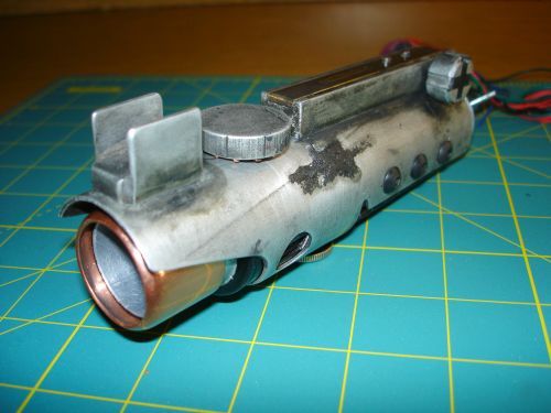

 Here is the front section getting ready for a bit more aging & a satin clear coat (misplaced my graflex pins, darnit!) , now it's on to wiring in a cple of small leds in the bottom chassis disc for chamber lighting,accent fiber optic lines(those are the white rods you see on either side of the crystal & waiting for my soundboard (Naigon came out with ver.2 & is up-grading mine)
Still have to mill down the brass handgrips & quite a bit more assembly/fabrication

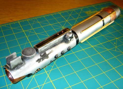

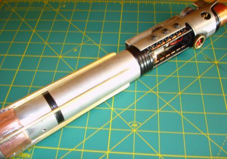

Here is the completed rear section, before aging, I just finished sizing the brass hand-grips from 1/4 x 1/4 brass billet & then fitted each piece into it's own groove in the copper rear section, ( the solder is a bit sloppy & I'll sand that a bit before aging the pieces with antique patina solution, from there a bit of steel wool , some birch-wood casey aluminum black (it sticks & works very well with acid dipped aluminum)
I've seen aluminum used for hand-grips & also brass pieces screwed in place , I chose the more difficult method  Smiley

LED testing, there is only one + for the led & 3 negatives, the tru color board fires whichever LEDs is needed for color mix & FOC

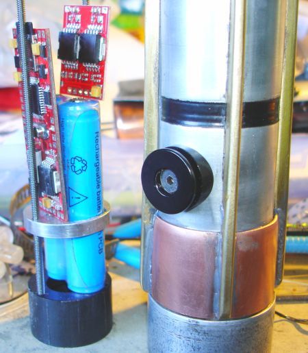

 Thanks guys! I'm just getting into building and spacing the rail system. Originally I thought I could cram 2 18650's into the hilt (without a crystal chamber they would fit, so I compromised a bit & am using 2 14650 Li-ion's rated at 3.7 volts & 1600Ma . I'm also making a couple of discs out of some nylon stock I have on hand
Looks like it'll fit! & I'm staring to finally get low on parts set aside for this project  Grin
