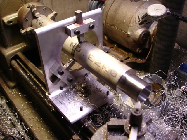

 Here is a project that has been in my head for a long time, and now it's time to make it real (I already have prints drawn and most parts on hand) I have been wanting to be able to lathe my own hilt from billet for awhile now. After research I found one thing really needed beyond a lathe, a mill and a band-saw, is a good center rest. They made these for my ancient Craftsman lathe and now are extremely hard to find.
I thought MMmm not about to spend  250+ I'm sure I can build something that will work near as well! I ordered up a set of center rest fingers with sealed ball bearings, a piece of 3" x 5" x 1/4" L-bracket, had a couple of pieces 1/2" billet I use to make control boxes on hand.
This is a piece of 1-1/2" x 12" stock, I turned down the front section for the emmiter and tsuba mount. With this set-up I was able to achieve .003 tolerance across the piece checked with the dial indicator, the wall thickness near the blade opening is all of .05

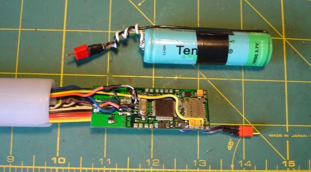

« Reply #9 on: April 15, 2013, 09:07:58 PM »
and the sound board wired and ready for install, this is a neat little gem that is quite rare and does some amazing effects
I used micro plugs on the battery, speaker connection, and the 4 wire main RGB led's for ease of later up-grades
