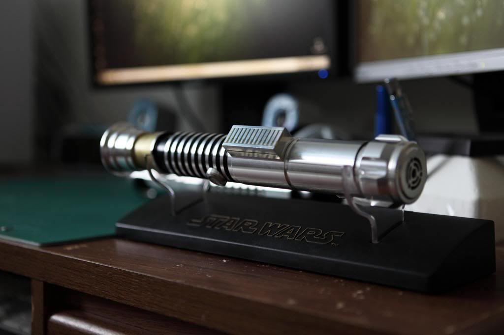

Greetings Everyone!

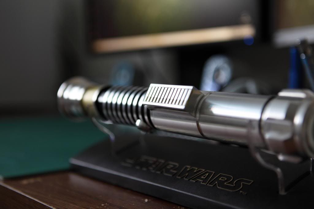

This my take on my latest modification on my Archon. I did 2 modifications on my Archon first mod was the hilt's neck i painted gold.
The Process on painting is simple what I did was, I cleaned the surface with isopropyl rubbing alcohol with a paper towel removing grime hand oils. Then I used masking tape to mask where I don't want the paint to stick. Masking tape was the hard part because when I masked the middle of the silver ring of the neck you need to be perfect on the edges. I also masked off the top portion on the top where the threads are and bottom leaving just the top half only exposed to paint. No need to sand or use a primer for the surface. I wore latex gloves while holding the part when applying the paint. I applied 3 light coats of the paint every layer I waited about 1 minute for the paint to adhere. If it does not look fully gold add 1 or 2 more light coats. After painted I waited about 1-2 minutes to remove the masking tape carefully not touching the paint. Then you can leave neck for drying at least 6 hours or leave it overnight. The paint I used was Dupli-Color Gold Automotive paint.
Second process is the activation box. I decided to mount the box opposite from the Covertec wheel other side of the hilt, so when I Cosplay a Jedi the Activation box shows from the outside. First I marked the holes that need to be drilled. I center punch the markers and drilled the holes. I used a thread tap to make the threads for the screws, mounted the box screwed tight. The circuit board was super glued on the box cover.
There you have it my new Archon v 2.3

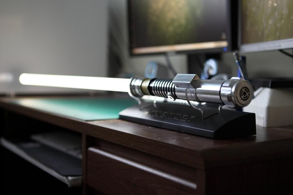

Holding and gripping on the hilt is very sturdy and I can still twirl the saber around. Also holding 2 handed works very well. I don't think the activation box will get in the way any time soon =)
