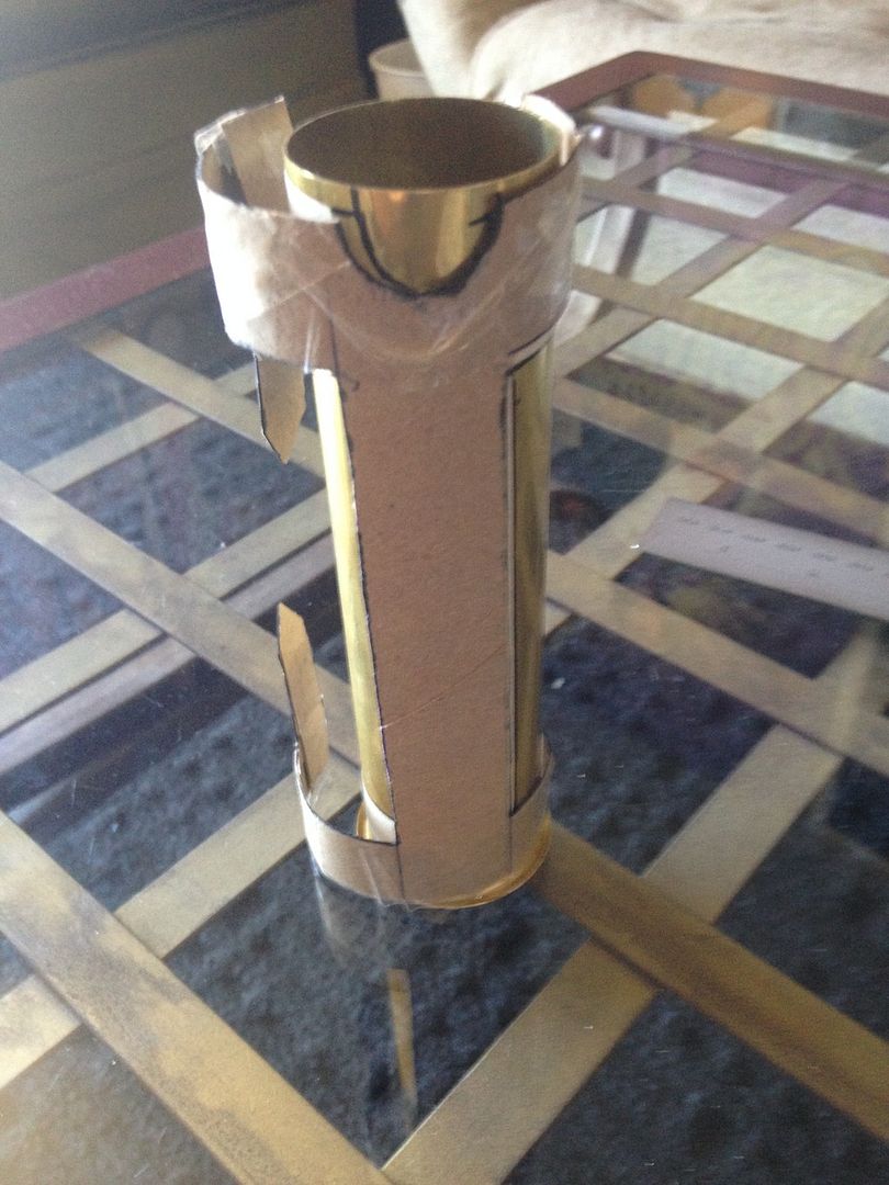

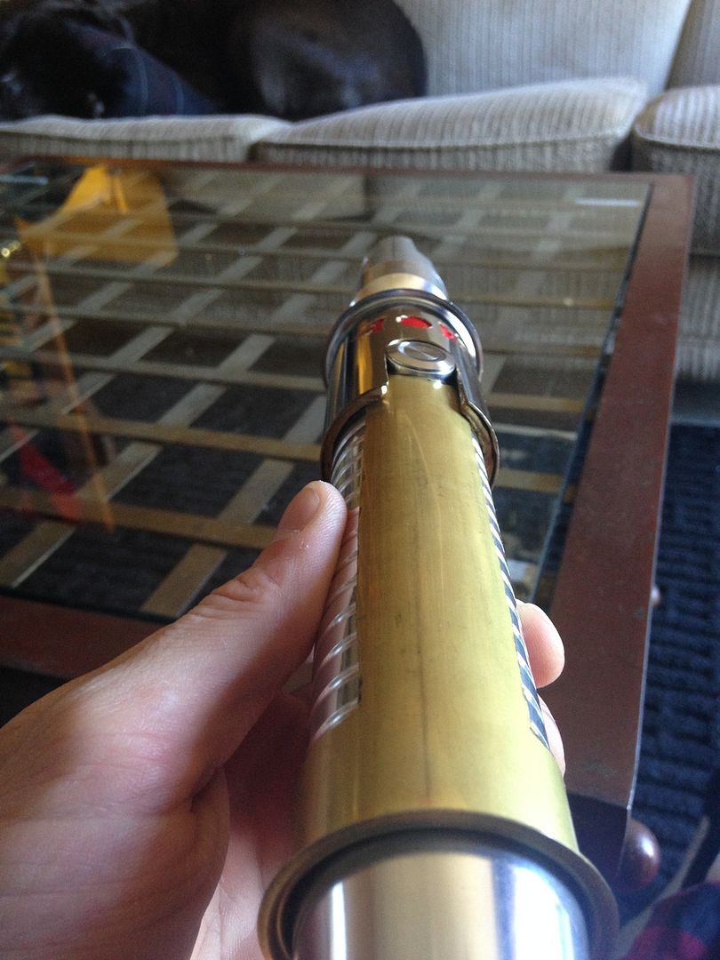

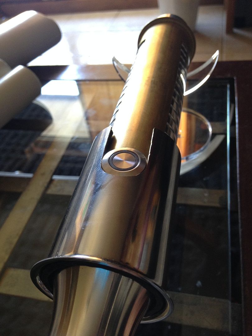

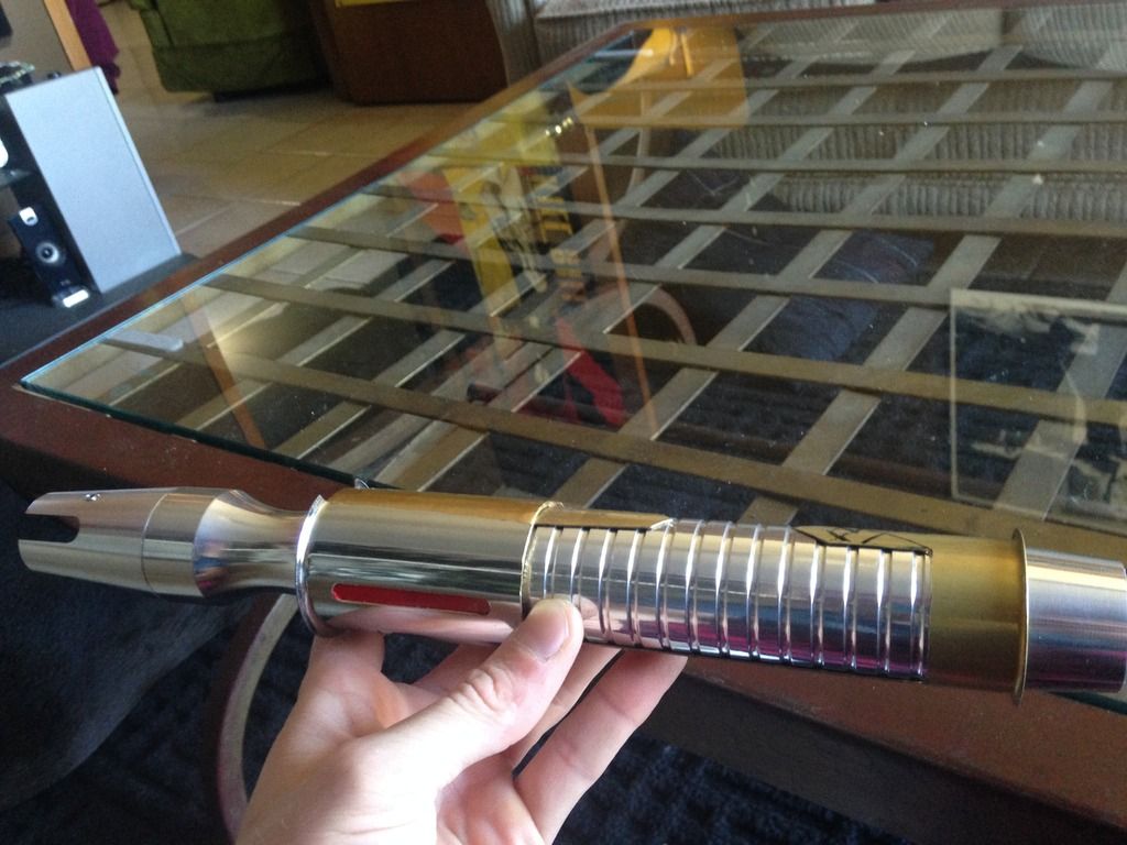

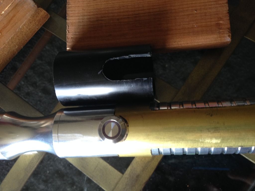

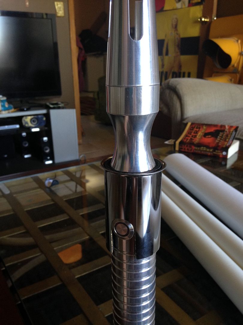

Hey everyone Smiley.  For my first mod, I imagined what my saber would be like if I was a legendary Sith emperor.  I wanted to do this first project right from scratch using stuff from around the apartment/ hardware store, and actually make the parts etc.- I'll save the pro/ stock parts for the next project.
I've got a TON of work left ahead of me for this, but here's a glimpse of the rough work I've done so far and a mini step by step:
I decided to use my emerald catalyst (with red illuminated switch) because of its elegant/ regal, yet mean, look.

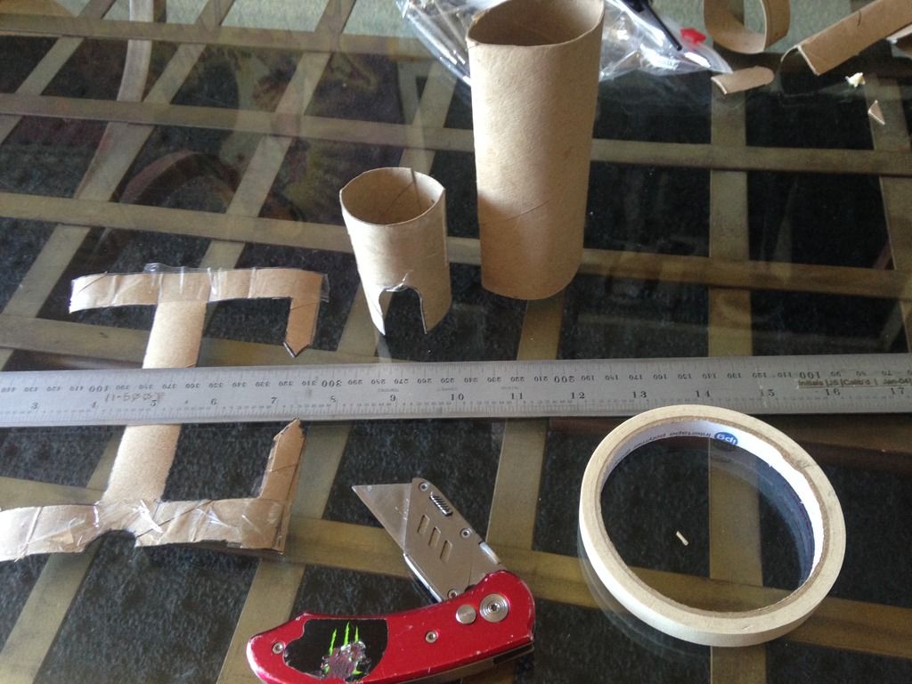

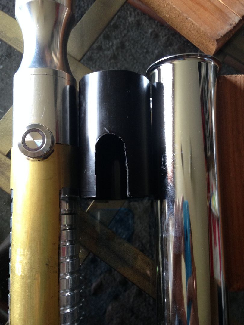

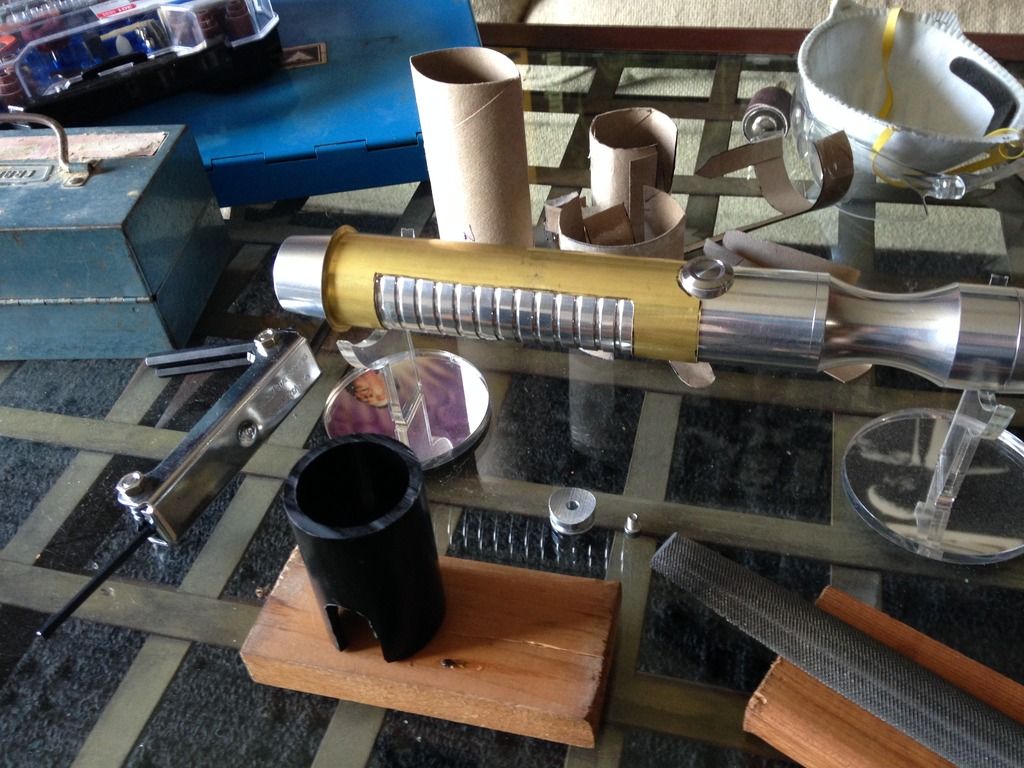

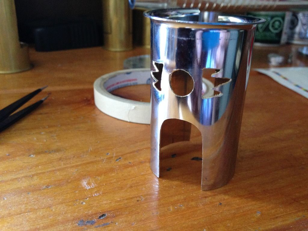

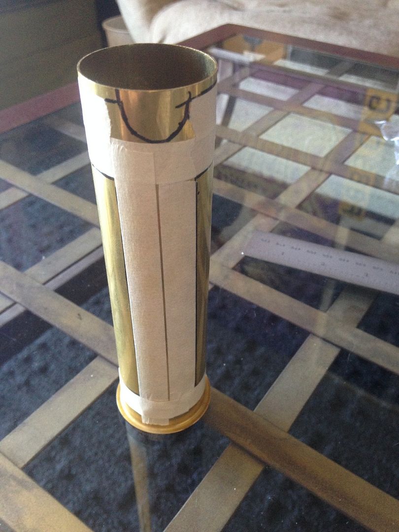

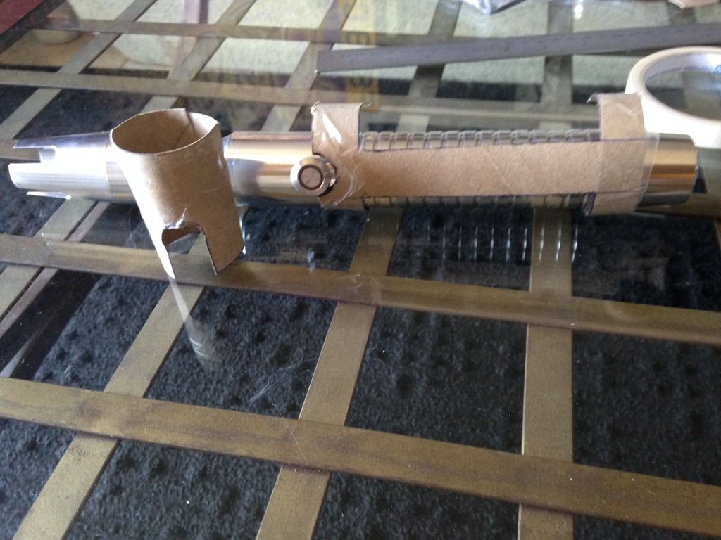

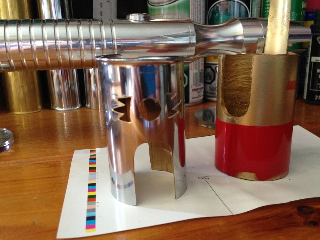

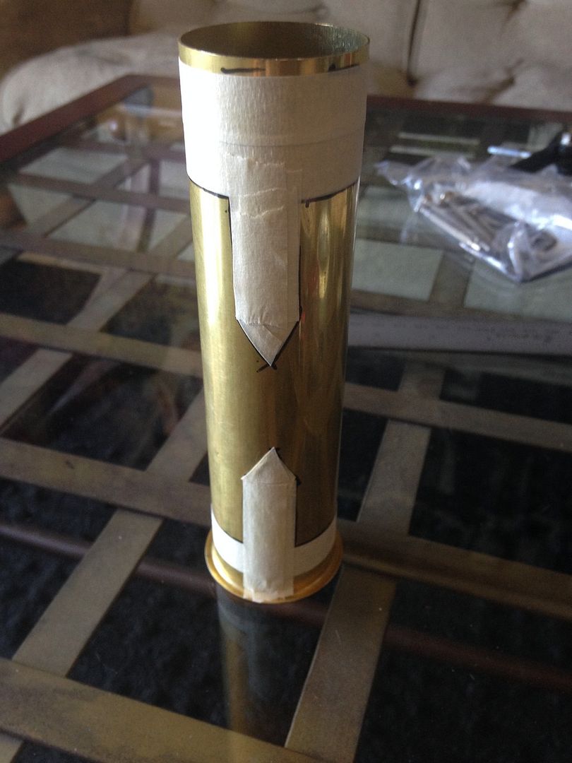

I started by making cardboard templates from paper towel tubes like I saw in srams post for pvc shrouds, and applied them to a section of pvc and also some brass tail-pieces / pipe inserts by simply tracing.  Then I used tape to make all the lines nice and straight /fine tuned.

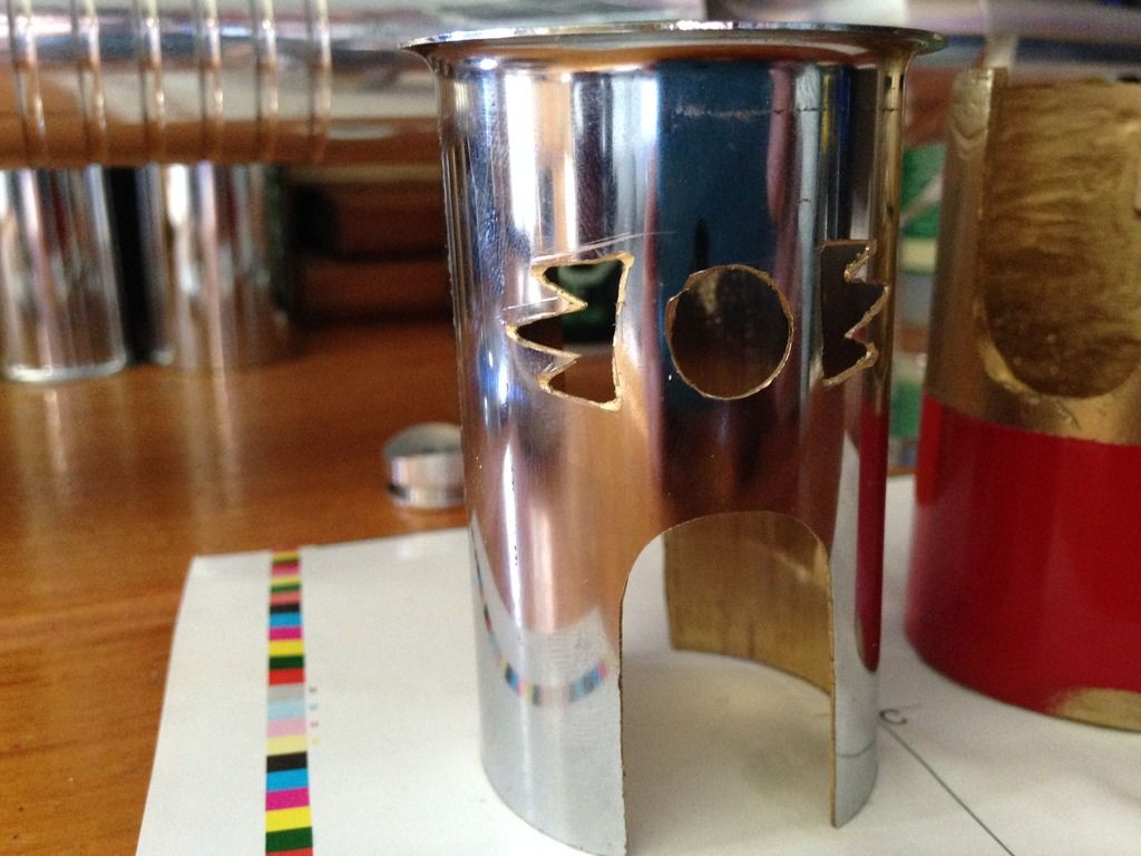

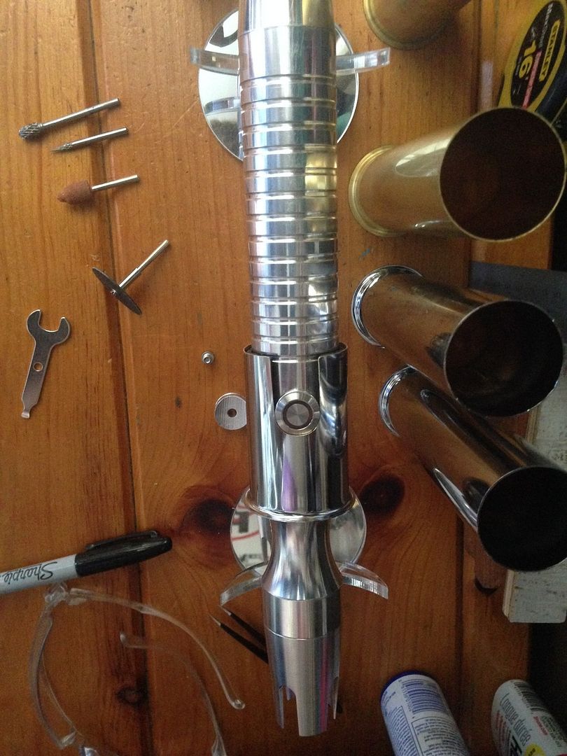

I cut out the pvc piece, which will form an outer/ thicker shroud to make the av switch low pro, and a brass insert, which will form an inner shroud, creating a layered look, defining the grip area, and giving me a hand stop down by the pommel. Did the cutting with a dremel and cutting disk, round burr, fine pencil pointed burr, and various grinding/ sanding bits. I had to remove a ton of material from the inside of the pvc to fit lol.  A drill press and drum sanding bit came in handy, but the burr also helped.
I thought about cutting a fancier pattern into the back of the inner shroud, but decided that the points would look the best, and execute better in the end.

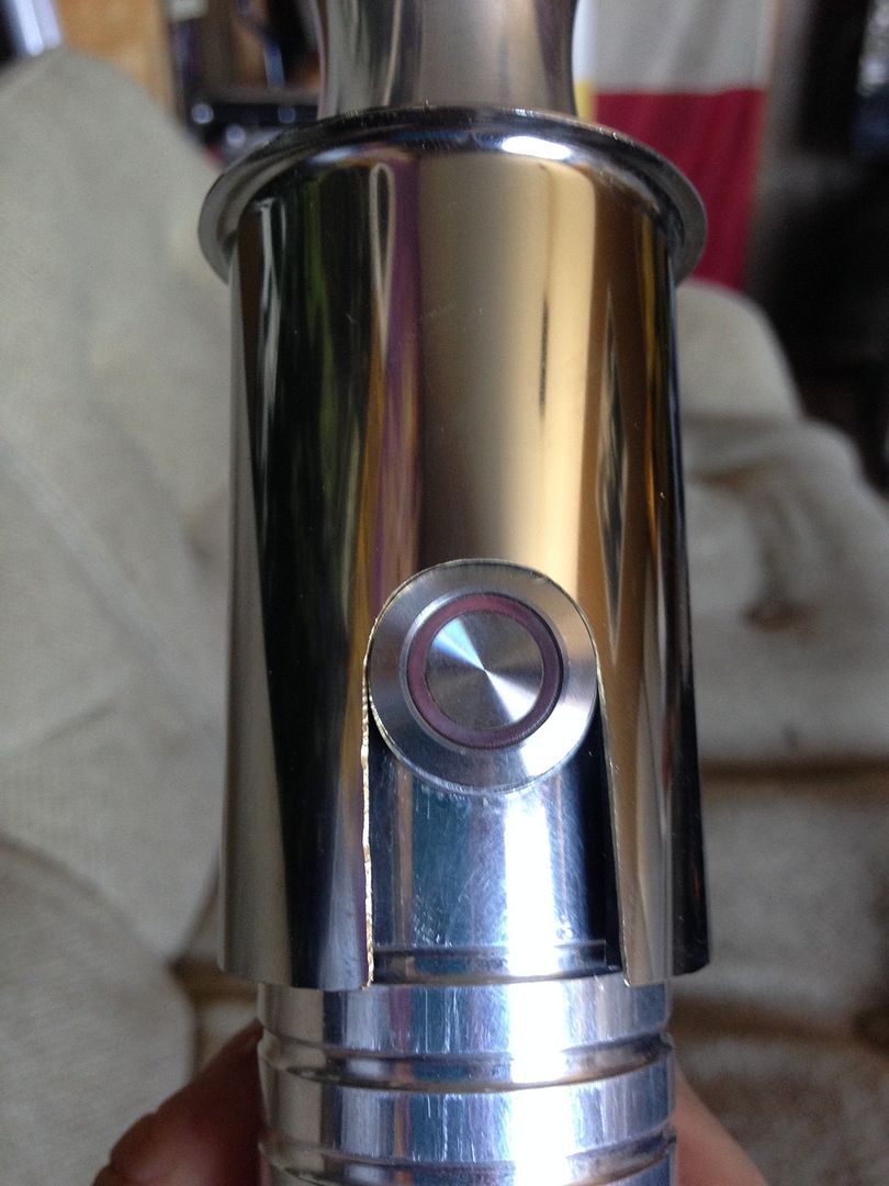

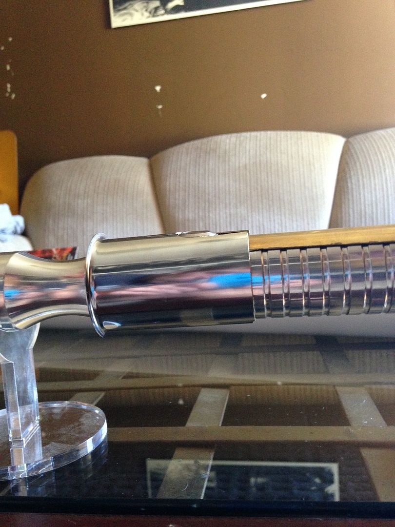

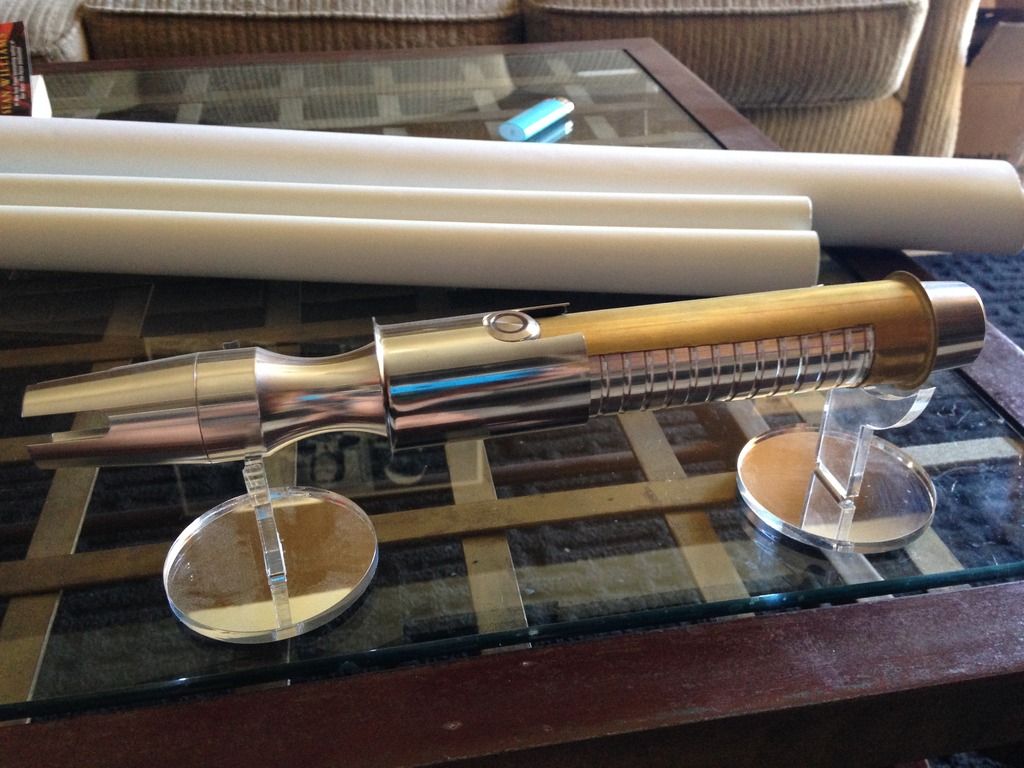

Then I repeated the process on another insert to overlap the outer shroud, giving me another flange at the choke right before the emitter, for a regal, bad ass look and great hand stop.  I cut a seam down the spine of this piece once I had it shaped, to allow it to fit over the larger pvc piece, and I will be embellishing this seam and incorporating into overall design.

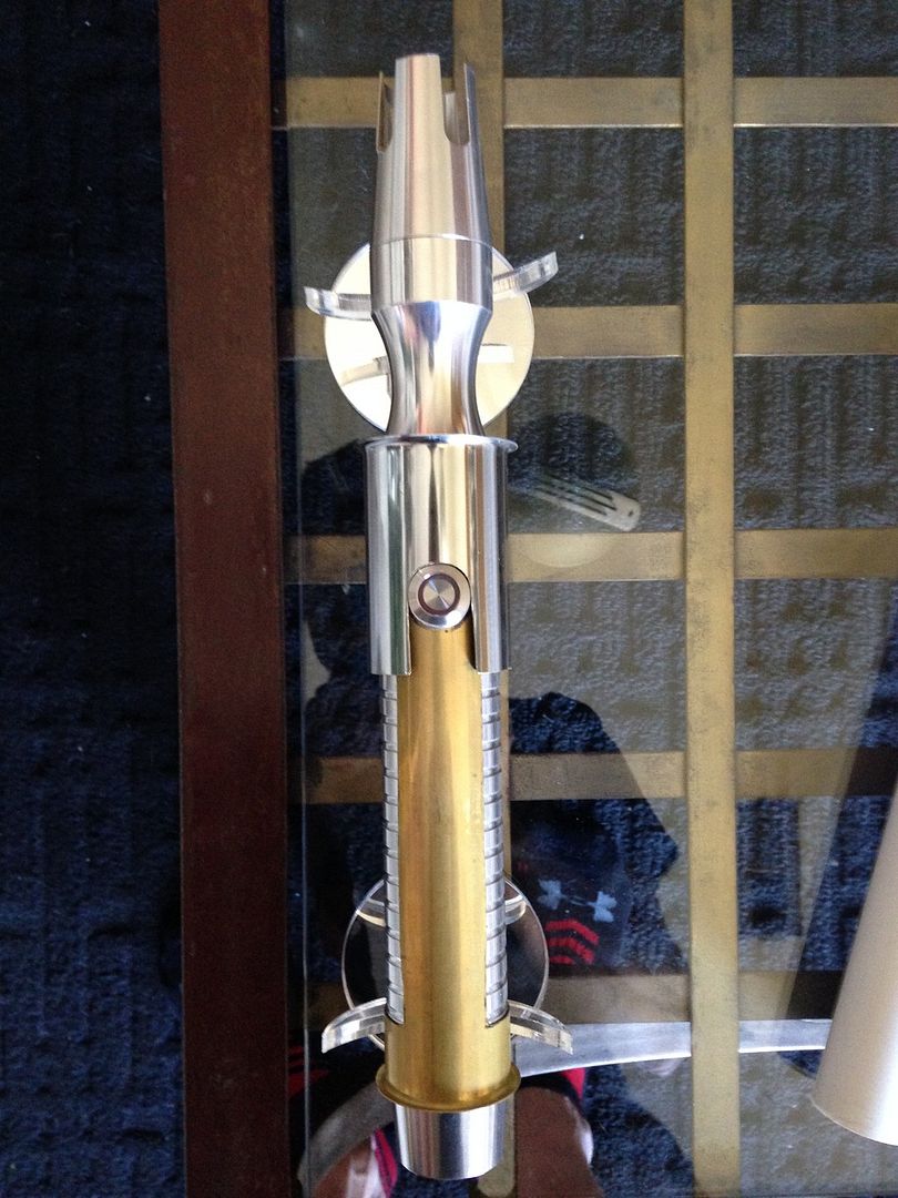

I did some more work shaping and fitting the pieces.
I've got a ton more to do- creating, cleaning up/ fitting pieces, tapping holes to secure them, as well as for more blade retention, plus I'm going to do the grooves in aluminum black, and also re- finish/ engrave/ paint the hilt... Yikes I better get back at it lol!  Keep you posted, MTFBWY Smiley

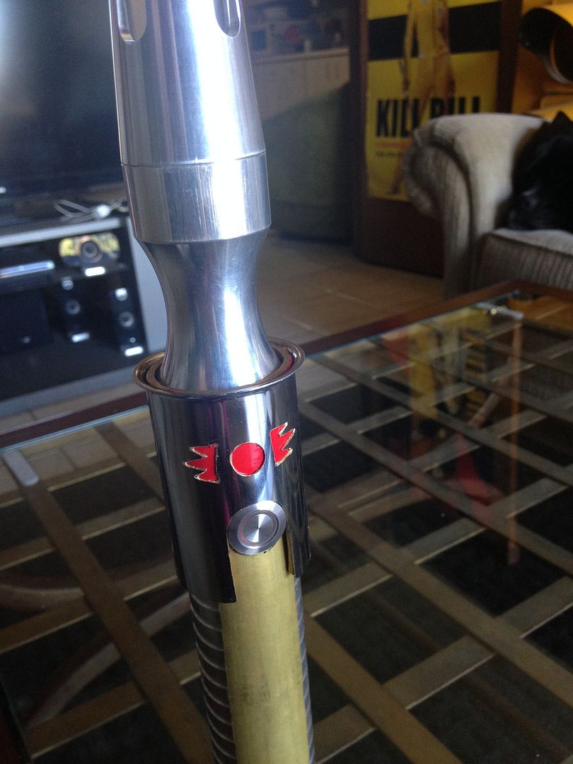

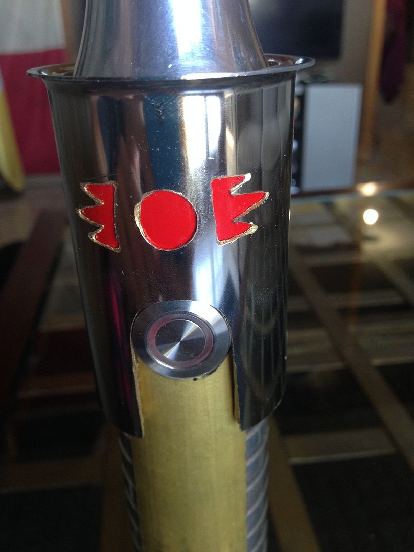

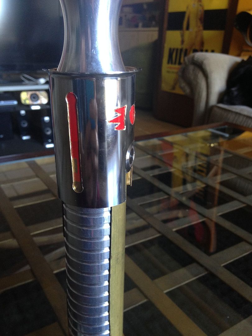

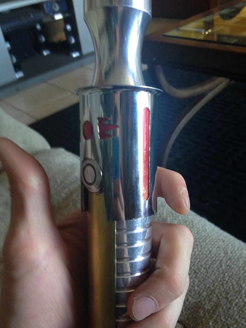

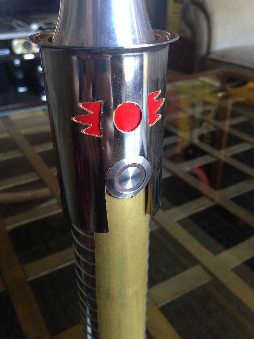

Started to do some of the more detailed work on the pieces that will form the outer shroud- doing a red sith symbol inlay above the av switch.
Keep u posted- MTFBWY Smiley

« Reply #6 on: September 30, 2015, 12:59:14 AM »
I really like the looks of the gold shroud on the silver hilt! that looks sweet!

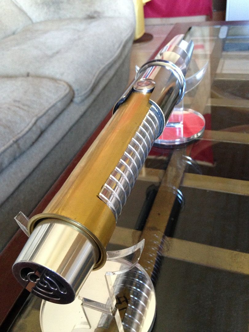

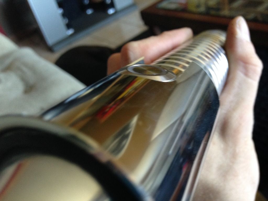

« Reply #10 on: October 05, 2015, 06:20:29 PM »
Hey everybody Smiley
Been super busy lately, not a lot of time for the project- but managed to pick away at the outer shroud a bit more before bed today (I work night shift).
Everything still needs to be cleaned up a ton and tweaked, plus I've just got so much work on this one that I haven't even begun yet.
The sith inlay's still messy ATM but I'm happy with how will turn out.  Did some vertical grooves, which I will be sanding down deeper and blackening to match the grooves in grip (which I'll be blackening too).
Excited to get to work on the refinishing, engraving, thread tapping, etc.  Keep you posted, MTFBWY:)

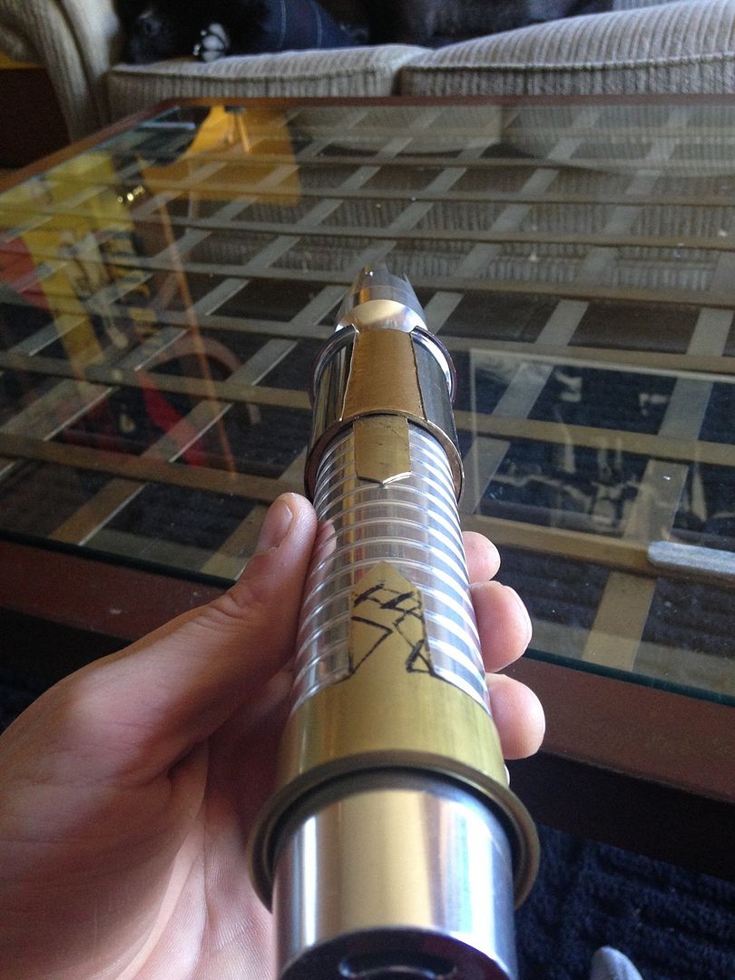

« Reply #11 on: October 13, 2015, 11:56:42 AM »

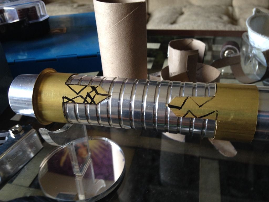

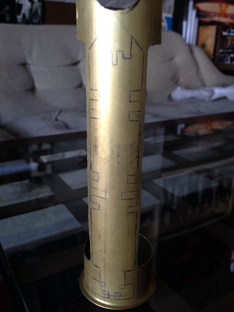

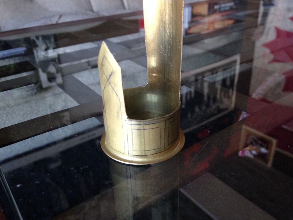

Hi all Smiley. I got the pattern I'm going to engrave on the inner shroud marked out... Hmmm, maybe a little ambitious considering I've never engraved anything in my life lol, but you gotta learn somehow!  I'll have to mess around on some scrap before I start Sad but I guess if it's worth doing it wouldn't be any other way lol.  Keep you posted, MTFBWY.

« Reply #12 on: October 13, 2015, 08:37:03 PM »
Oooh.. I like where you are going with the plans for engraving.. that will look super sweet! Good Luck!
Drahcir
Keeper of Ancient Artifacts
Force Alignment: -972
Posts: 3014
« Reply #13 on: October 13, 2015, 09:24:33 PM »
Definitely practice the engraving a lot, it's really easy to slip on the curve.
