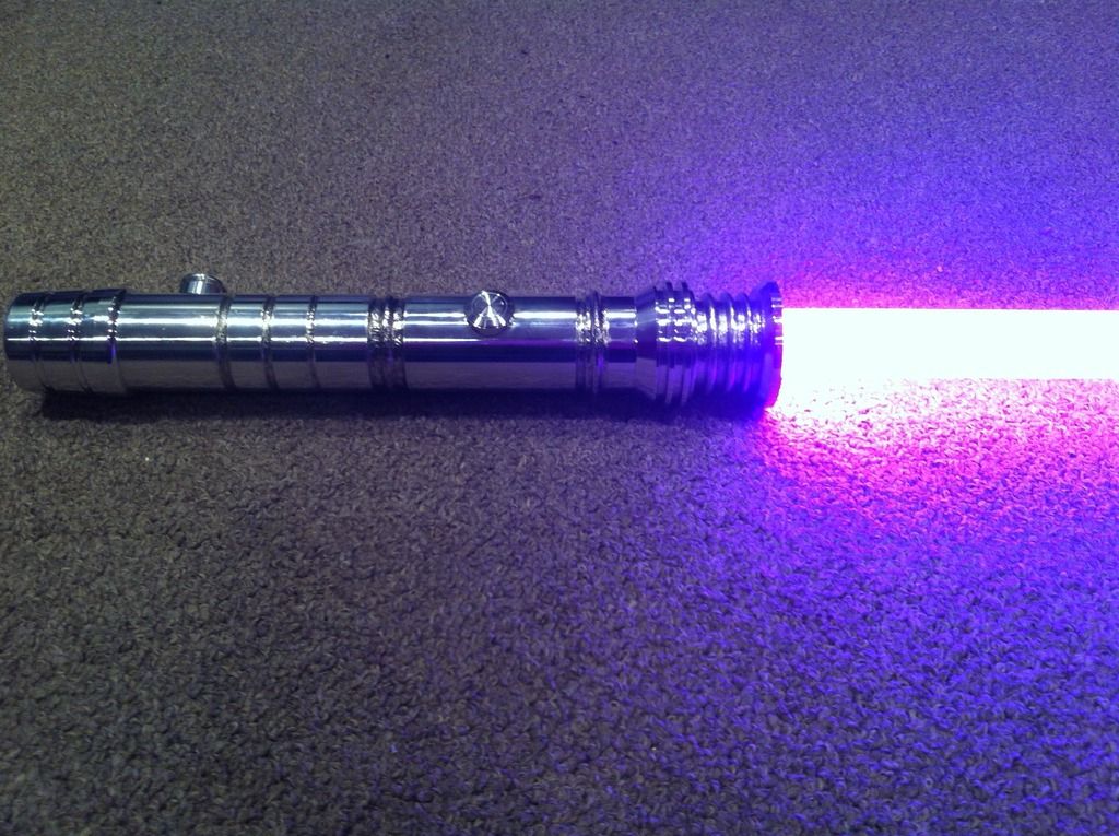

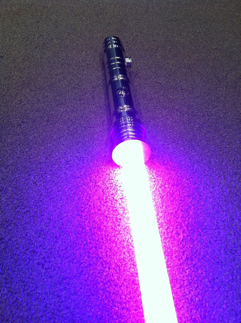

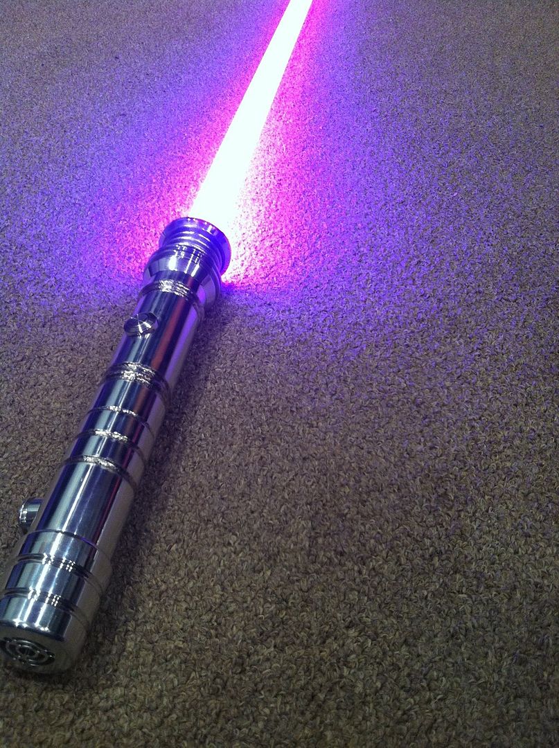

Recently been working on my friends Standard Edition Battle Saber v3. This saber was originally in Artic Blue, but my friend got bored and wanted a change up.
We installed a yellow LED, with a matching 12v LED switch. The switch is latching, as his saber is a stunt without sound. Also added a brown leather grip, and o-rings for some extra detail. The colour of this yellow i can only describe as a very rich golden yellow... it's very striking and the pictures don't quite do it justice.
In order to power the switch and main LED properly, we also upgraded his setup from standard AAA's to Li-ion  Grin
This thing turned out very bright too, it's currently in a heavy grade blade and seems to be evenly lit. Somewhere in between my normal sabers and tri-cree saber in terms of brightness. Although i have heard yellow is a bright colour any way? Smiley
The best bit being that we purchased all the parts needed to do this from Amazon for under £20!
The only picture we remembered to take whilst installing the upgrades lol
My friend wielding his newly converted saber for the first time! (he was extremely happy)
Anyways, thought i'd share some pics of our latest tinkering.
