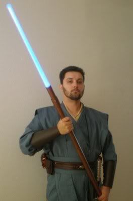

« Reply #10 on: December 12, 2011, 06:57:07 PM »
See that?
'Tis the Ultra Yari. Similar in style of combat in its half staff form, I guess. The first thing you have to do is come to terms with the reach. The best thing I can tell you is to stop its movement and try to get inside its arcs, and that's still iffy depending on your weapons, plus I like to show fake gaps with my Yari to try to lure an unsuspecting duelist in.

« Reply #11 on: December 12, 2011, 07:12:14 PM »
For some reason I had an idea of a spear-like blade, rather than saber style.  Wonder why my brain went there.
And the yari looks pretty excellent!  The reach on that has to be impressive, not to mention the bracing power one would get being able to keep one's hands further apart.  That's one thing I really enjoy about the Dark War Glaive - and the hilt on that is TINY by comparison to your yari.

Close to the size I was considering...perhaps that minus 8-10" on the staff/hilt section.
Cool stuff.
Have you considered wrapping with cord or thread to break up all that brown?

Tricking it out is on my to do list, actually...
