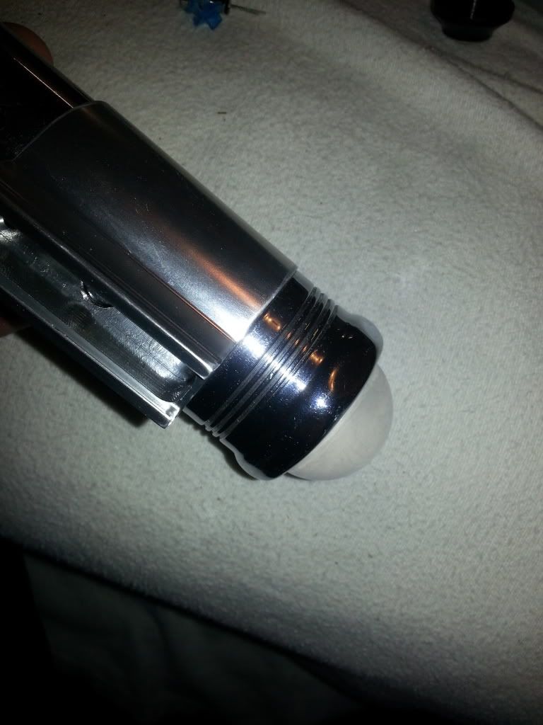

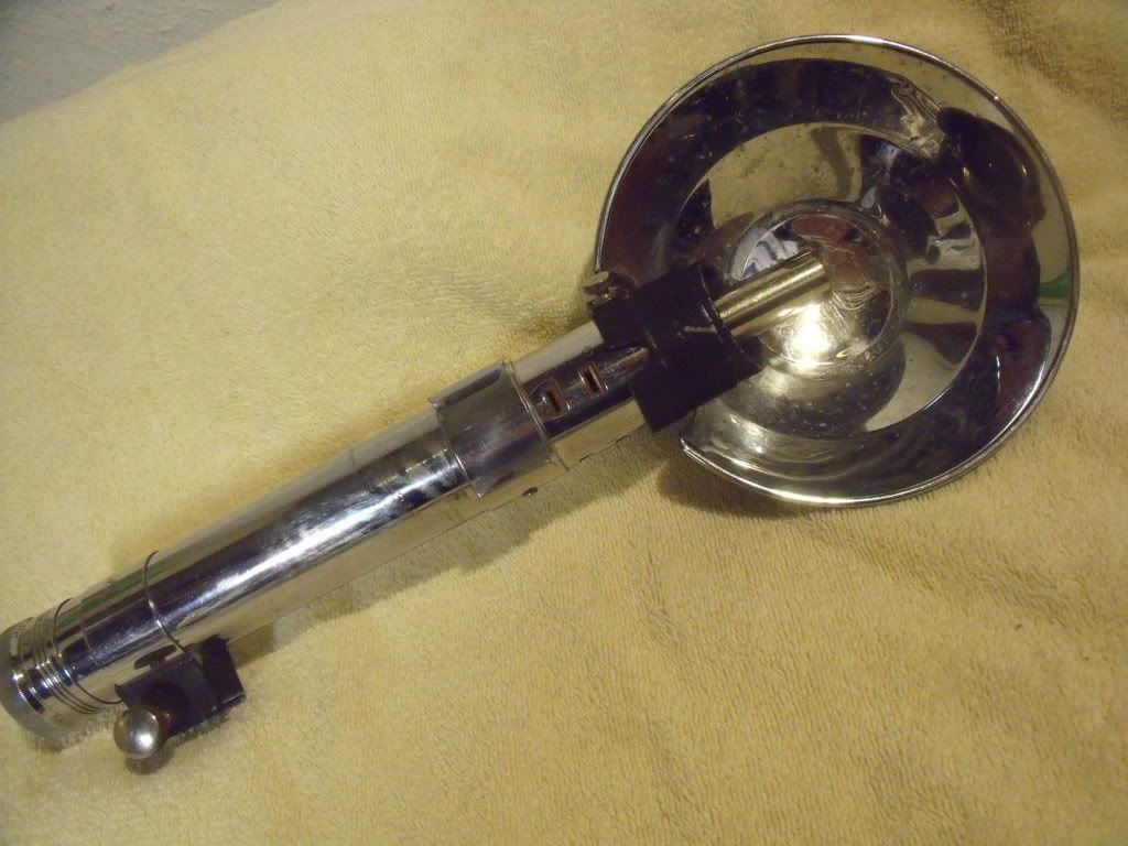

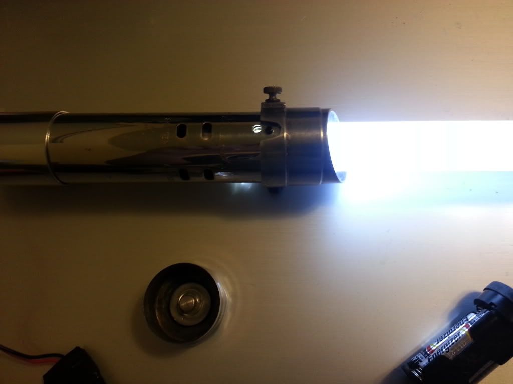

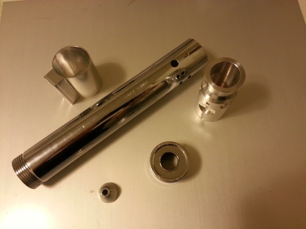

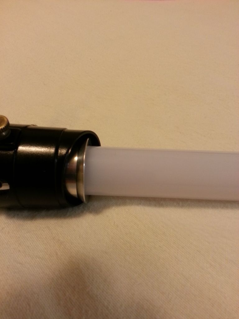

My plan was is to build a matched set of heinland theme sabers. Based loosely off Vaders ANH saber. The concept was one of Vaders lost/Failed apperentices.
I have aquired a heinland 2 cell and a 3 cell Flash tube.
I started with the 2 cell since it came in the post  frst.

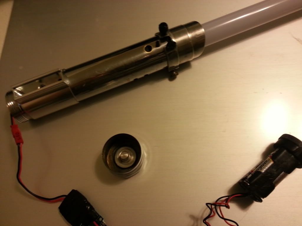

After gutting it and seeing what parts could be salvaged i started the build. I was able to salvage the Flash Emitter and drill it out to take
set screws and thumb screws to keep the blade sturdy. I was also able to make a rubber shim to keep the LED housing in place.

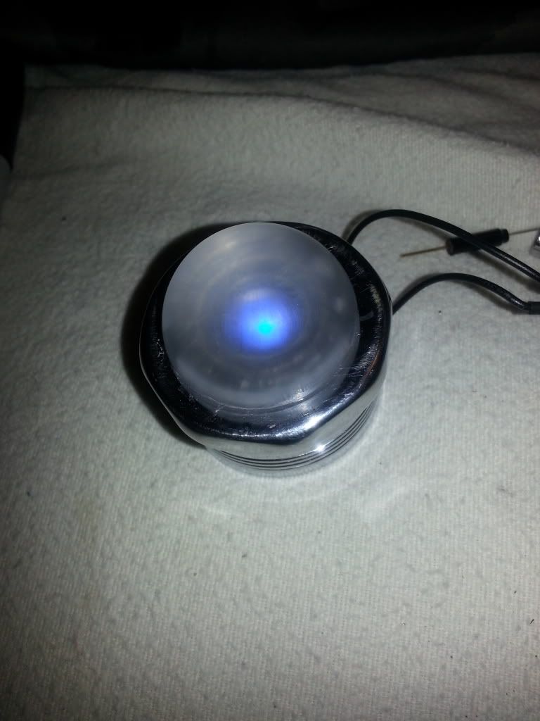

Installed will be a Vader Hasbro Ulti FX board and a mini Avatar pulsing Happy meal toy board.
I may install a PLI in the Box on the grip. I have plix but fried it due to a cracked resistor.

« Reply #8 on: November 27, 2012, 02:23:59 AM »
Haha Manroon funny you mention your 2 cell build i actually found your youtube vid after i orderd my 3 cell. the 2 cell came first, your build gave me a little insight on size. my flash tube emitter was slightly diff than yours on the 2 cell. The 2 cell has the same innards as your 2 cell. I am scrapping the 3 cell emitter for a TCSS anaking FX conversion part.
If i remember the tube is 1.5" wide, plus i did mount the blade holder Mod* about 1/2" higher with set screws.I will be mounting a 7mm lighted tactile switch a soon as i get it from hong kong lol. Plus a micro laching switch for the pulse board on off.
I also need to fabricate a ring to sit around the base of the half dome to appear as a mounting edge.
Will also be adding a covertech wheel in silver since the box will be black along with the emitter, and instead of the wiper blade look i found some small round adhesive half domes that i will use as grips.
I will be doing a hybrid graflex build in the near future but they are hard to come by. the heinlands are a tad easier to locate. I do have some hooks out in other channels to source more of them. Will gladly share if anyone is looking if i come across more than i need.

AHHH, I see now! That 1/2" is where you got the room. As I recall, that's about how short I was of the minimum I would have needed to squeeze an Obsidian with Lith Ion in there. If I ever do another one of these (unlikely I'll admit) I may sacrifice the crystal effect for that. The hilt practically cries for the lack of sound. lol And I think I see the differences on  the emitter now as well. For one thing the screws on the back of yours are MUCH larger than mine (I'm guessing those are your set screws?), and it also looks like yours is a lighter color by the last pic. That might just be the lighting, but I like the look. Gives a nice Ani-Vader hybrid feel.
I'm glad my youtube vid was helpful in some way! It's always nice when my own fun can contribute to someone else. Smiley I like the thought of the lighted switch on there, that will be cool! I wish I'd thought to get a Micro latching switch for my build. It would be murder to switch it out now, and I went with a Micro Momentary at the time because I was thinking I'd find a way to squeeze in sound somehow. Though the dead man's switch effect that created is fun, and it's more a display / cosplay hilt for me than a fighting one, so it's not a major detriment.
I like the sound of how yours is coming together. All the black on there, coupled with the pulsing dome and the domed grips, will make for a sweet look. I've never seen grips like that, and I've long been a fan of black activation boxes. The covertech..... eh, to each his own I suppose. lol I'm sure it will fit with your rounded style though. I doubt a D-Ring would look right next to domed grips and such anyways. Wink

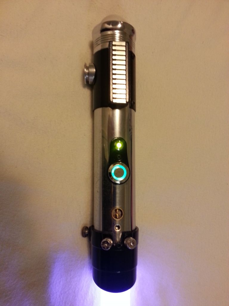

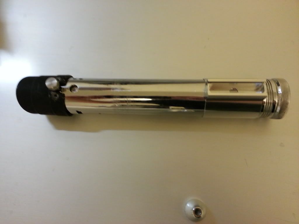

« Reply #10 on: November 29, 2012, 03:55:29 AM »
More in Progress photos. Mounted the covertech and drilled the 4-440 holes ( still need button heads ) for the box. added the dome grips. will add the micro switches and black the aluiminum soon as i get the material. Parts also came for the 3 cell which i will start on in the next few days. Still need to clean the excess sticky goo off the hilt.

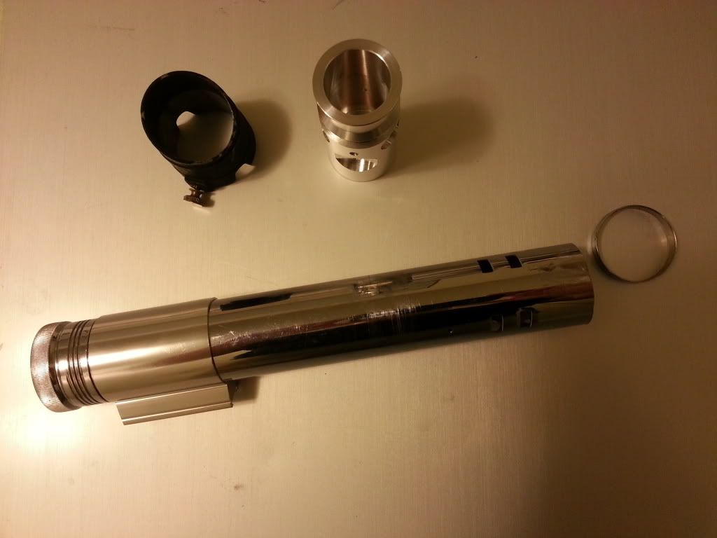

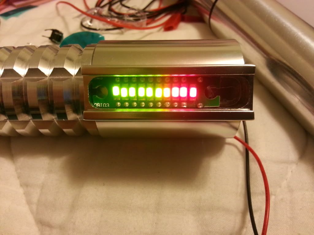

3Cell Work in progress:
Anakin TCSS FX adapter as the emitter
Cut down the Flash tube 3/8th of the inch
cut a channel in the emitter to mounth wires for the switch
More info to come
« Reply #12 on: November 29, 2012, 08:12:59 PM »
Okay, those are just all out SICK. You definitely went the opposite direction of what I did on mine, and I LOVE what you are coming up with! The Anakin emitter ring inside the Heiland shroud is just genius. It looks fantastic. The silver shroud on the 2 cell is really nice, it helps keep the saber from going too dark with the black grips, which are every bit as unique as you promised. This pair is going to be beautiful when it's finished!

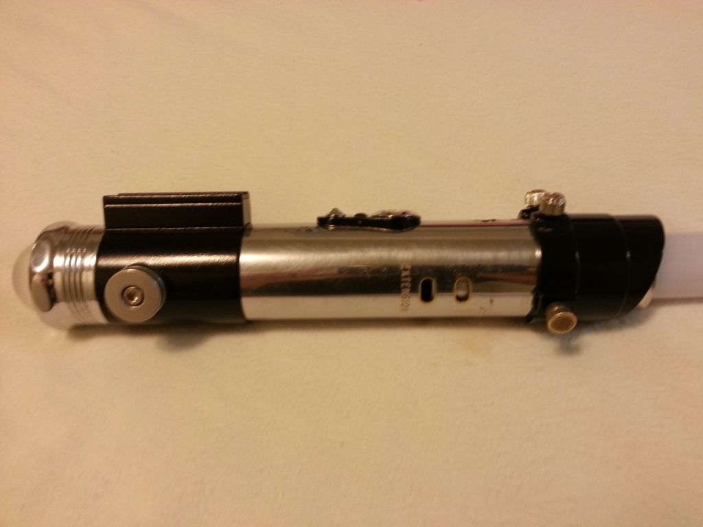

« Reply #13 on: December 10, 2012, 04:04:25 AM »
Dalek Saber... reworked lol had some issues with the dots sticking.
So almost done heres a few shots of the progress
