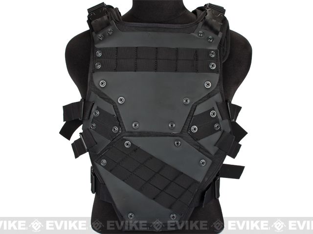

« Reply #13 on: January 04, 2014, 11:14:45 PM »
I like the look of this... I will be using it as a mounting base for my costume this year.
Only around $80... not a bad price for a good mounting platform.
