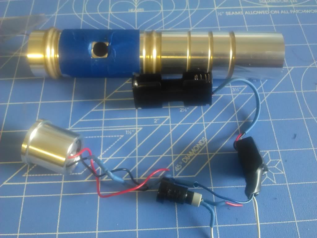

Today I began the rebuild of my shock le after filnly getting all my parts in. Before I begin actually getting down to the real busness at hand(adding the actavation box courtesy of The Ultrasabers staff, an orange iluminated av switch, obsidian sound bord, speaker. An mhs emitter and an msh pomel with a d-ring insert.

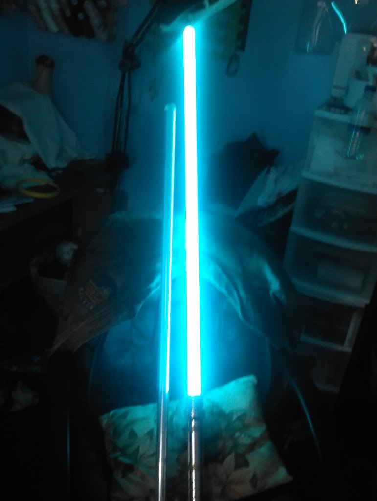

       But my first step was to so some experimental sodering. So I played around with my Sentinel yellow MLS unit and..... we get cyan
  In UEHG
And HG
I will continue to updade this thread as I progress.

So far so good Smiley Cyan is a good look for a saber blade
I encourage you (with a point) to continue updating us!

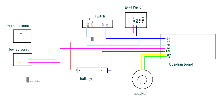

As an addation to the customization log I'm including the wireing diagram I will be using ( provided by members of this forum)
As an added note the resister used for the illumated av switch as I have found on this forum and other research is 270 ohm 1/4 w

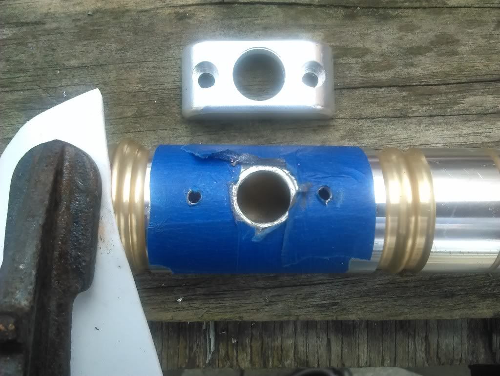

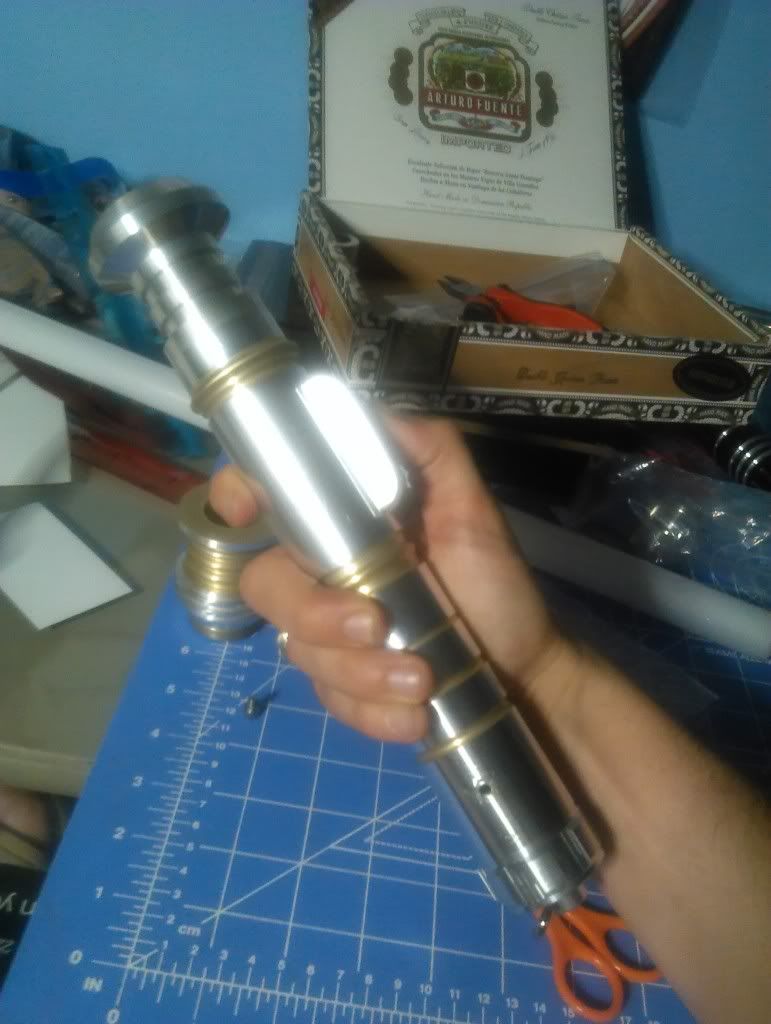

« Reply #12 on: February 08, 2014, 05:48:03 PM »
An idea of what its going to look like once its assambled. I'm going to add a leather wrap and brass rings on the lower portion
Preping the switch for removal
Switch removed I'm going to need to drill out the hole a bit to accomadate for the illuninated av switch

« Reply #14 on: February 08, 2014, 06:27:22 PM »
Holes drilled and tapped
Actavaction box test mounted ( perfict)
