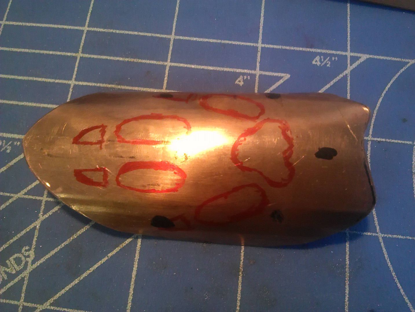

Recently I've seen forum members show interest in having some engraving or etching done on there sabers/ shrouds. So I'm gona show y'all how I did some of mine for a current project I'm working on.
Let's go over what you'll need.
1. A varable dremel tool with dimond tip engraving bits ( the extension is verry handy)
2. The part to be engraved ( the example I'm using is one of a two part shroud .)
3. Fine tip permanet marker
4. The patteren your going to use or you can free hand ( this example is done free hand)
5. Pleanty of light
And don't forget when working with power tools SAFETY FIRST!
Ok first get your pattern and either cut out the dark parts so you have a stencle or if your feel'n froggy you can just free hand it.

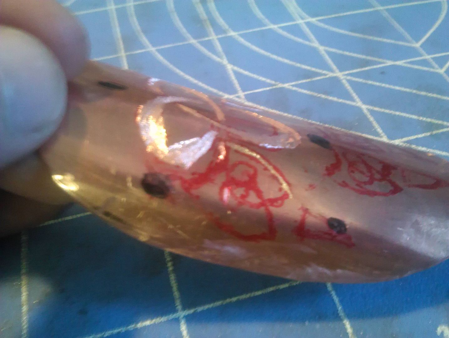

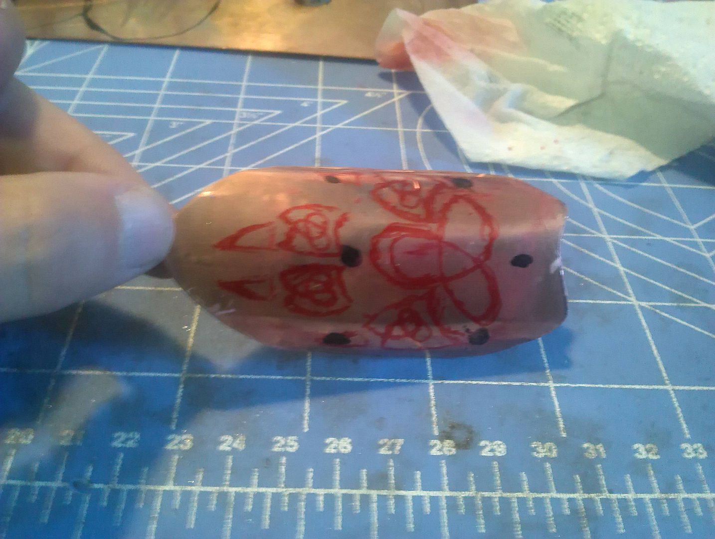

Then finalize your pattern
If its free hand don't worry about mistakes its just a guid. If your that mutch of a prefectionest you can use a papper towel an a dab of rubing alchol.
Next step start grinding away using a fine tip at first so you can get your lines in. And remember to go slow working one section at a time and to clean the dust as you work

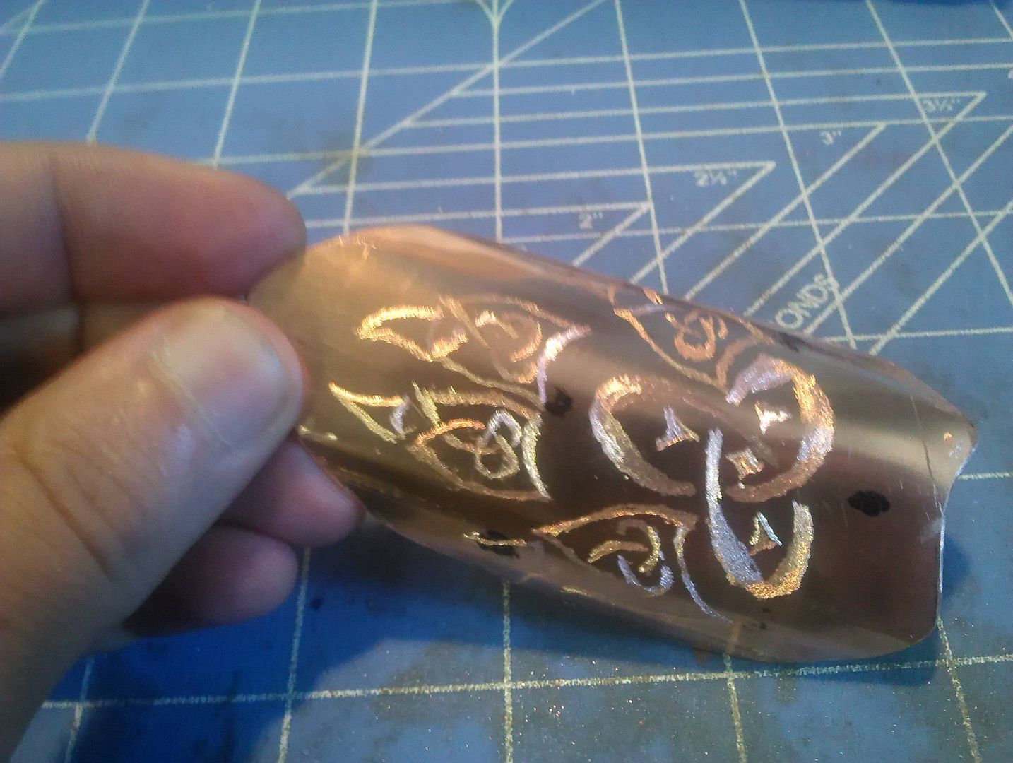

Ok now we have most of our designe done. This would be a good time to go haead and clean off that marker, just a little hand soap and warm watter works great.
Next do a little detale and clean up your lines then were done
Thanks for looking and  mtfbwy
