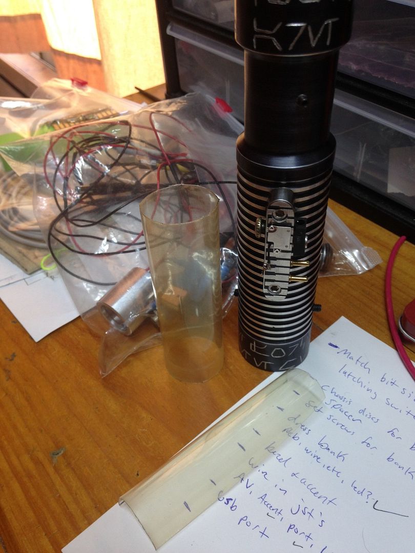

As far as progress updates go there's not a ton to show here- BUT I thought one thing in particular was worth sharing because I think it's a cool idea a lot of people could use in their modding.
Remember that pic way back of the burnt florescent tube I took the pins out of?  If you look there you can see this plastic tubing that's designed to encase the bulb and contain glass if breaks... Turns out they fit perfectly inside the typical ID of mhs hilts.  Now i'd hesitate to call this a chassis material, though I'm sure could be worked into one, but more like a non conductive shielding for internals.  Basically you can swap the metal (short potential) inner walls of your hilt for some nice safe plastic Smiley. Plus it'll kind of contain the wiring.  This type thing would be especially handy if you were installing your own clash sensors etc- they sit suspended in your wiring and swing around in the inside of your saber by necessity, personally i'd feel a lot better about them banging into this plastic than into the aluminum.  And if your doing any kind of window- like for a crystal chamber, or pli, or something like what I'm doing here- really puts a nice finishing touch on it:
Side note- of the projects I have going ATM, this one's closest to completion... Closest is a relative measure lol, there still a ton left on this thing, as evidenced by the depressing lack of check marks on that list if you can make it out lol!

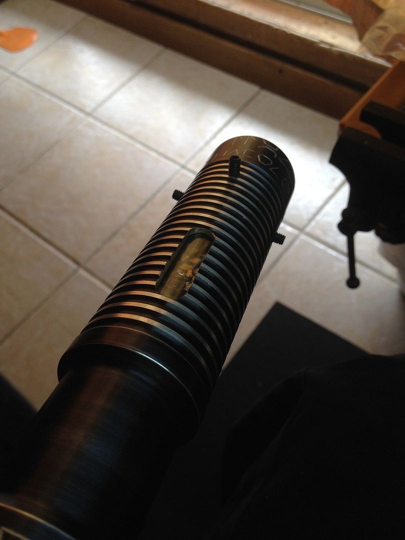

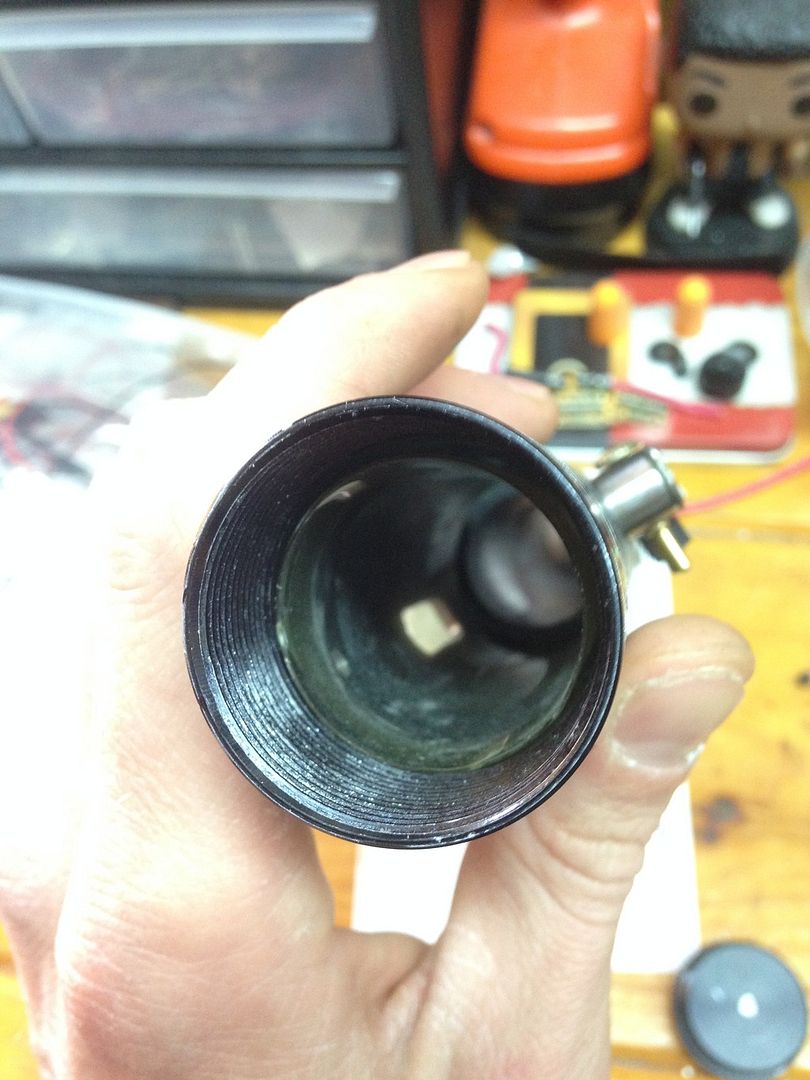

I actually had to cut the insert up to lodge strategically into the top face of the bank because of the shape of the bank and how tightly I fit it.  But gonna work great Smiley.  I just stuffed it in for these pics, it actually has a nice perfect/ gapless fit when you take the time to fuss with it.
I didn't get pics of it, but the window actually really helps reflect the illumination from the hidden accent that washes over the bank, and it looks a whole lot more saturated with it in place Smiley

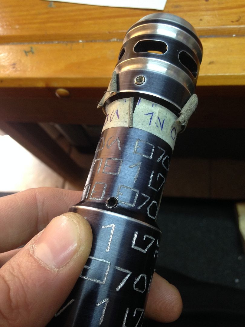

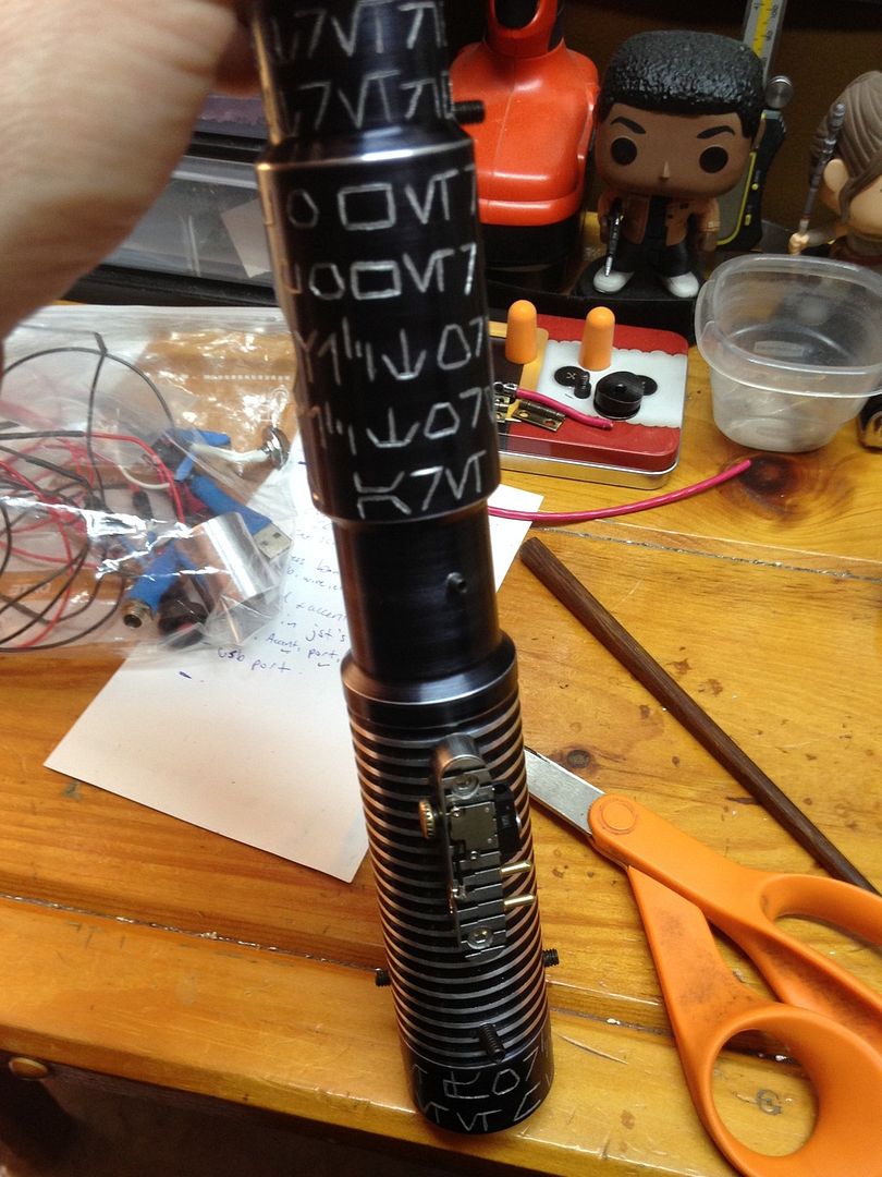

Good thing I'm tantalizingly close to being done with roughing in the aurebesh with the electric engraver lol, doesn't look like my reference tape's gonna make it much longer lol.  I decided I might as well tap a set screw to hold the led module securely in place.  Man, is it just me or did this mod end up requiring an awful lot of little holes?!

Have you thought about replacing all those retention screws with knurled screws in order to give it a more aesthetically pleasing look?

Keeping up with your progress Rev . . . . and I bet the window does look awesome illuminated through the clear tubing, that is a great idea . . . . +1  Smiley

What was that clear tubing for?(saw you mention light bulb but could find pic) I found something similar but it way thicker than that stuff, using it for double crystal chambers on saberpike, but that tubing is a great idea to cushion impact as well as aesthetic reasons.

  You know, I did actually think about that Greg- and I might still opt for a knurled thumb screw on one or two strategically placed spots- like say for the led module screw or wherever happens to look right.  But there's just so many, and they all kinda had to go where they sit now- like I was limited in where I could locate them since was all about function, like securing various things- and I think it'd be too busy if I put too many knurled screws in.  But I'm not too worried- for one thing I used black set screws, and also they'll be sitting flush to the surface of a black hilt so they'll blend in really well.   I just had them all sticking out in those pics, but won't look like that when everything installed Smiley.   I mean you'll def see them, but they won't stand out.  And like the one in the choke for instance gets pretty much completely hidden by the little wire strap/ wire holder feature I rigged up there.  Call me crazy, but I think all the little flush black set screws will give it kind of a Frankenstein vibe, especially when combined with the exposed wire, cut away detail, etc- which is perfect for this project Smiley
But, I def will be considering a knurled for one or two- good thinking Greg- thanks for the input Smiley
