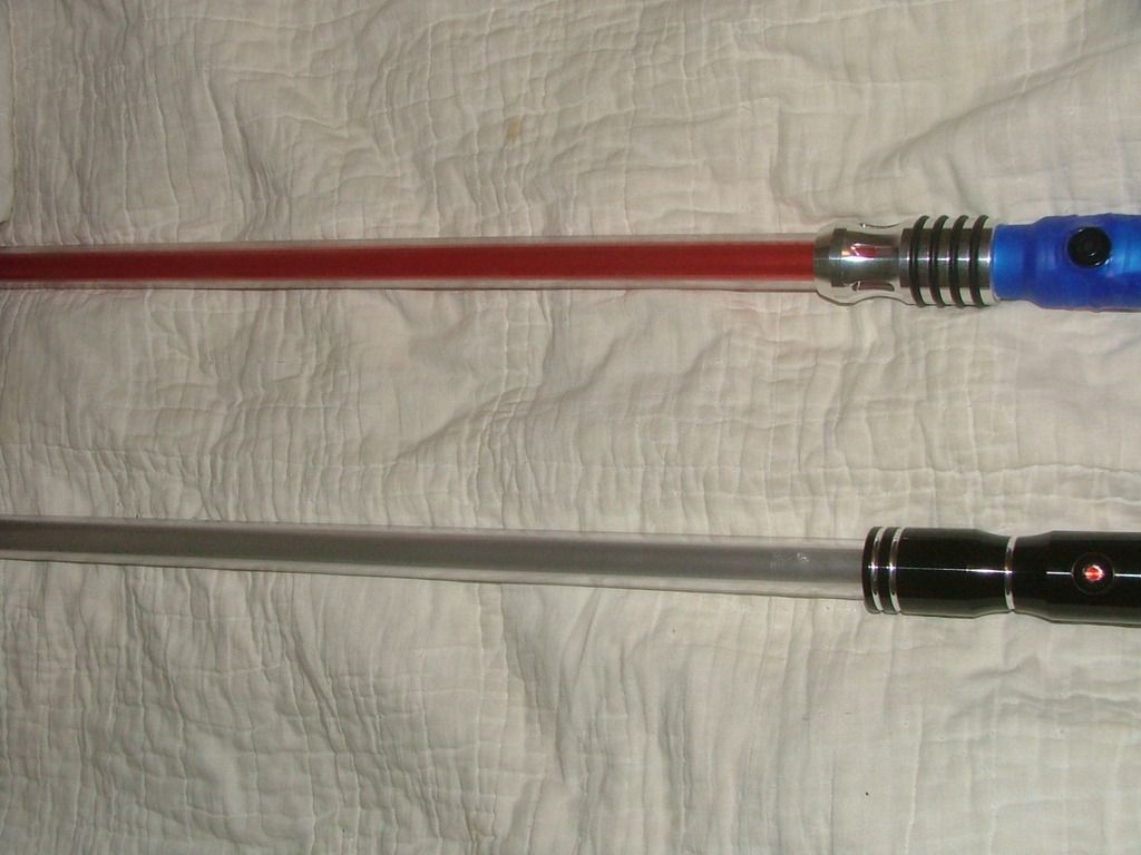

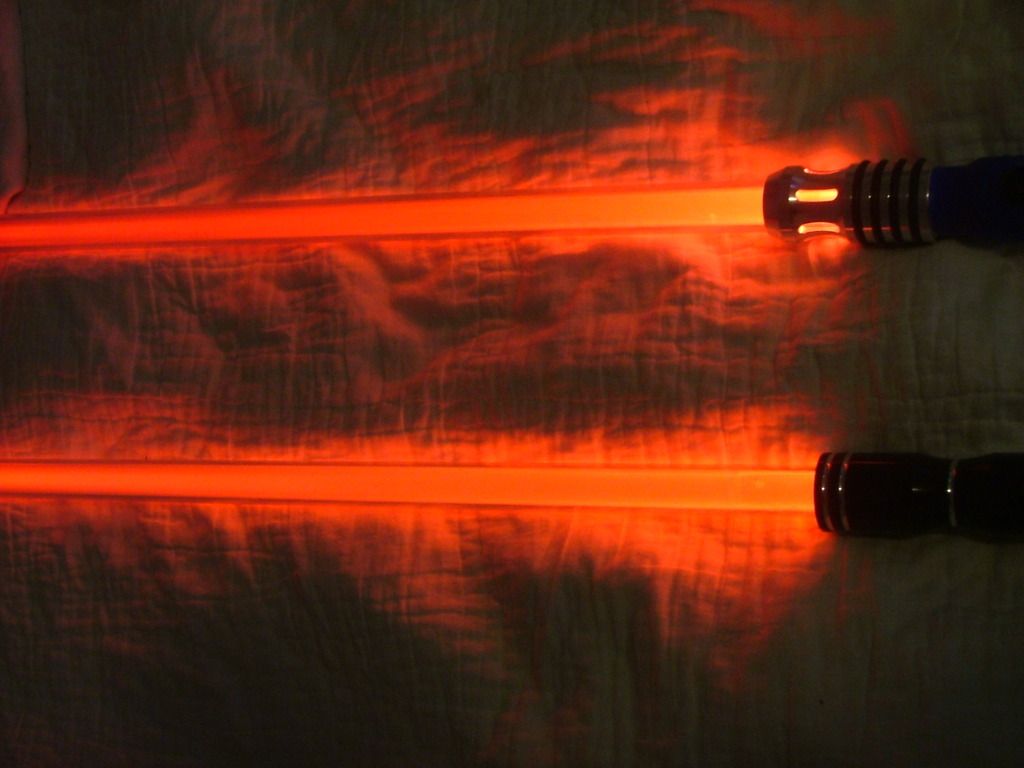

Homemade dayblade in a low level light room. These look the same to my naked eye. Any visible dimming by the layer of red cellophane is minimal.
Homemade dayblade turned off.
And this is what it's really for. Homemade dayblade turned on under a flash.
It preserves a bit more pure red color. Enough daylight makes it look like a red tube inside a clear tube. Nothing withstands direct sunlight. I don't see how other dayblades would overtake that much ambient light. But, as the light reaches a point that a regular blade begins to fade, this keeps color more. In a dark room, I have a saber as usual. In a low lit room, I have a saber as usual. In a bright room, I have a saber with a bit more color. Eventually, there is a point where the ambient light takes away any illusion of a lightsaber making it obviously a shiny tube, but this one becomes a red tube instead of silver tube.

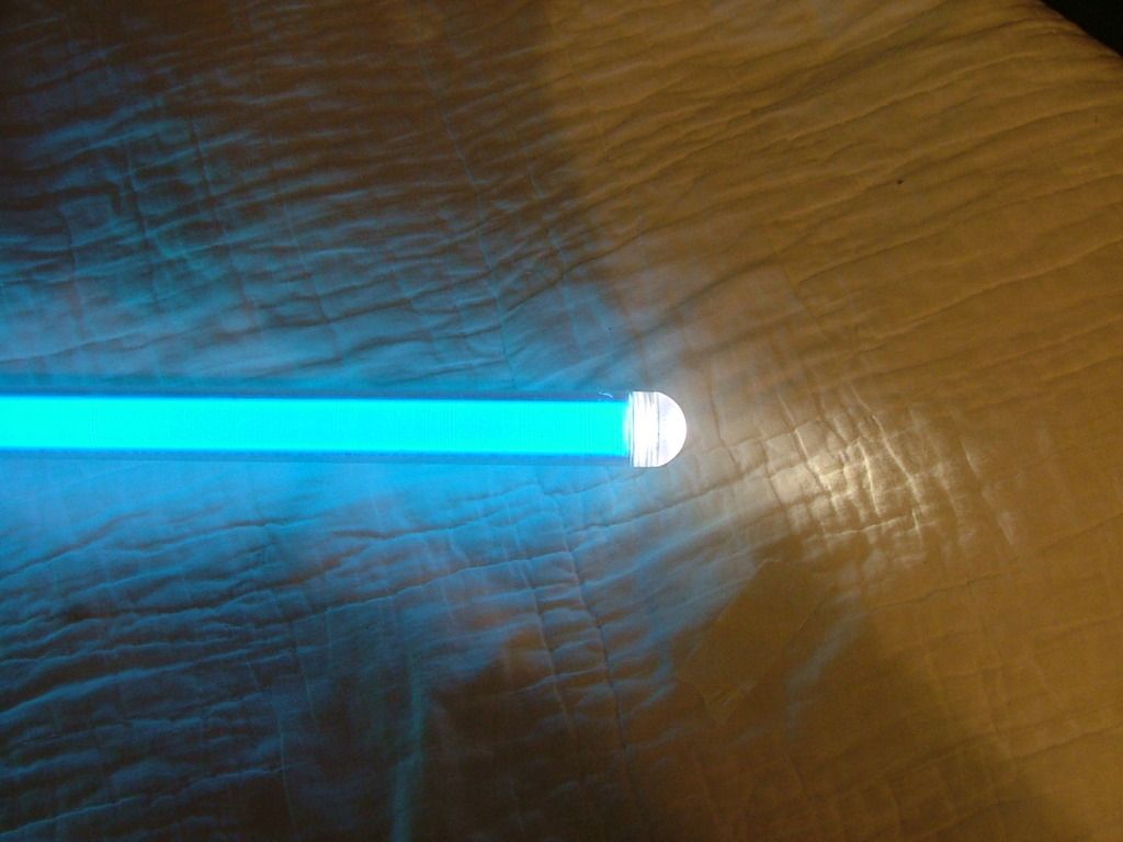

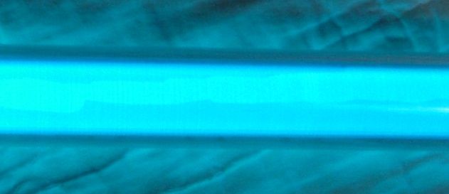

Green and blue cellophane is giving me troubles. If the LED color isn't as deep a color as the cellophane, the edges where the cellophane was cut are clearly visible. It does give me an idea for a Kylo unstable blade look, but the red is not the one showing the cellophane edges. A bit of luck will be involved for the cellophane to match your LED color. More layers helps, but also darkens the blade.
I'm using adegan silver with color filters, so I just went through until I matched. I went without a blue filter, just to demonstrate the clear tip for anyone looking to copy this method. Just know what you'll get.
Off
On
On under flash
Colorless tip
Cellophane edges. Keep in mind this is adegan silver. A deep blue LED should perform more like the red. I just don't have a blue LED saber right now.

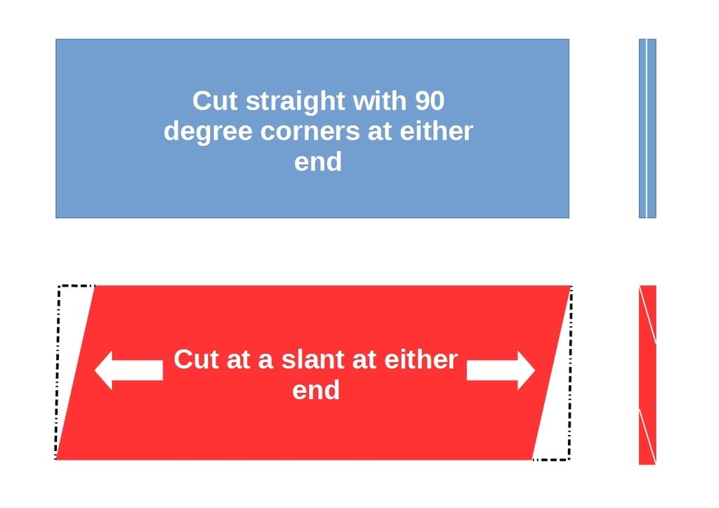

I saw this thread and your efforts with the cellophane film. I noticed on my regular duelling blade that the edges of the diffusion film doesn't form a seam running the length of the blade. It actually winds around the blade like the slide on a Helter Skelter. I found that if you cut the short edges of the film at an angle (forming an elongated parallelogram) the seams then spiral round the shaft of the blade. I experimented with a sheet of paper and a dowel first. For the cellophane you will have to experiment (use a sheet of newspaper) to find the best angle to cut the film to make the spiral less noticeable. I have included an image to show what I mean.
I believe this should work but as I mentioned just experiment first with a sheet of newspaper but you should be able to get a loose spiral effect which I think is less noticeable. You may also need to secure the cellophane at the tip and near the base. I hope this helps.
