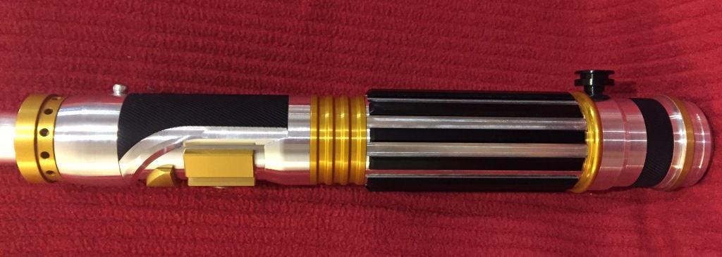

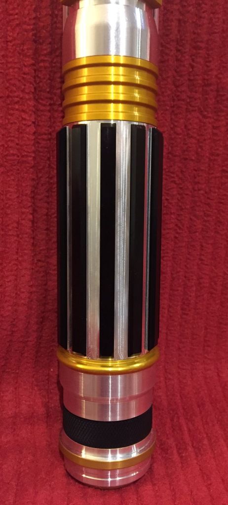

It's very close in resemblance to Mace's hilt, a stunning mix of silver, black and 'electrum' gold.
It's an ornate hilt, with a lot going on - sometimes, as we shall see.
There are various options available when you buy the Electrum Wind, one of which is the rounded or raised 'chamfered' grips. As most seemed to be going for rounded grips when I ordered mine, I thought I'd be nice to you all and go for the chamfered grips Wink

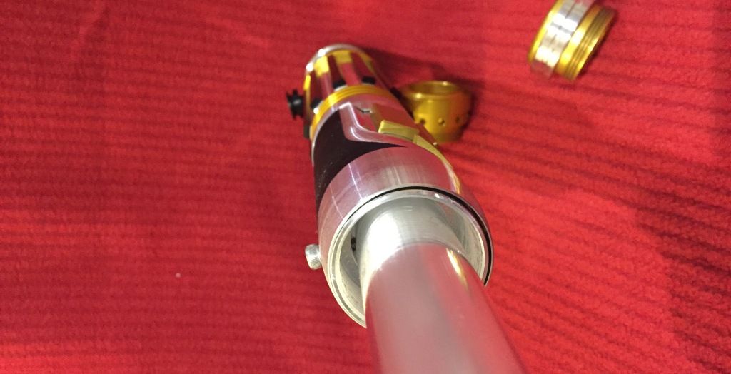

Both the pommel and emitter are MHS compatible pieces; Remove the emitter, and you can see the set screw poking through the hilt and holding the blade in place. Note that the emitter is only the golden part at the top of the emitter - it cannot hold a set screw, but could cap a multi-part emitter like the Menace, I think.

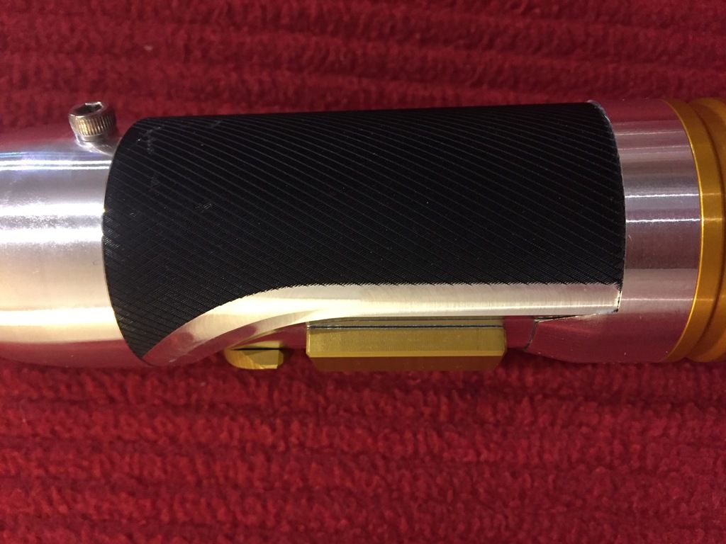

The black hashing is fascinating to me. There are a series of diagonal lines giving grip around the black section to the rear of the hilt, and also just above the pommel. This isn't plastic or rubber, rather (so far as I can tell!) this has been cut into the aluminium itself with the hashing anodised or powder coated. You may be able to see the slight overlap of the colouring where some of the lines meet the plain silver area.

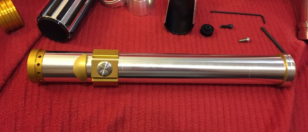

So, this is the hilt with the emitter and pommel removed but... can we go deeper?

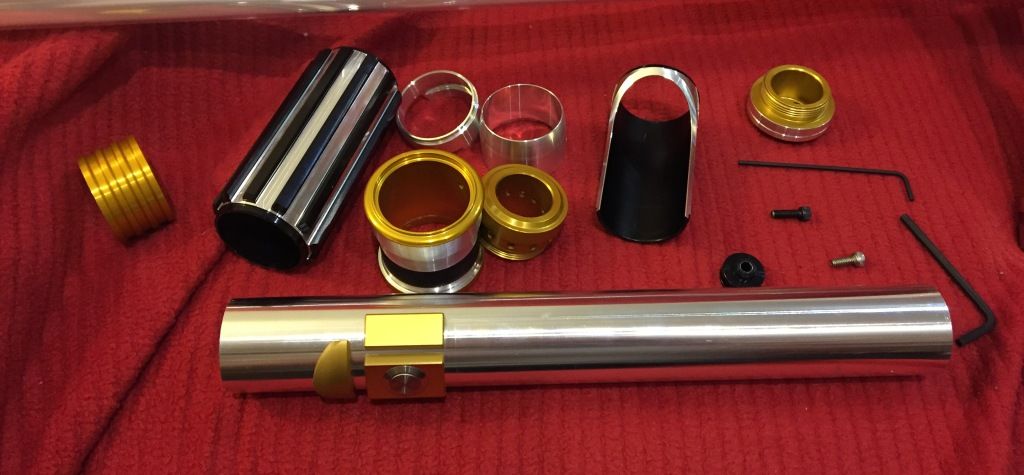

Remove the set screw and covertec wheel (chunky hex key, common to various hilts) and the screws holding the grip section in place (very skinny hex key, unique in my experience to the Electrum Wind) and you can start removing other parts, too.
In fact, including the emitter and pommel the hilt is made up of 10 parts, and only 4 screws.
There's a lot of friction holding things in place, and having disassembled it once, I have a slight rattle due to the speed at which I put it back together. It'll take some getting used to, I imagine.
Indented on the rear to let you line up the screws

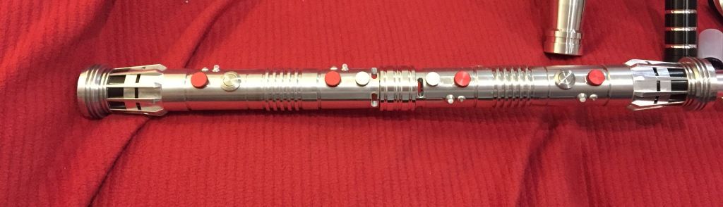

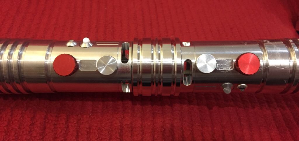

The quick release coupler is awesome, simple as. Working like a Hozelok adapter (do you guys have that outside the UK?) you pull back on the outer section to pop the staff apart, or rejoin the two halves. Simple as that.
The staff isn't fixed the way it is with an adjustable coupler; It will twist in your hands, but it's a quick release coupler!
And, at last, my Menace staff is complete!

Good little notes on the coupler. Think I saw a hose lock adapter advertised here before... Don't see it in stores much though. But the concept seems simmilar to an air hose fitting.

I'm intrigued about the black textured area's even more now . . . to see the upper part black on inside seems it has been anodised or coated then part machined away to reveal the silver again, but the lower piece above the pommel is gold (including the inside) / silver AND black in one piece ? . . . From your pics it looks like the covertec HAS to be in place (or a similar screw of some type) or that lower piece would freely move around ? . . . And the other pieces are held in place by the screws holding the grips at the bottom and blade at the top . . . I'm also more intrigued how the gold switch parts are held in place ? . . . there seems to be a gap underneath them making it look like they have been attached some how ? . . .

So, the emitter wont work with another saber, or it will, but only for display, since you don't have a retention screw... Well, you can still try other emitters on the electrum wind body, and you will also have two retention screws to give more stability to the blade...

The black textured areas intrigue me as well. I have a guess that it's a slightly larger diameter alluminum tube that's been spun on a lathe with a special tool to create the texture. Then it would have the precise section cut from it to make the arc that fits the switch area. Annodized black. It's then carefully ground in certain places to get the silver parts.
But that's just me speculating.
Hmm... depending on how thick the metal on that emitter is, you might be able to find a screw with a certain thread spacing and drill a few of them through a couple of the tiny windows spaced around the emitter. That would possibly work, but might marr the finish on the inside of the little window holes.

It looks like anything between the parts that are held in one place by blade set screw and the covertec wheel screw will then be snuggly fixed in place by the grip shroud which is adjustable along the back channel on the main body for a proper pressure fit of all the parts above it.
What amount of time it would've taken to figure out how to put this together and have everything machined right is impressive.
