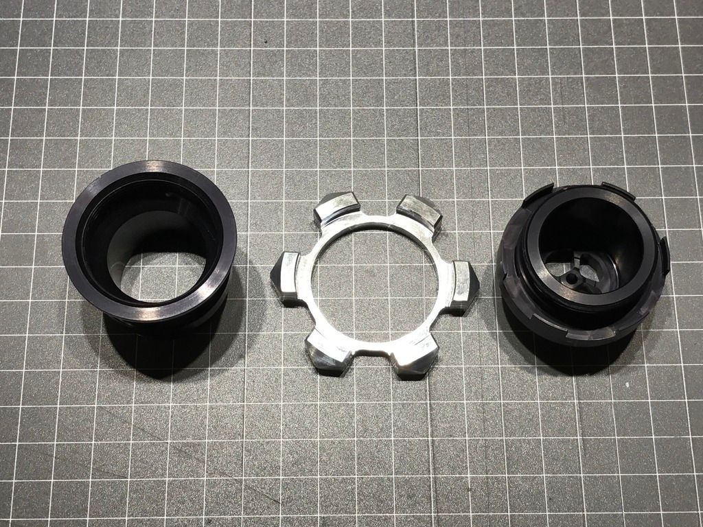

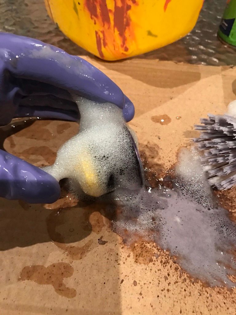

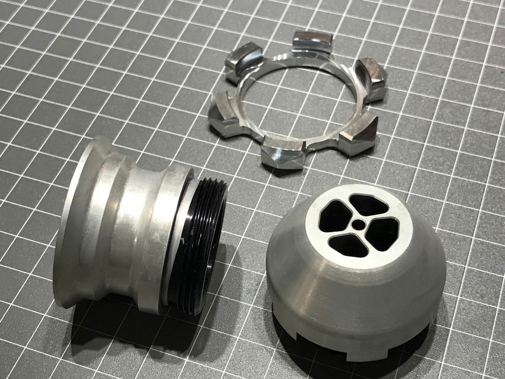

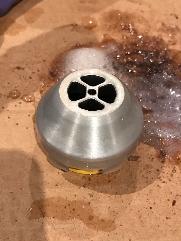

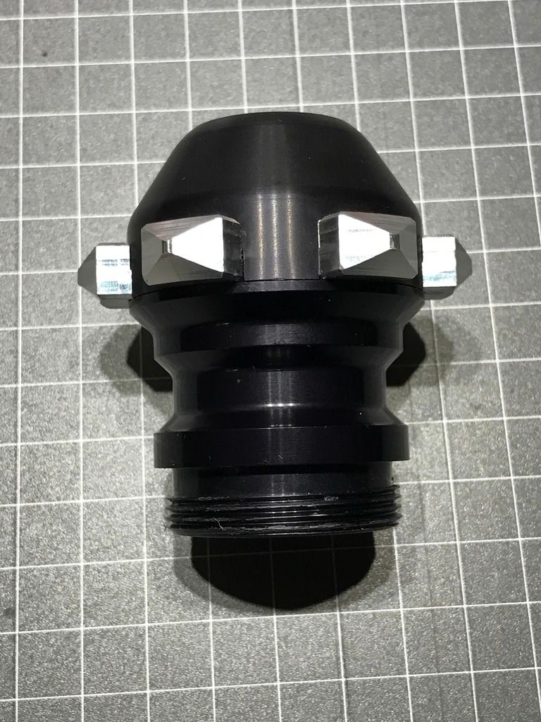

« Reply #13 on: March 04, 2017, 02:48:52 PM »
Ok . . . just to add to firehand10k's AWESOME process . . .  Cool
Got my MHS Scorpion pommel . . . and I checked under our sink, here in Oz we had some Mr Muscle Heavy Duty oven cleaner . . . thought I'd give it a go, and take a few pics . . . I didn't have any time for polish yet, but here's just some quick pics of what I did, this literally took me a bit over half an hour . . . sprayed on oven cleaner, left for 15 minutes, then used the foam to scrub with a brush, and rinse in water . . . fairly simple really, now I just have to give it a polish  Smiley
I taped the threads with electrical tape, and you can see it protected that area quite well . . .
