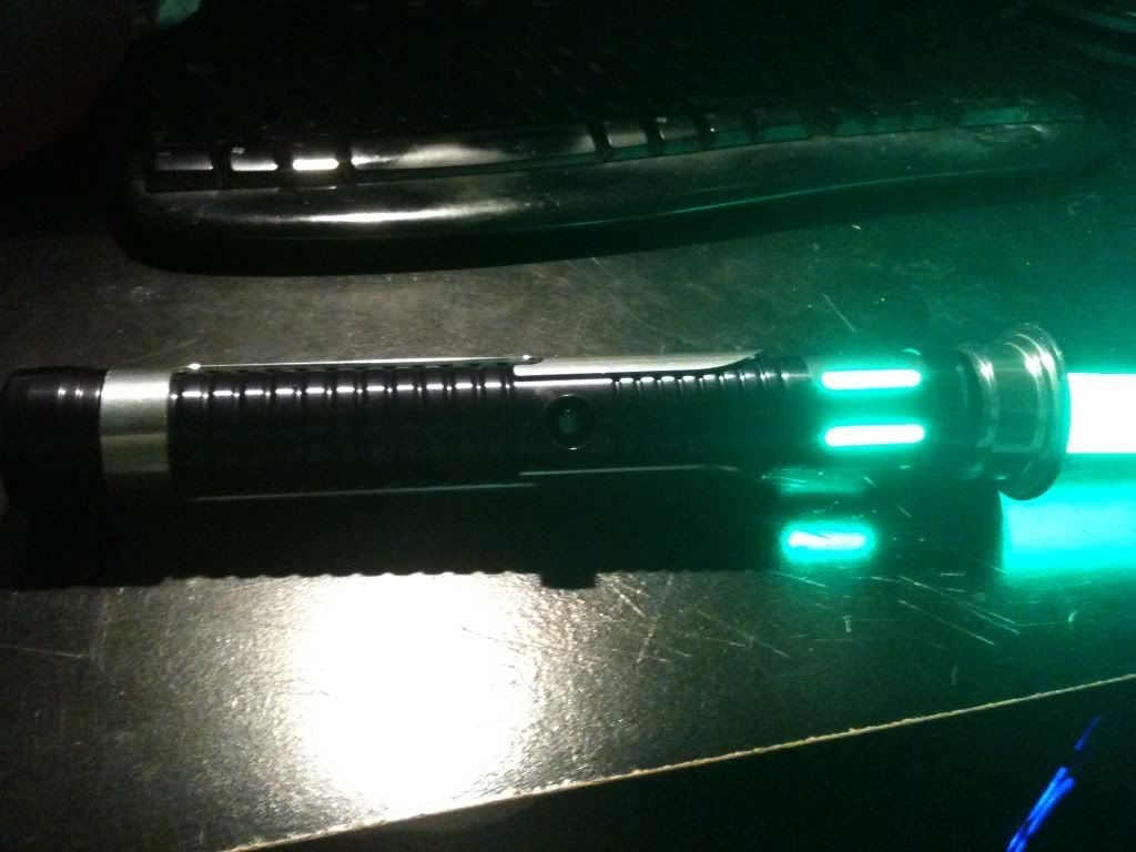

I am doing that to my Dominix v2 now actually.  I bought a Dominix  v2 LE about a year ago, and just with the Halloween sale, I was too late for an Aeon LE (WILL BRIBE OWNERS FOR BODY ONLY!!), *and* for the Dominix v2 LE, which was my "Plan B."
My trick was simple:  Make a lathe with a 1" wooden dowel (which shimmies down a gutted Dominix snugly), and cut the head off a screw, put that in your drill chuck, put dowel with Dominix through milk crate diamonds, screw the drill-screw into the dowel nice and straight, and with a half round needle file, crank up your drill speed, rest file in grooves, very little pressure and time is needed to make the LE.
If my %#@!& camera was working, I'd post pics.  But, it really is simple man.  I'm cutting out "windows" in the emitter section of both of them, one is almost done...

check out my most recent posts, the windows are mostly done, just got wet/dry sanding to do to polish it all up nice...

Looking good!
