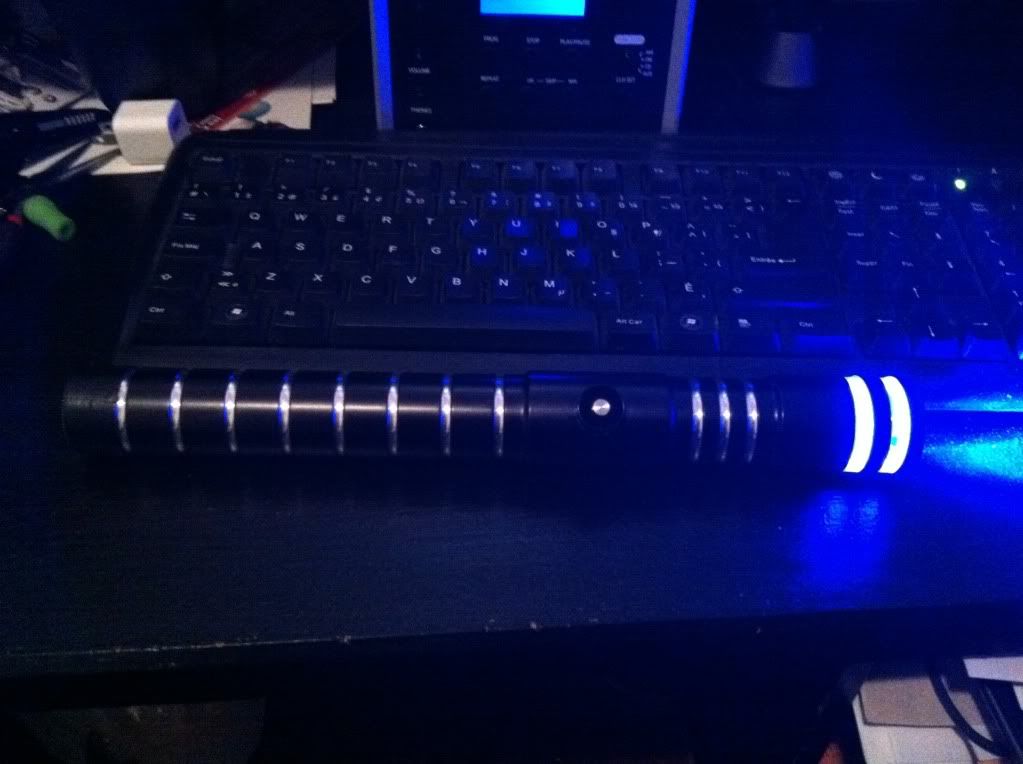

I just wanted to share my modded Dominix V2.  Grin
I added an econo soundboard to it and modified the emitter

Very nice mods indeed those cut outs on the emitter really give it a whole new look.  Cool

« Reply #2 on: December 22, 2011, 04:59:30 AM »
That emitter looks great. Point!

« Reply #4 on: December 22, 2011, 02:54:10 PM »
Thank you!
I really enjoyed doing this and I'm pretty happy of the end result.
Great work! Man, I didn't think econo would fit in one of these. If I hadn't already gone through heck getting it into my Prophecy V2, I'd totally try it on my Dominix. lol
This one has a Qui-Gon econo soundboard. With the size and shape of this board, it was a perfect fit in my Dominix V2, I had no problem doing the modification.

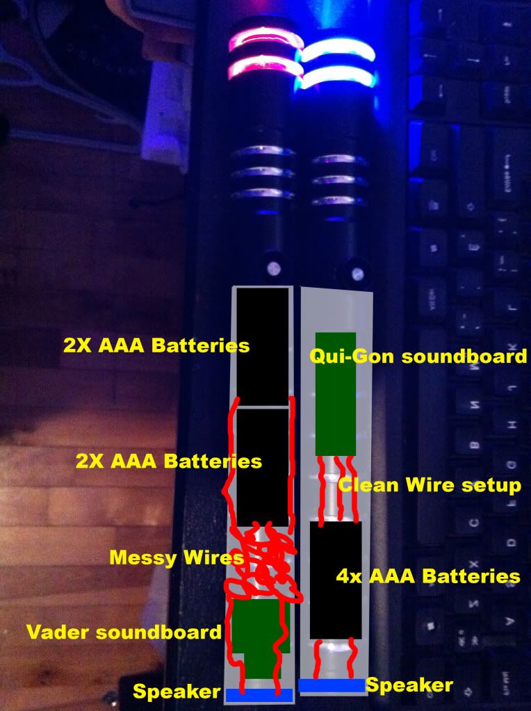

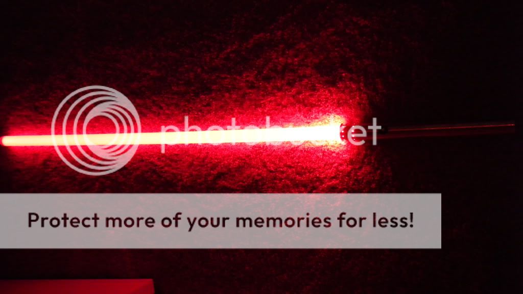

I have finaly finished the one with the Vader soundboard. I have attached a quick made diagram to show the difference between the setups I have in both Dominix, maybe it could be helpful for those who want to give it a try.
<a href="http://www.youtube.com/watch?v=GgoD_Jvjb0Q" target="_blank" class="aeva_link bbc_link new_win">www.youtube.com/watch?v=GgoD_Jvjb0Q</a>

I understand where to put the soundcard, but how did you get it in there?  Did you carve grooves into the hilt aluminum like I was thinking of doing with mine (when I get around to getting my 3rd vader board), or did you just force it in there, making it support itself?  Very nice, both of them!  Point for the vid!

« Reply #12 on: January 03, 2012, 06:21:36 PM »
Dude, I'm not loling at you but the "Messy Wires" illustration is brilliant. Grin
So is the Vader board really small like that?

« Reply #13 on: January 04, 2012, 12:47:30 AM »
The location of the vader soundboard on the diagram is the best place for it. The soundboard got in really flush, i was actually sweating trying to get it in Grin. So i guess it count as forcing it in. I could not put it elsewhere because at some point the hilt gets  more narrow inside.
