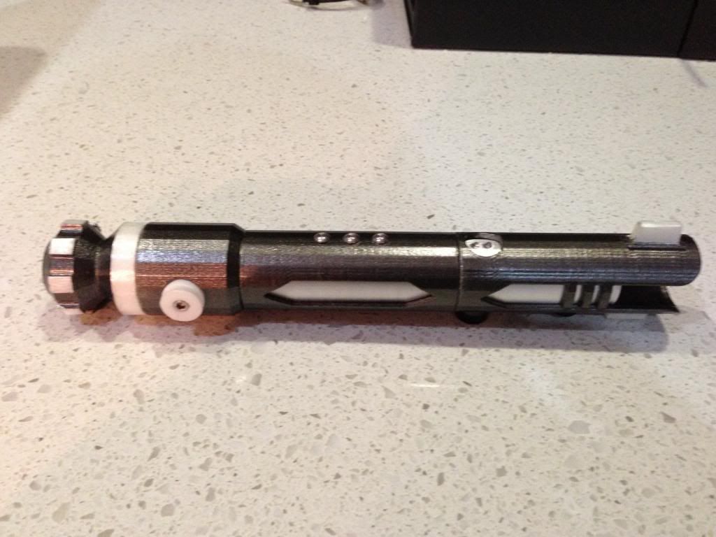

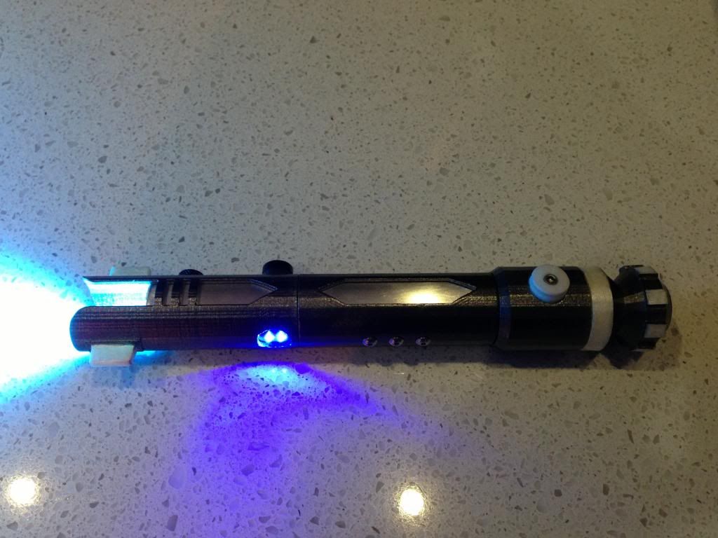

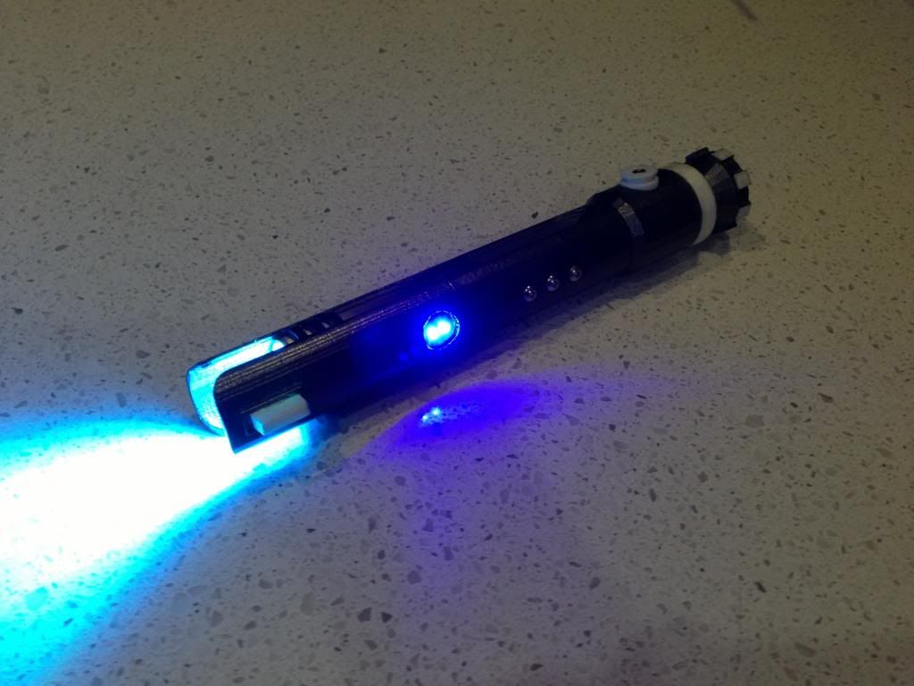

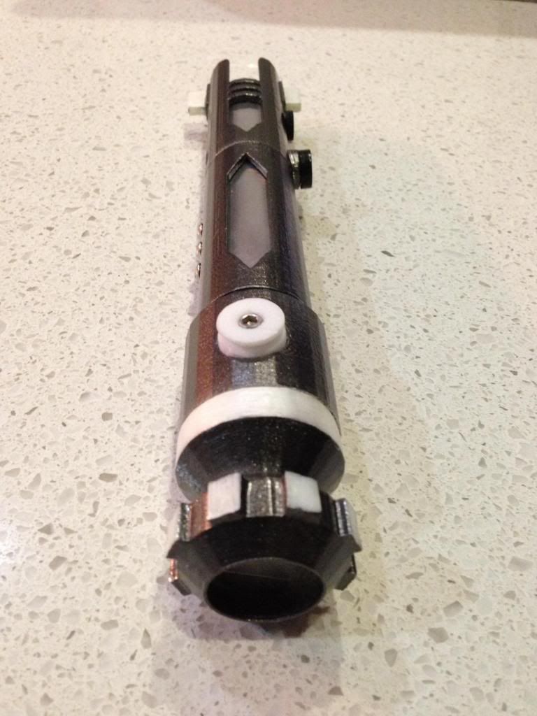

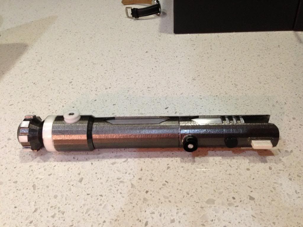

I have been playing around with a 3D printer and design and finally finished a saber. The design is based on Ahsoka Tano's lightsaber (not exact replica). It's a stunt I built for my niece.

Thanks guys. I am happy with the finish. If I wasn't so lazy I would have sanded it a bit better before painting, but its for a 10 yo so I figured she wouldn't care. Amazing what you can do with google sketch up and a 3d printer. I am working on customising an LE Dominix V2 now, planning for a SY blade

Zren -  I use a 32mm OD aluminium tube as the core. You could use sink tube too. You can then design sleeves in a 3d sketch program to be printed. They slide over and viola, it's done. I design the screw holes in the print so they act as a guide for drilling into the aluminium. The pommel has a sink tube cap screwed to it so it pushes in and out well. The most time consuming part is the design process. I get lots of ideas for a pommel or an emitter etc but can't always fit them together nicely. That and I am a novice on the 3d software.
