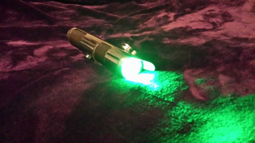

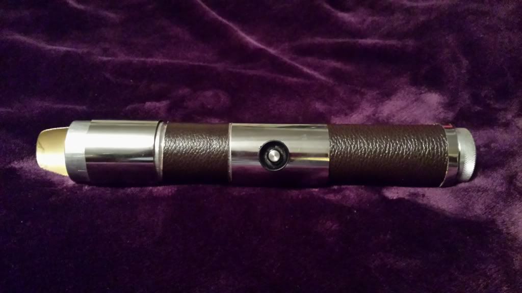

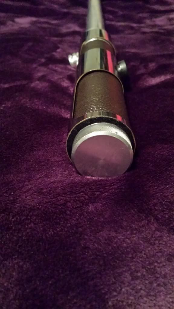

This was my son's first saber. Initiate V2 in CG. It had a busted battery pack and has not worked in quite some time as he is now partial to his Dark Liberator V2 in GB. I decided to rework the wiring. And add in QDs. I also found a sink tube at Home Depot that fit it well. I cut down and trimmed the tube into a shroud. I added leather to the grips. I added a Covertech wheel as a retention screw. And to fit the back of the shroud fit the saber I used some thick felt. It is still completely combat ready.

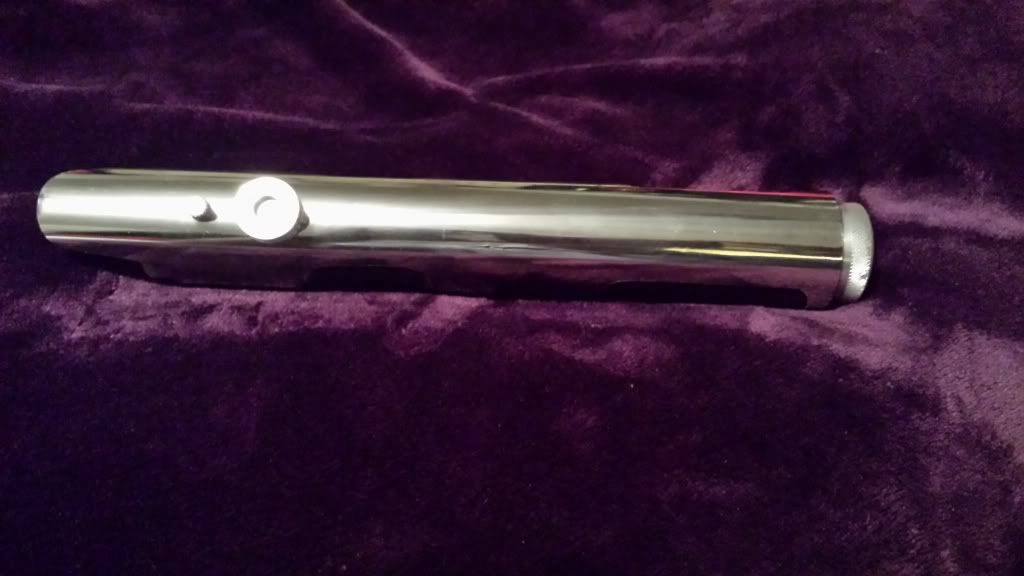

I plan on doing a simular shroud for one of my Dominix V2. I'll break it down in pics for that one. I didn't take many pics for this shroud.  Basically I took the tube and set it beside the saber. I put tape on the tube for marking. I marked where I wanted the cuts and I used a band saw to make the cuts. I'm not very good at working with metal, but I work with many people whom are. One of them cleaned up all the edges, and then I slipped the saber in and measured for the switch hole and carefully drilled it out. I put the switch in so I could measure for the retention and mount hole on top. The retention was a 8/32 tapped hole while the other hole was 6/32. I had no idea how to measure and drill the holes. Another friend at work did. He used a simular method as I had for cutting the tube. He taped it off and took measurements as the saber was placed with the switch in, and marked and drilled them. I had the Covertech wheel with me and found the other mount screw at work. I had the leather as well, it was a piece of scrap I had the luck of finding a few weeks ago. Once assembled there was a small gap, roughly 1/16 between the shroud and the base of the saber where the pommel goes. I found a roll of thick felt like material that had a peel and stick side. I tried that down and fit it into the base of the shroud. Then installed the harness and components.
