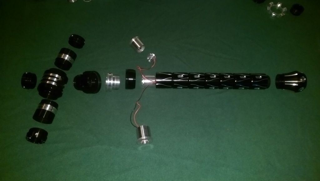

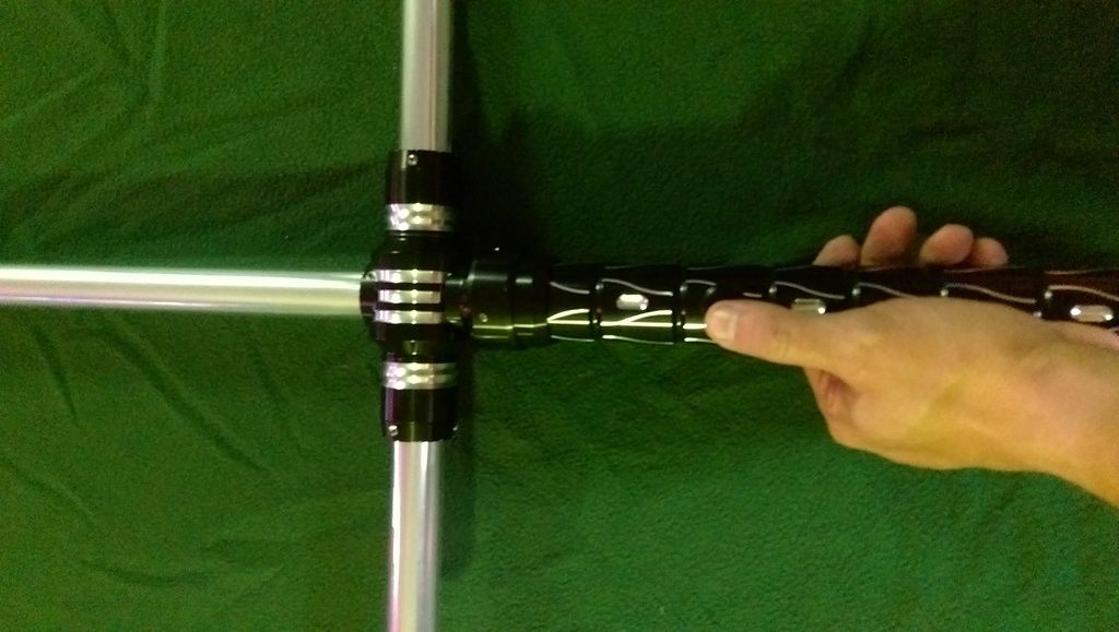

So I decided to break my Flamberge down as far as I can without (maybe) invalidating my warranty.. that is the next step Wink
Before:
Looking down the throat.. you have to remove the side-LEDs from their housings in order to get this far..

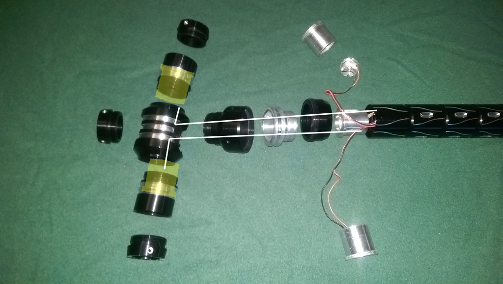

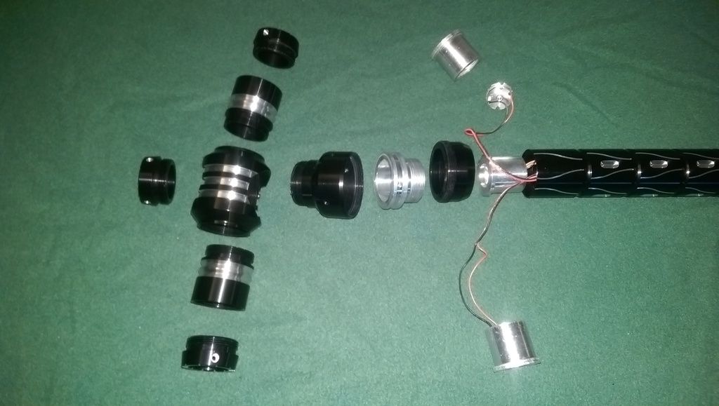

The full exploded view..
Slightly zoomed in exploded view..
Next I'll be snipping the side LED wires so that I can use the body and pommel with various other MHS parts.. as I like to constantly tinker with my sabers.

How exactly to the led modules seat in the emitter section?
Sent from my SM-G360P using Tapatalk
kaanapuchris
Force Alignment: -53
Posts: 124
« Reply #11 on: September 25, 2015, 12:58:24 PM »
Also could you map out the wiring? Im working on a pvc build and want to seat everything so it doesent rattle around
magik0012
Force Alignment: 107
Posts: 730
« Reply #12 on: September 28, 2015, 04:58:44 PM »
Well.. my Flamberge has been permanently disassembled for quite a while now, so I'm kind of operating from memory here..
The LED's for the side blades sat inside the 1" (?) extension piece and were basically held in place by the side blades if I remember correctly.
So.. something like this:
6" blade >into> side emitter ring >> LED >into> 1" Extension >> center barrel piece << 1" extension <into< LED << side emitter ring <into< 6" blade
As for wiring, I can't tell you much other than the wires from the side LED's were taped to the inner sides  of all the pieces of the cross-guard below the barrel.. which is one of the reasons why you have to be very careful when taking it apart.. if you just start unscrewing things willy-nilly, you are going to break some wires quite quickly..
The main LED housing had notches on the sides of the lip that allowed the wires for the side LED to pass down into the hilt where they were spliced into the wiring for the main LED.
I'm not sure if that helped at all..
