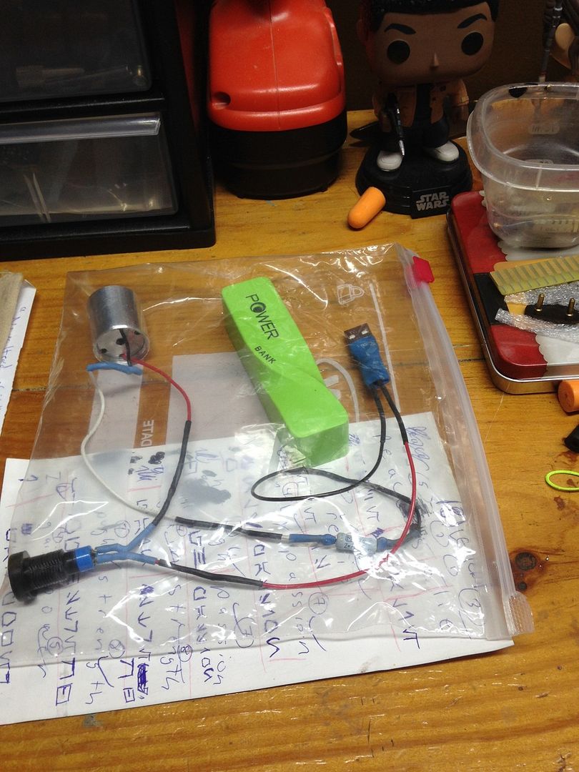

Got the power bank in today Smiley.  Originally it was just going to be burried inside the hilt (obviously lol) but now that I'm holding it, my wheels are whirling involuntarily lol!  I'm surprisingly thrilled with it, not that I expected it to be terrible or anything lol! but I've always just thought about it as a practicality... Like I mean, what excited me about the bank was the functionality of it/ incorporating it into build- but I didn't expect to be inspired to make it contribute greatly to the overall look of the project.

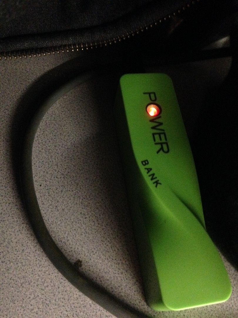

  I must not have looked at the pics of it closely when I ordered it (was more concerned about dimensions and specs) - surprised to see that it has this huge/ and surprisingly bright status indication led cleverly located in the word 'power' on its front face.
Don't worry, not breaking the add rule- that's not the brand/ company name- evidently the creative juices just weren't flowing the day they had to decide what to have printed in bold letters across the product lol!  Or like maybe the big boss was just hungry at that meeting lol: "Hmmm... 'Power Bank'... I like that Johnson, let's go with that.  Lunch time people."  Lol.
The light glows bright sky blue when discharging power to device, and a deep red when charging.  The charging pic was taken under some industrial lighting, so I tried to block it out with my sweater so you could see brightness.
So the new game plan is to secure the bank in exact/ permanent place via tapping and black set screws and spacers mounted inside hilt, and cut or drill a window into the hilt to allow a mini cross section type view of a tiny bit of the battery bank (where the light is) gaining an extra 'freebie' accent led of sorts- when my sabers on it'll shine bright blue, when it's charging, a deep red.  Really excited about this- combined with the legit red accent I'm mounting in the old switch location it's gonna look sweet!  it'll really go well with the look of this crazy sith splicer saber to have another blue/red light peeking out down there, and the look inside to the actual power source jives with the mad science project too Smiley.  Keep you posted- just waiting on a small truckload of variable resistors of diff mA values which will be in any day now, then I'll have everything I need to finish!
I'll ding the rest of the engraving off in the meantime while i wait for the last components- prob be done this weekend, then it's on to the wiring.  I've got another small detail to make for the body, but I'm holding off until I know 100% where I'm putting the switch, in order to get the best placement.

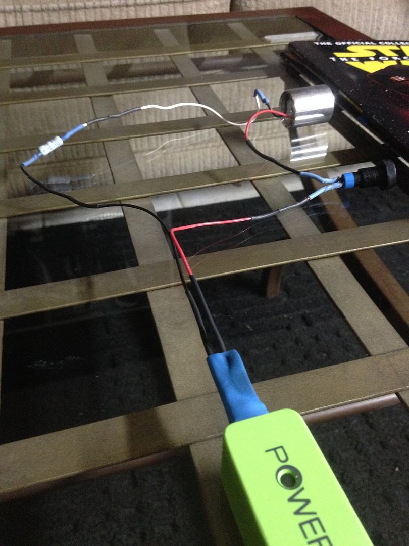

Thanks blackrock, I've only gone back over some of the engraving with a scribe- the rest is just roughed in with an electric engraver.  I'm really happy with how the combo of electric and manual engraving tools is turning out, once I've touched it all up it'll look really nice Smiley
Thanks for the input Bulvoy- I'm really torn, so good to hear everyone's opinions Smiley.  There's things I really like about both accents.  Can't wait to be able to cut one in!  I got everything all ready n waiting for that now, so will be pretty quick/ easy once resistors arrive:
Was every bit as easy as CJ Nihilus said it was when he showed how to do it in his thread about 'the best battery set up for stunts'.  You simply cut the back off the end of a usb cable to access the pins and solder the leads in place and its in the bag:
