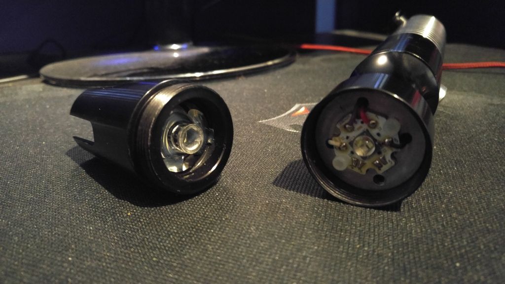

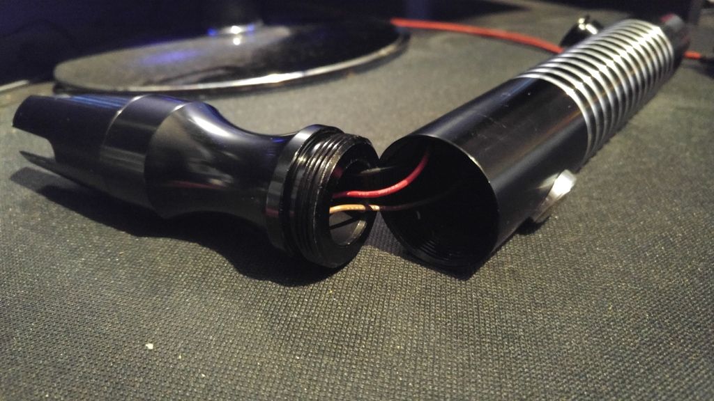

« Reply #7 on: November 11, 2016, 04:44:04 AM »
Ok, so the Catalyst.
Racona Nova is quite correct.  The LED is in fact in the neck.  The lens/optic is in the emitter however:
Undoing the thinner neck, or choke shows this though:
I'm thinking a QD would be possible - difficult, but possible.
You'd just need the same sized LED star.
