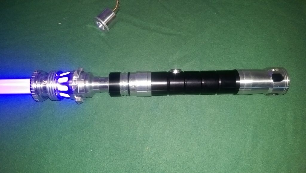

I thought it would be good to have a thread dedicated to installing a clip to your saber yourself.
- Post questions you may have.
- Show of your work.
This is a relatively easy modification and pretty high on the list of things to a perfect saber. Though it can prove to be frustrating or even tragic.
TRIPLE check everything:
Before you start drilling holes make sure your electronics are out of the saber and will fit when you put them back on.
ALWAYS start small and go bigger:
You can drill bigger holes for your screws but you can't drill smaller ones.
I attached a clip to my Raven today.
I do plan on ordering a metal one from Ultra with the curved bottom so that I don't have to use the washers I've placed in there.

UPDATE!
This is the clip I brought.
As Darth Raze suggested in another topic. I had to modify the clip to compensate for the size difference in the metal wheel from Ultra. I just used a stanly knife and now she clicks in fine! REMEMBER Make smaller cuts, you can cut away more but once it's gone it's gone so do little bits, stop and check and go again if you need to.
If you do get this clip you'll need to undo these four screws to cut it up properly. Note that the two top screws are a different size to the two bottom ones do you may need a different sized Phillips head.
Also please note that the wheel does NOT completely for the Raven 100% there's a few mm's difference between the rings on the hilt so I had to file it down as you can see. AGAIN REMEMBER start small, you can always file away more but you can't file it back.
Fits perfectly!
I'm very happy with the end result.
May the force be with you in your own attempt at a DIY Covertec Installation.

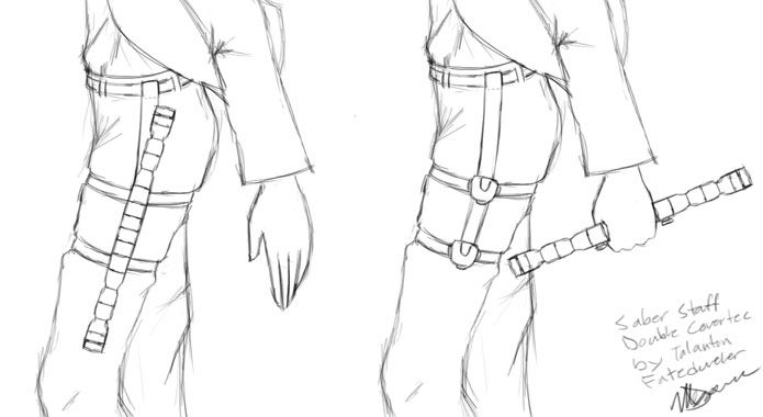

This looked like the best place to post this.  I wouldn't want clips on my own saber staff, since I want to be able to move my hands freely up and down the hilt, but I thought of this a few days ago.  Since saber staffs can come apart to make two sabers, each separate hilt would have its own clip.  Having two clips keeps the saber from turning, making this drop-leg type design possible, which I opted for to compensate for the greater length of a staff.
Put a bit too much detail into this, but I needed practice drawing cloth.
« Reply #12 on: December 13, 2011, 12:07:44 AM »
Firstly: Awesome sketch!
Secondly: I think I'd like to try this on one of my hilts eventually. No idea which one. But I love the idea and had thought about it before, but I never thought of a good practical way to make a 'low slung' saber rig. Bravo!

« Reply #13 on: December 13, 2011, 12:56:46 AM »
I love the thigh mount concept.  If you get it working let me know.  One flaw: the covertec clips actually CLIP the knobs into place.  So you'd have to have two hands squeezing the clips to release the knobs and a third hand removing the hilt.  If you can find a way around this let me know and I'll be sending you a check to make me one of these bad boys.
« Reply #14 on: December 13, 2011, 01:06:10 AM »
In theory, some sort of hard framework to keep them connected would make it function properly. IE: One strip of metal connecting the two thigh ties with the clips on them, so the metal keeps the clips lined up straight constantly, and then you would just need two rods or something of some sort to connect the squeeze parts of the clips. Then you could squeeze the two rods in the approximate middle of the hilt, depressing all four release buttons at once, and pull the hilt off!
I just wish I had the leather and metal work experience to try this myself! MAN it's a great idea!
