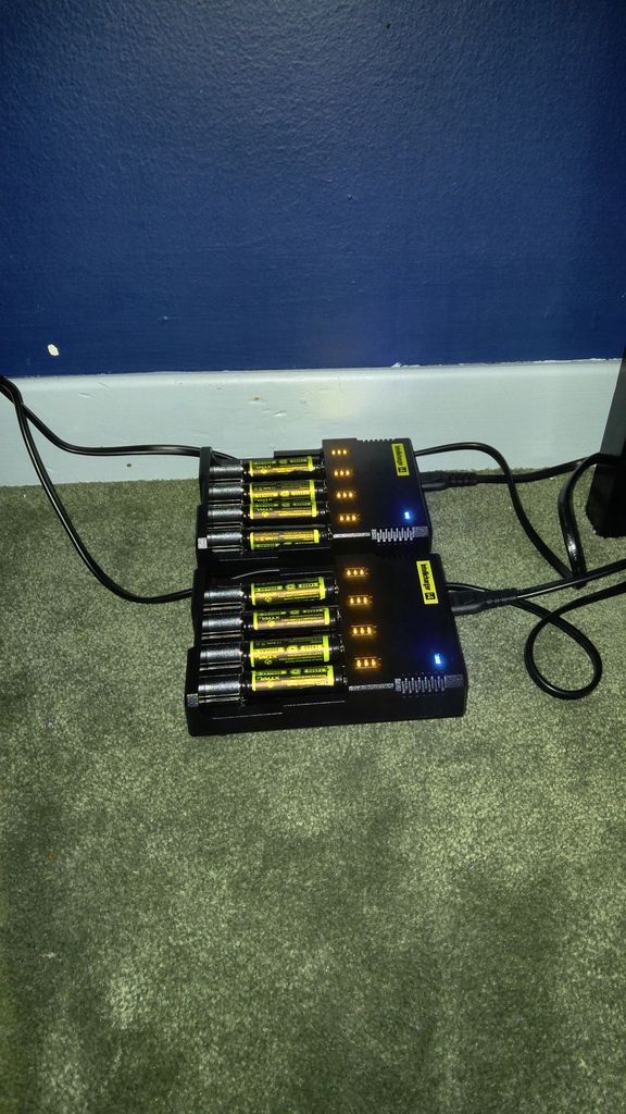

« Reply #252 on: October 15, 2016, 01:10:59 AM »
A while ago a forum member whose advice I value greatly recommended the Nitecore Itellicharger i4.
I ordered two of them:
