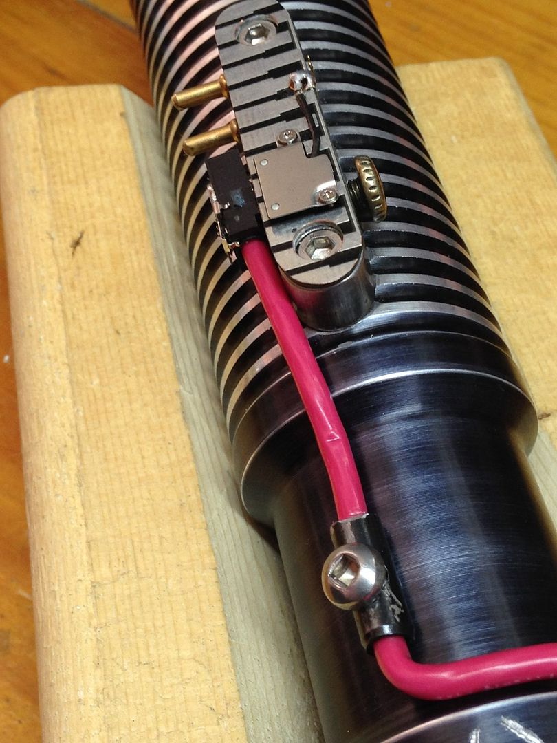

« Reply #81 on: April 06, 2016, 02:11:43 PM »
Hey Greg Smiley.  The idea was mainly for looks- I've been studying a lot of ref pics of kylo's hilt for a build I'm doing ATM, and the influence krept in- also I'm going to have to do a lot of this stuff for that kylo build so this mod was a way of testing ideas before hand if you know what I meAn.
At first I REALLY wanted to run one or two of the functioning leads there, but after a ton of testing I had to give that idea up.  If this saber was gonna be a display only, 'shelf queen', then I would have 100%.  But since it's my main dueler- it would have been too delicate/ liable to cause problems.  About the thickest wire I think anybody would ever use on a saber is 18AWG, that's really thick- the kind of heat you need to get that wire to take solder would almost certainly transfer up the wire and burn components if not using a soldering heat sink.  And if you tried to solder it to a board, you'd inadvertently bridge all the pads in the area just because the wire has such girth lol.  Most ppl stick with 26/28AWG, maybe 24 (what I used)- which is drastically thinner/ flimsier.  This thinner/ flimsy wire, even with a bunch of bracing on the outside of hilt and even with a bunch of extra slack sitting inside the hilt at exit/ entry points, would almost certainly get yanked all around too much.  Like even just from the squeezing of grip, over time it would start to stretch and pull and put stress on solder joints and connections to components.  And like even the 18guage, though arguably too cumbersome, bulky, and rigid to be practical for use inside a hilt, is still a tad too light for me to be comfortable with how it'd fair under that much stress.
The wire I'm using is 10guage, I think, or 12- King Kong wire lol- acts more like speaker wire or craft/ fencing wire.  Once bent to shape, it'll want to hold that shape surprisingly stubbornly, even when subjected to pressure.  You pretty much have to take it between two hands or in pliers and intentionally bend it to get it to flex.  It's perfect for this application, since it will pretty much stay where I run it, with a little bracing.  It'll hold up- and since it's not functional, it's no biggie to just patch up as needed Smiley
And thanks Zren Smiley.  Exposed wire inside ANY hilt would be bad, since the hilt walls and most components are metal- but there's actually nothing in particular about this hilt that'd make it especially dangerous/ vulnerable that way.  Actually I've all but eleminated the risk by trimming back any threads flush with the inner walls so nothing sticks down into hilt at all except for the power bank set screws, which I have concealed inside plastic bushings so no exposed metal Smiley
Picked up those set screws- IMO looks way better without that big ol' silver button head sitting on top Smiley
Keep you posted, MTFBWY.

« Reply #82 on: April 12, 2016, 01:06:54 AM »
Looking great bud

« Reply #85 on: April 13, 2016, 03:31:52 PM »
That red wire tho!!

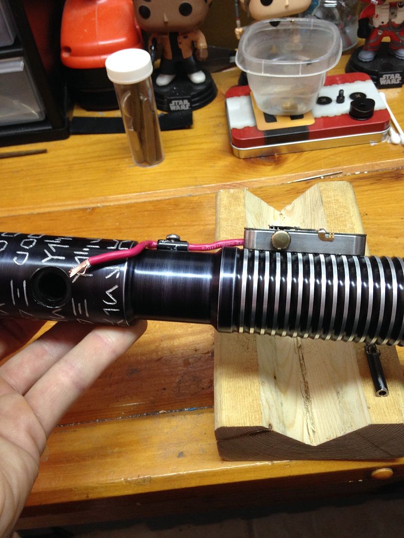

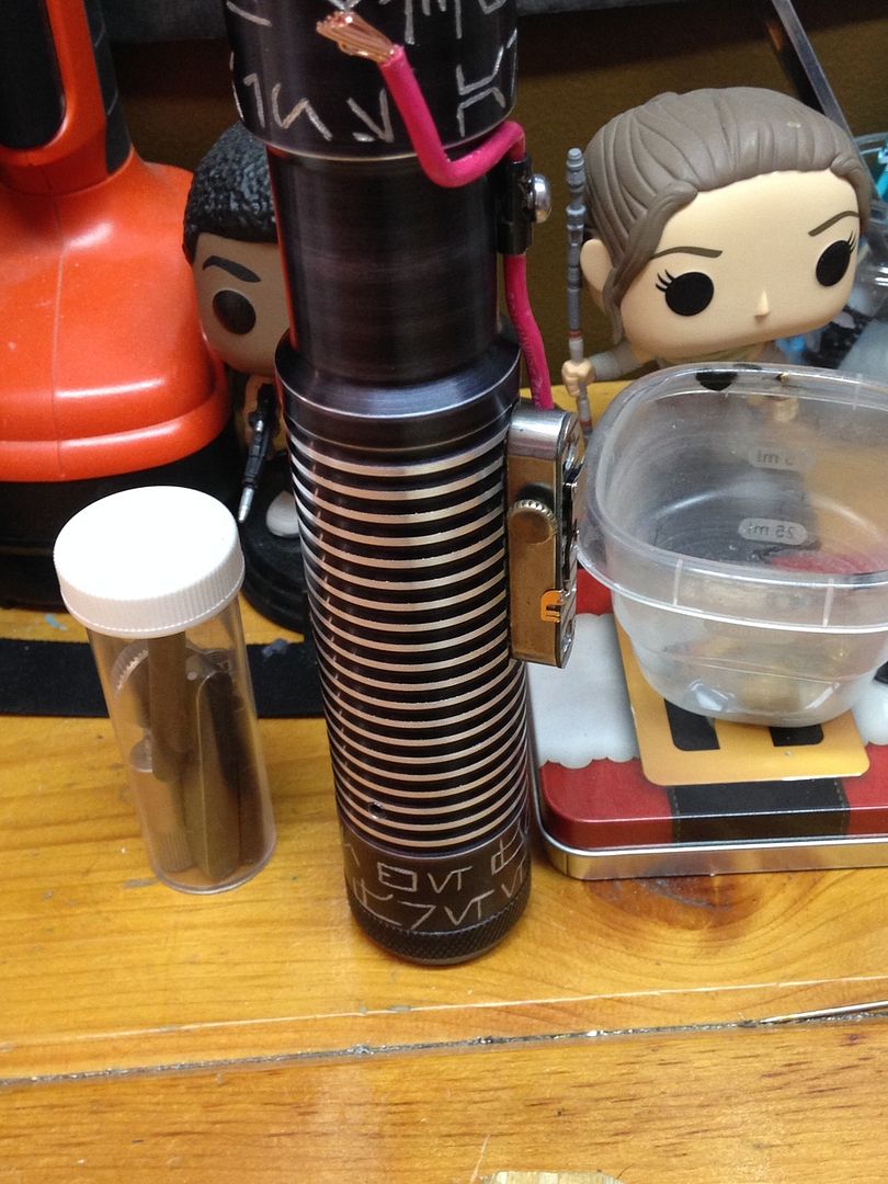

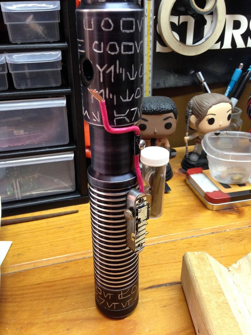

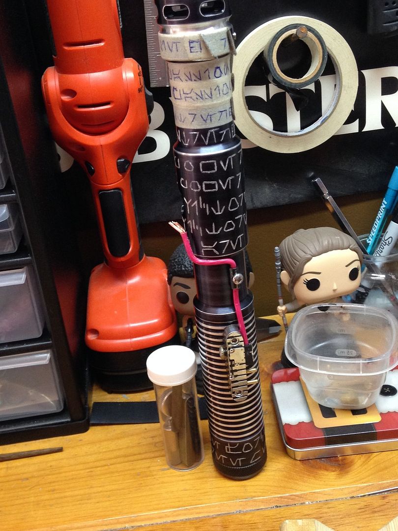

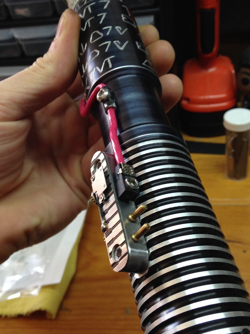

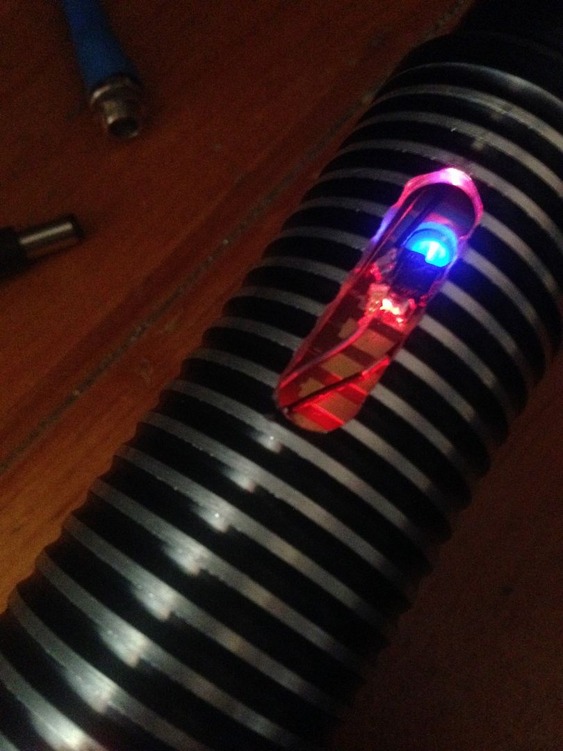

hi everyone Smiley
well, again i have to say sorry for the quality of this vid- my phone died so had to take on old i pod with terrible camera that couldn't even get to focus lol.  was just running too short on time to do proper treatment, ill update the log proper soon.  but just to give you quick rundown anyway.  been playing around/ experimenting for some of the final little touches- at least what i can do until I've got everything handy.
https://youtu.be/DevAOsU9zpI
i couldn't live with that terrible camera lol, so heres a couple at least from my phone while was charging, so that at you can see a focused shot of the area:
will post up a clearer, more organized look at everything soon- MTFBWY Smiley.

« Reply #88 on: April 16, 2016, 04:14:37 PM »
Sorry, been swamped with work n arlo, and also trying to get the training back in gear- I run competitively and do extreme races etc.
What comes next? Lol
HAHAHAHA- is that a subtle way of saying move along we're all sick of seeing this part lol!?  Wink.  That's fair lol Smiley.  But I think you really do have to stop and dwell on these little things, mess with over and over until you get just right, along the way as the situation demands.  A wise smith once said,"If you rush it you wreck it"- totally true.  i really have to test this before i can finalize, because I need to know if there's room in my bank's output for all these accents, or if the over draw of current will trip the protection circuit.   It'd be a shame to spend a ton of time doing this whole feature up, and to do some undoable things to the hilt in process, and then find out the bank can't run it lol!  But I don't have an illuminated latching switch handy yet (on way) to hook it all up, plus I need to wait for extension for sake of strategically measuring wire etc anyway, so I'm gonna just use the current latching switch, but cut in an extra accent to pose as the new switch accent for the sake of testing, and then connect EVERYTHING all up and find out what she can take lol.  Then I'll have the go ahead to finalize this bit, which along with the engraving and odd jobs mentioned in vid, should take me to when the last parts arrive Smiley.  Then hopefully I'll be doing the port!  Excited/ scared about that lol.

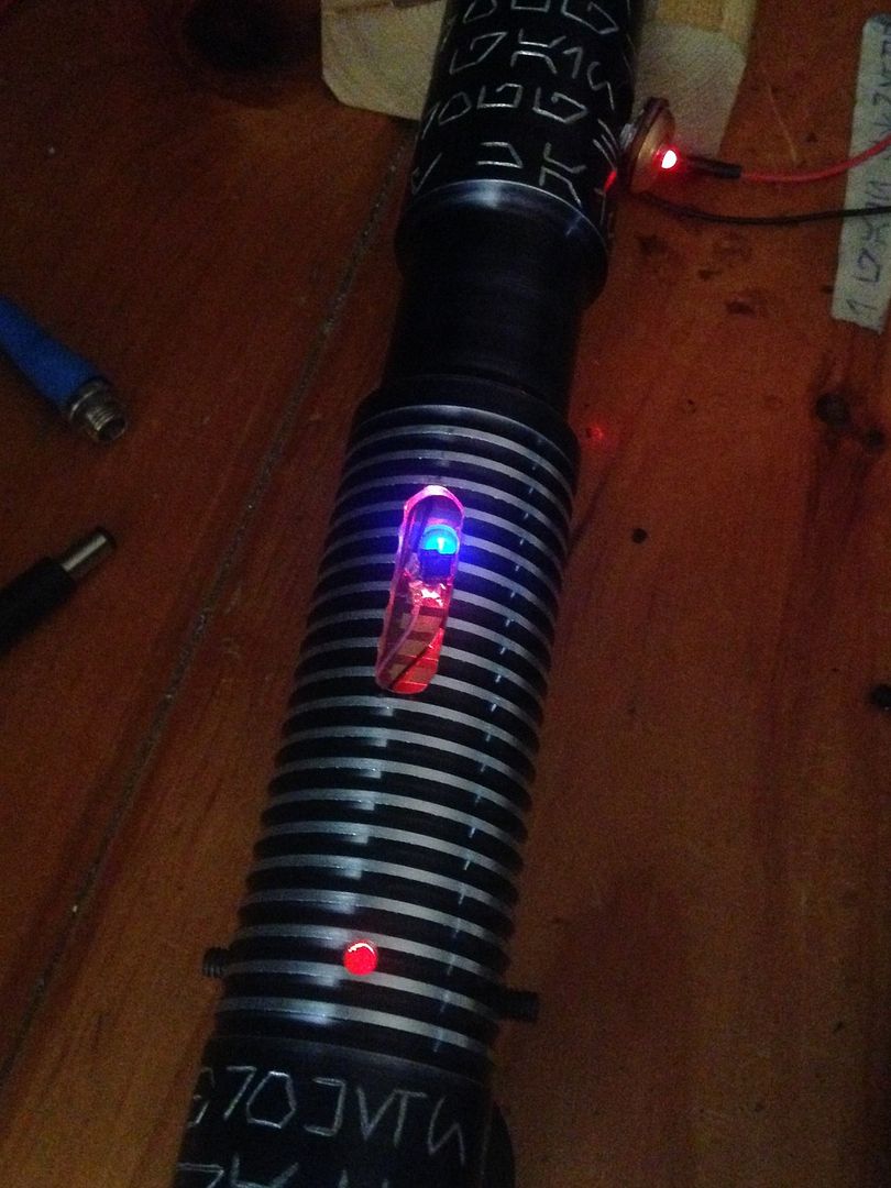

Was talking to the pros and Kouri pointed out that the 3V from my tester packs wasn't quite enough to get the DynaOhm to give the full brightness on the accent-  pleased to see what a noticeable diff he was taking about: popped in higher voltage 14500's:
Even in bright overhead lighting it's quite a bit brighter.
Be wrapped up today with obligatory stuff, but in evening gonna hook up that whole test- not looking forward to in way cause a ton of hooking stuff up that just gonna have to take right apart again after- but gotta confirm this idea will work 100%- anxious to know cause it's pretty wicked lol Smiley.  Keep you posted.
