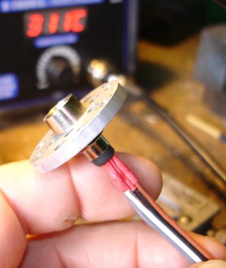

Finally had some time to work on this project the last few days(been raining & cold) I was looking around for a suitable material for chassis discs, I thought 1/4" polycarb would be good, but didnt order any (maybe next project) lexan is to brittle, sooo I "borrowed" one of my wifes nylon cutting board , took the hole saw & cut out 3 discs, which then were filed & sanded to the correct diameter
2 of the discs are for battery holders & generally rail/frame construction, I'm also using 4-40 threaded stand-off's for connectors with allen head screws to create the correct clearances
I also wired in 2 more sets of leds, I needed an accent somewhere to fire up after pulling the kill key, I used a very small clear glass crystal, made a round tube of brass mesh (soldered) & installed a purple 5mm led into it with some black heat shrink, it got mounted next to the main crystal & I'm calling it "the ignition control crystal" from there I also wnated the main chamber to be able to change colors & match the main blade color on each font & also to flash on lock up/blaster blocks, this is a 5mm RGB 4 wire that ties into the color mixing board to sink with the blade
still working out the chassis puzzle & getting close to wiring the board, I have all of 2/10ths clearance for overall internal length
to the point that the front chassis disc has a slot just for removing the sd card (you unscrew the hilt & pull it back 1")
here is the board with add on board mounted under it, getting close Grin

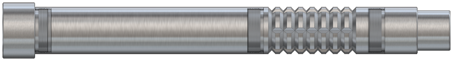

 And here is a simple 3-D scale rendering

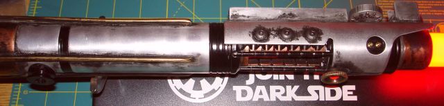

 Finally had some more time to finish my saber, here is the completed rail section ( I also added 3 purple LEDS on top of the sound-board top view with kill-key removed
the battery pack/speaker section removes with 2 allen heads& 2 quick disconnects my newly made razor blade plug with custom brass turbine center

« Reply #53 on: June 11, 2012, 01:31:30 AM »
Thanks again guys! Very little cram-fu was needed. I planned on getting a new camera soon, got a good excuse now.. I still have to set-up another sd card, I have bunch of fonts for this board I found online including a version of the TFU video-game sounds and a couple of silly ones (including jay & silent bob's bong saber with mark hamil quotes for boot up) I'll get a vid up soon showing the different blaster & lock -up effects (you could spend easily a few hours tweaking all the different paramters for the 9 font slots, this seems much easier to do than setting a card for a PC1.6, I'm stalled on my copper katana , due to my lack of computer skills, in the meantime I'll play with this one & work on some more summer hunny-do's

« Reply #54 on: June 11, 2012, 02:01:33 AM »
 ooops forgot to put up a pic with the back section mounted, & fired up
