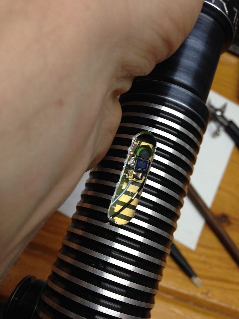

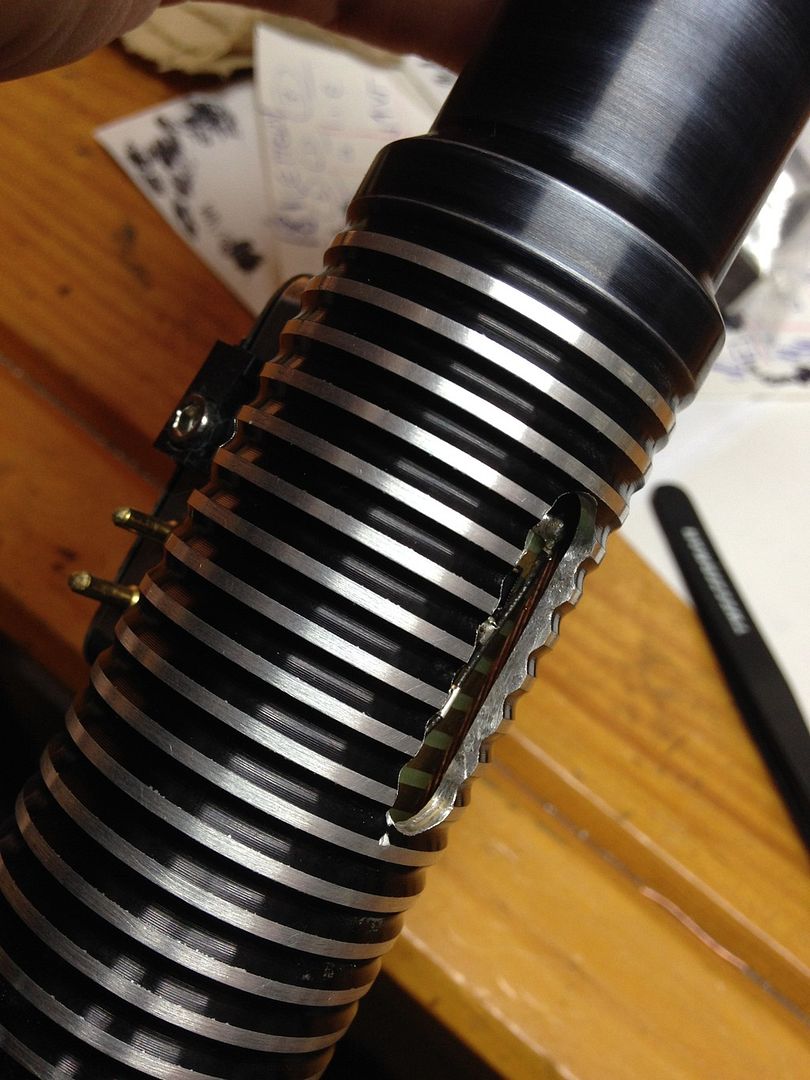

Thanks everyone!  Appreciate the encouragement and input Smiley.  Darth Arlo (my dog lol) is sick atm, so I didn't get much time for the project this long weekend Sad.  But I did manage to get a good start on installing the power bank- really happy with how it's turning out:
The best way I know how to make nice shaped elongated windows or grooves without a milling station.  Just drill holes for your ends and then cut out the area in between with a dremel and disk, then touch it up with grinding stones etc.  I lost concentration a couple times over arlo (my fault not his lol) and made a couple little scratches, but thankfully they're super shallow so I'll be able to hide them with blackener.
I forgot to take a pic of the bank all dressed up, outside of the hilt- I meant to.  No biggie I still have a bunch left to do on this part so I'll get that soon.  It's pretty neat- it won't really translate in pics, but I put a bunch of copper wire and details around the edges of the bank, so that in person when you look at angles down into the window you see really believable depth/ details if you know what I mean.
It was surprisingly easy to do Smiley.  I just drilled the matching hole in a piece of circuit card, lined it up and super glued it to the tops face of the power bank.  Then that gave me the perfect base to attach everything to, since I could solder everything right onto the card/ plating.  I just tossed the bank in quickly and stuffed the wiring through the emitter for the sake of hooking up for photo- still have a ton to do before I install everything permanently.  Keep you posted, MTFBWY Smiley.

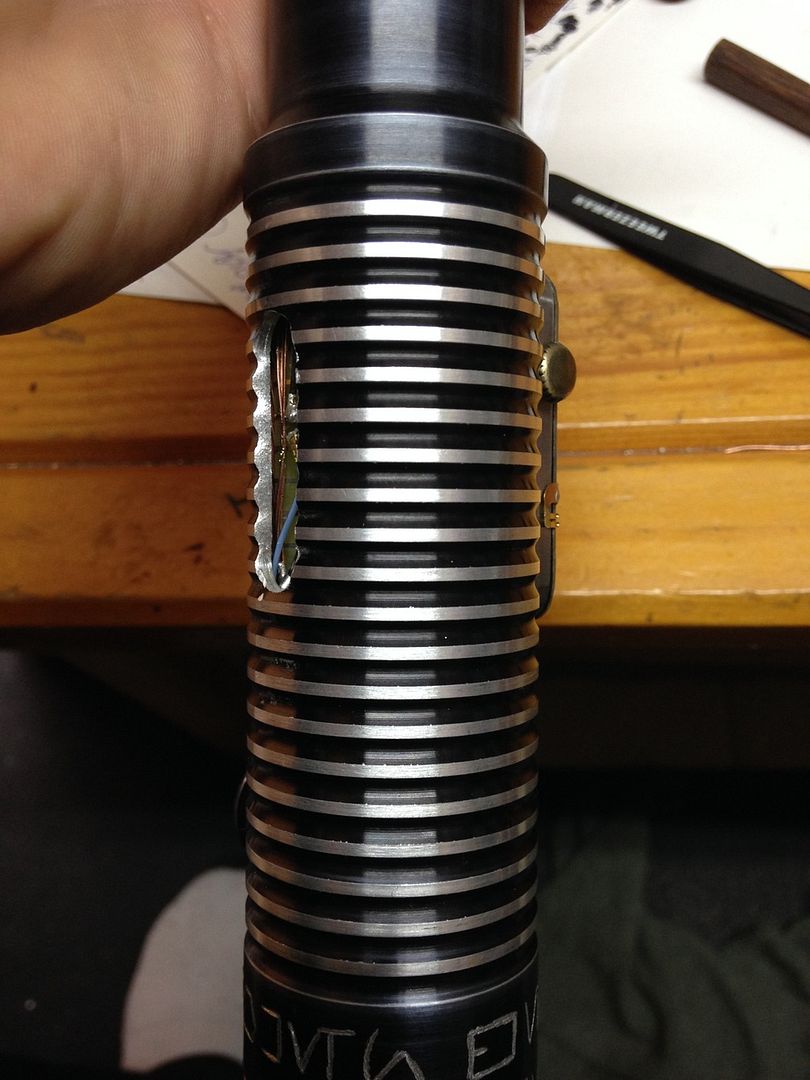

O no worries Greg, that box isn't going anywhere lol!  I'm quite fond of it Smiley.  This is on the exact opposite side of the saber as the activation box.  It's pretty much the same size and shape as the base of the act box, more or less located in same area of grip section, and they both have that circuit card pattern so there's a sort of symmetry to the grip section now... Maybe symmetry not right word, but it looks nice and balanced now Smiley.  At work ATM so can't throw up a pic, but I will in morning when get home for sure- I'll still be working on these pieces some more anyway.  The wire that runs outta the act box will end up going down into this window.

Added a tiny bit more detail to circuit card in cut away this morning- gold solder tab, to which I soldered a little gold capped/ plug, pcb type wire:
Here's that view I promised for Greg, so can see relative positions of box and cut away:
If you look close, in both pics you can just start to see some of the copper wire around the edges of bank.

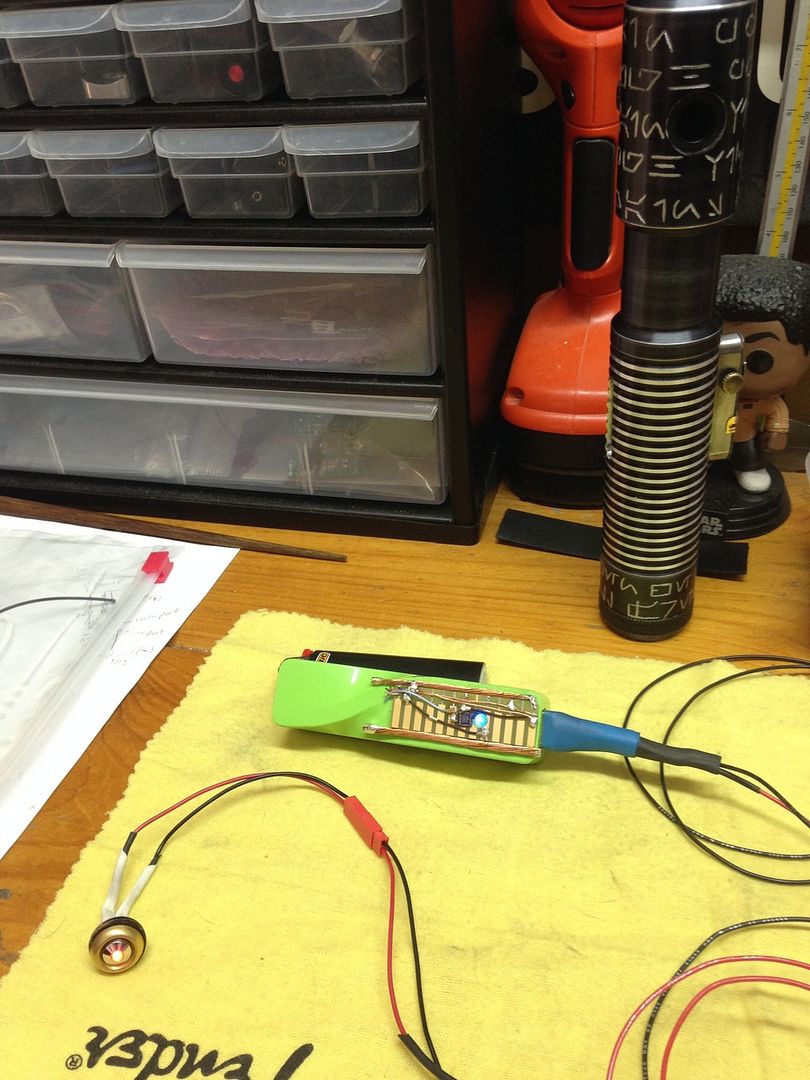

« Reply #74 on: April 02, 2016, 06:52:22 PM »
Ok, here's a better look at it lol- again, sorry about the vid - I was so tired i could barely even think, let alone string a sentence together.
Those other ends are where my switch and led come in.  Put quick connects on accent and port for convenience during installing/ testing etc., except at the USB because it's already pretty convenient popping in and out as is.  I don't have a 2.1mm knurled kill key yet so just using an empty/ unhooked charger plug for time being.  Keep you posted, MTFBWY Smiley
